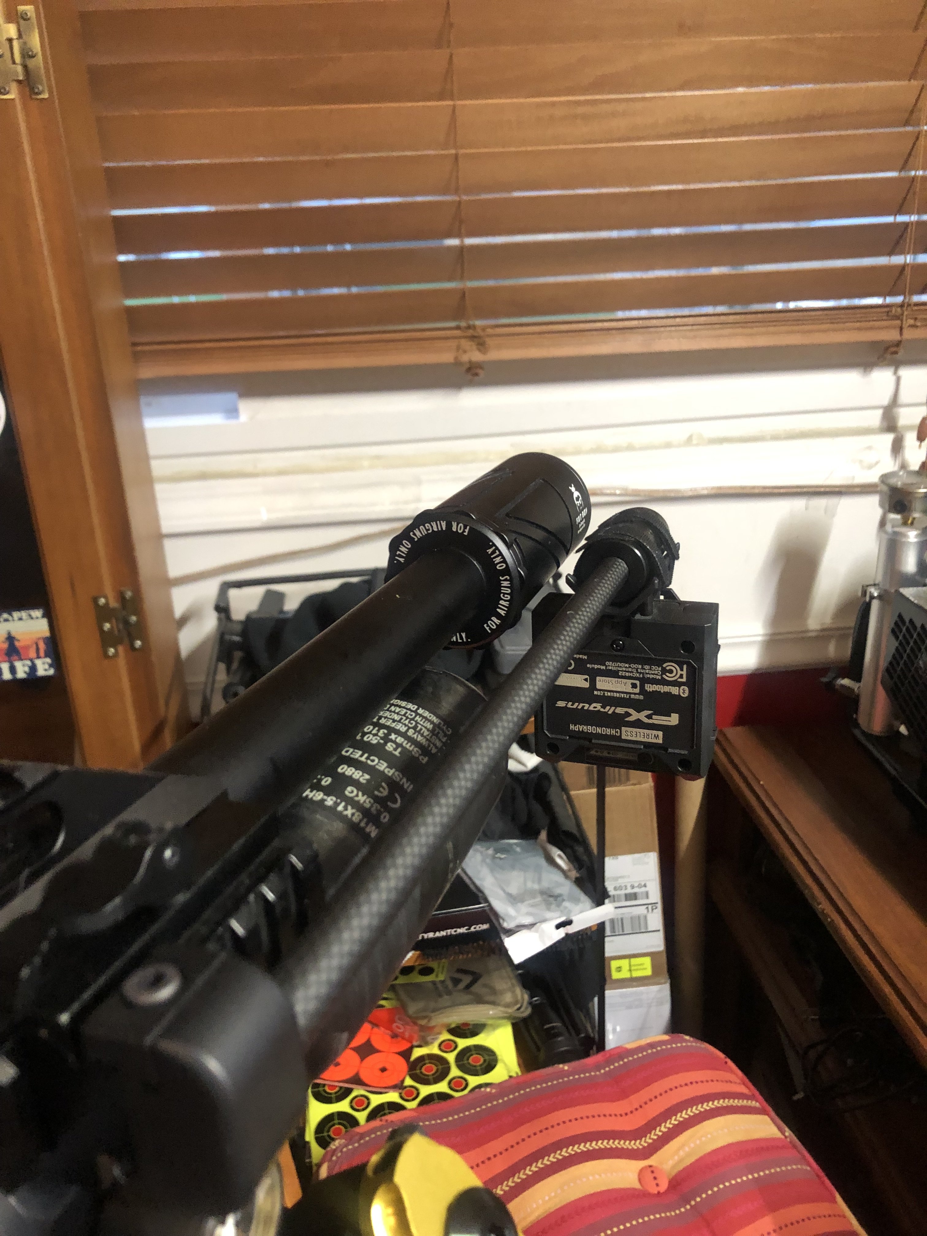

I initially had problems with the FX Pocket Chrono with my M3 also. Tried different settings and returns and it wouldn't read sometimes. A real pain. I now set it about an inch under the barrel and where the muzzle and moderator come together and get good consistent readings. It rarely misses a shot now. I use 20% minimum return setting after trying a bunch.

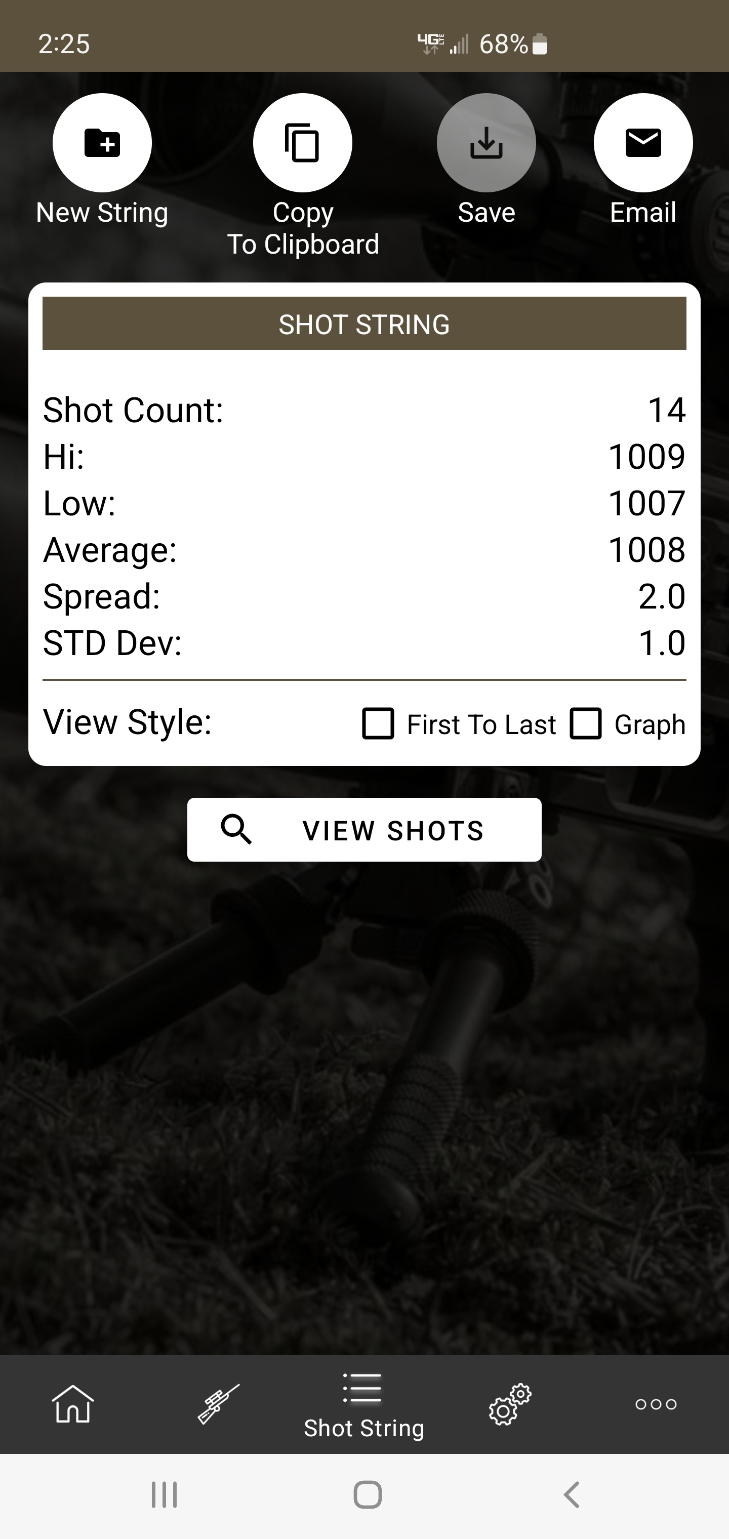

A buddy uses a pricier traditional style optical chrono and says the FX doesn't read velocities as accurately. That may be true, but as long as I get some reading I can compare it with other readings to find out what the rifle likes and what is consistent then I feel it's useful. I've also gotten five shot strings with all the same velocity and others with 25 FPS variations so I think it's helping find the way forward. It also lets me know when I've gotten all the velocity available from a particular regulator setting no matter if the hammer spring tension goes up.
