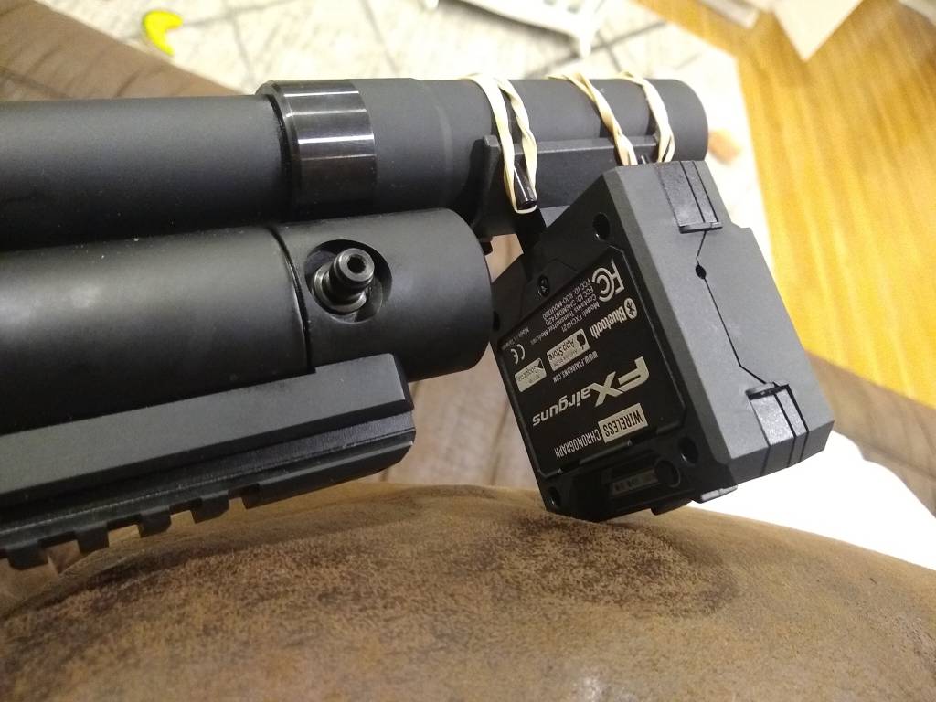

Like mine a lot. Immediately put some velcro straps on it to use instead of rubber bands.

I like it a lot hanging from the barrel. Seems to work great since they came up with the barrel attachment. I’ve always found it to read best when at the end of the barrel on all my rifles. When I put it back, it seems to miss more. It fits in my range bag easily and I can aim any direction and it is always in the right place. It does eat batteries pretty quickly though.
I don’t like the POA shift with it on the barrel, but I know what to expect so I adjust for it. I am actually working on something like Ernest has in one of videos that attaches it to a rod along the side of the barrel, by using pic rails. The old bottle attachment rod worked fairly well, but only with certain rifles, due to the length differences. The barrel attachment makes it work great with any rifle.
