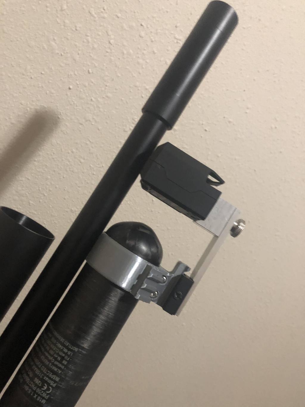

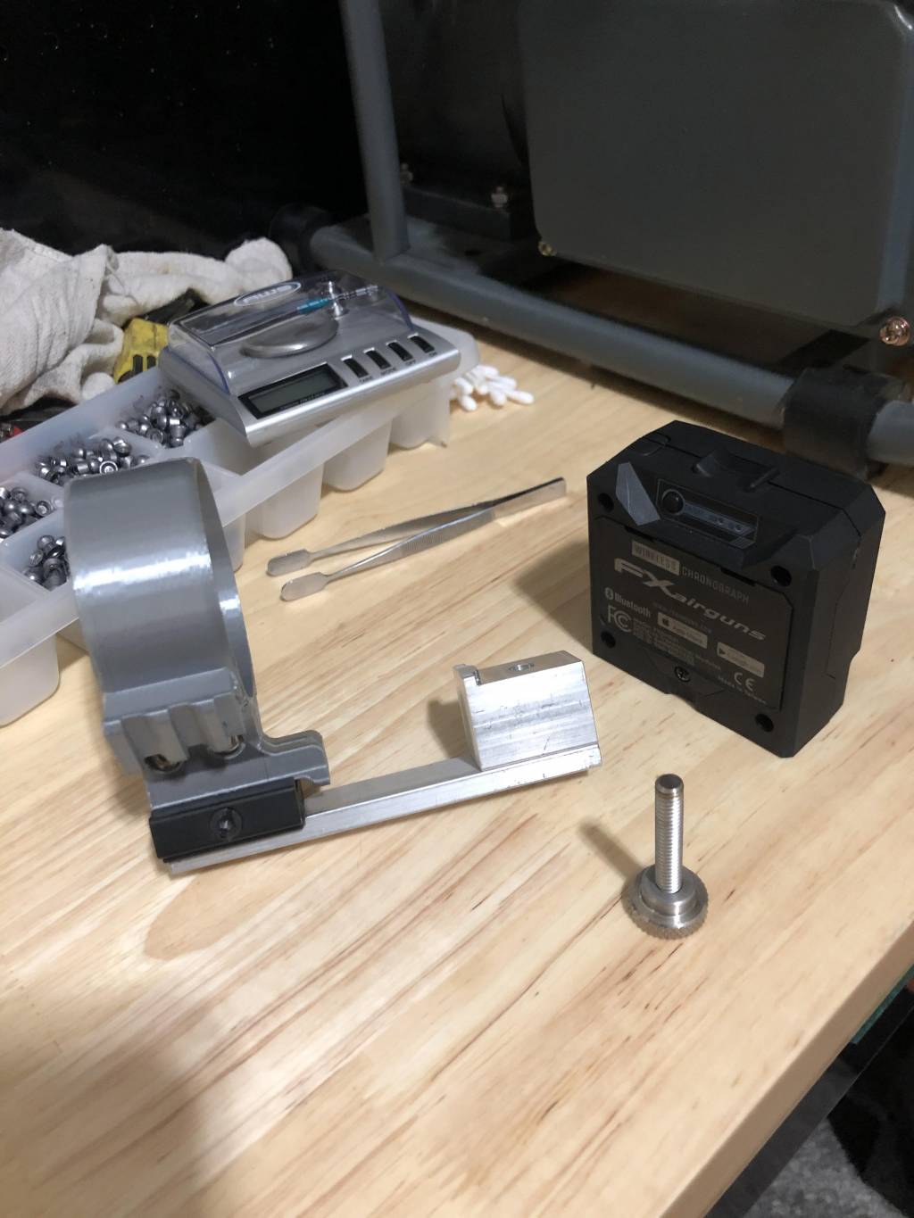

I made this bottle mount and it works fantastic. I have the 3D printed bottle clamp sized so it just slides on and off the bottle. No wrenches needed.
