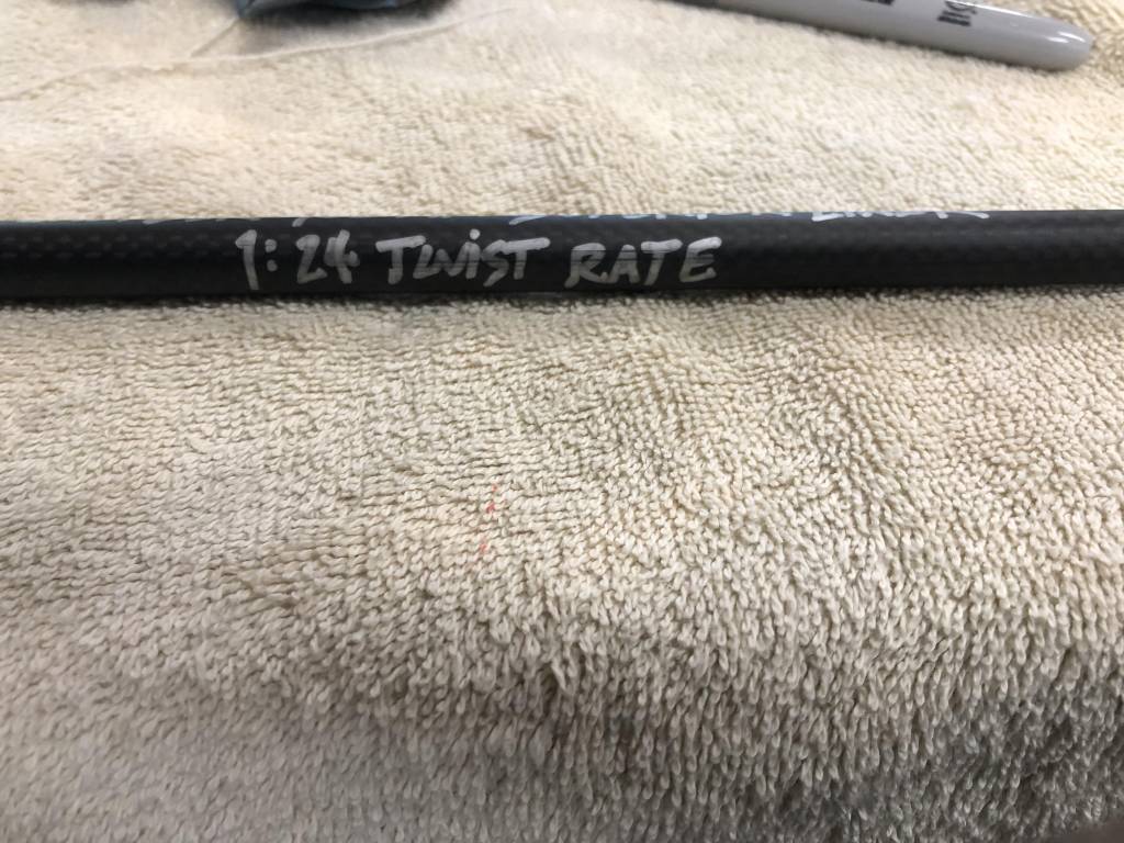

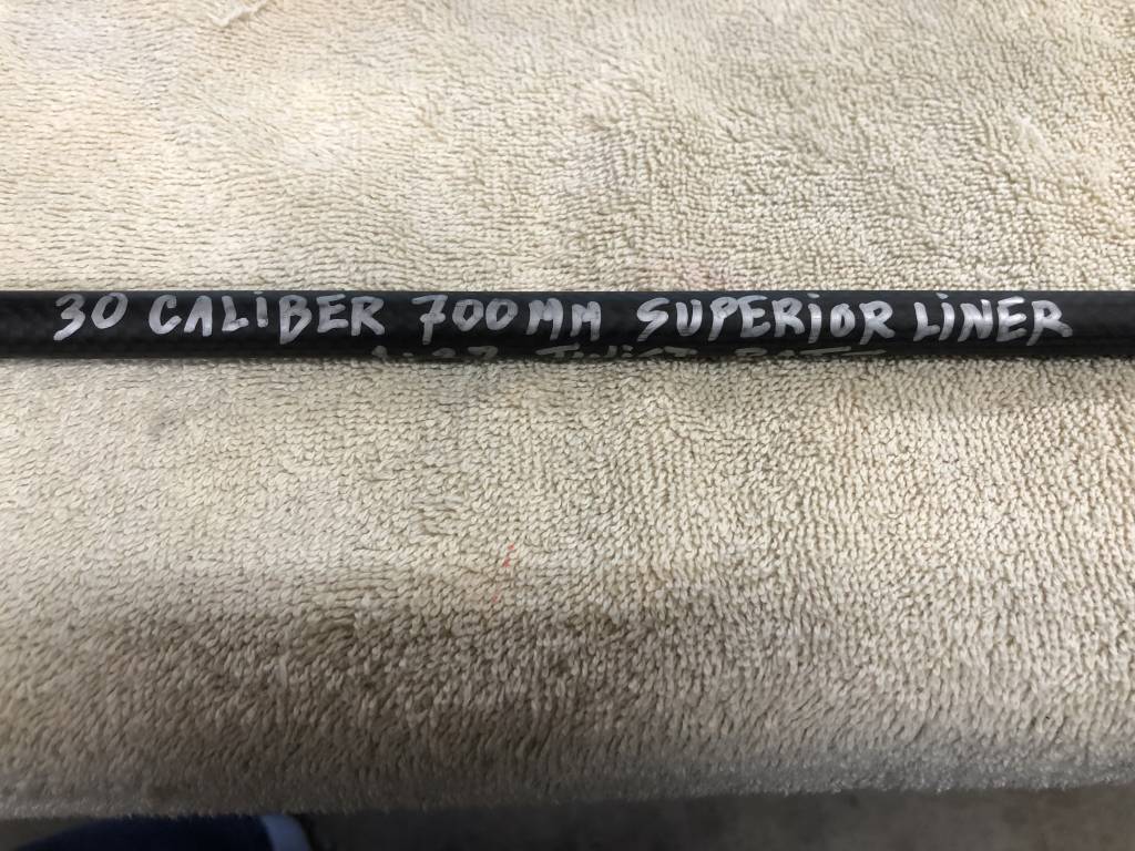

Every liner I get my hands on gets a cf sleeve epoxied on. It’s shown very slight(if any) improvement on already accurate liner, it has shown some(not great, but good for me)improvement on a so so liner. Perfect example is a 22 cal liner I’m dealing with. It showed potential. The cf liner sleeve made improvements to it but not great, but I’m ok with it cause I know part of getting good accuracy comes also from your guns tune and how you care for the barrel. Ammo choices also aid in the accuracy dept.
But for sure the three main reasons all my liners get sleeved are 1. More ridged of a liner with an epoxied sleeve, 2. Way better to center the liner within the barrel vs the factory o rings, and 3. At anytime I could slide my liner out and know what’s in the gun as it’s easier to label the liner with the sleeve, as shown

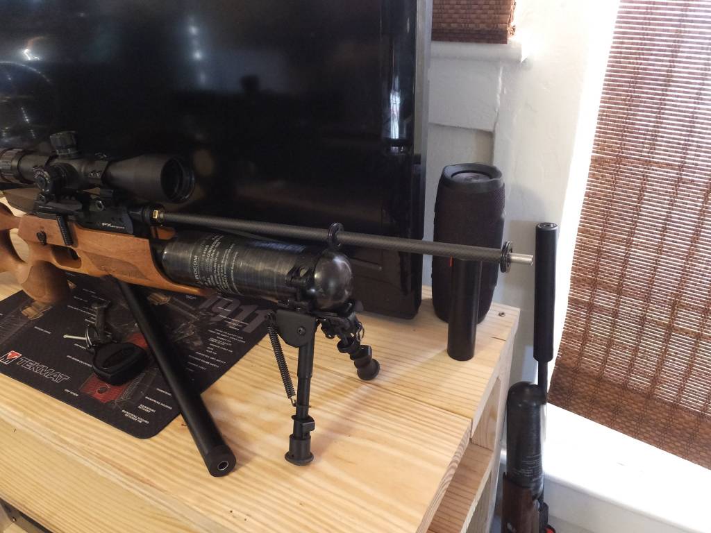

I did not see any improvement putting one on my Maverick barrel, but then again that rifle always fight me so far.
I have now put in a 700 mm barrel in hope that will work.
Mind you, the CF sleeve i got, fit the barrel just fine ( light suction fit ), but the fit in the barrel pipe are extremely sloppy, when the weather get better i will paint the CF sleeve on the outside so it get a better fit in the barrel pipe.
PS: i Have also ordered CF pipe to go on the outside of my barrel pipe taking it from the 14 mm OD to the 28 MM OD the shroud are, this should give me the worlds stiffest FX barrel.
