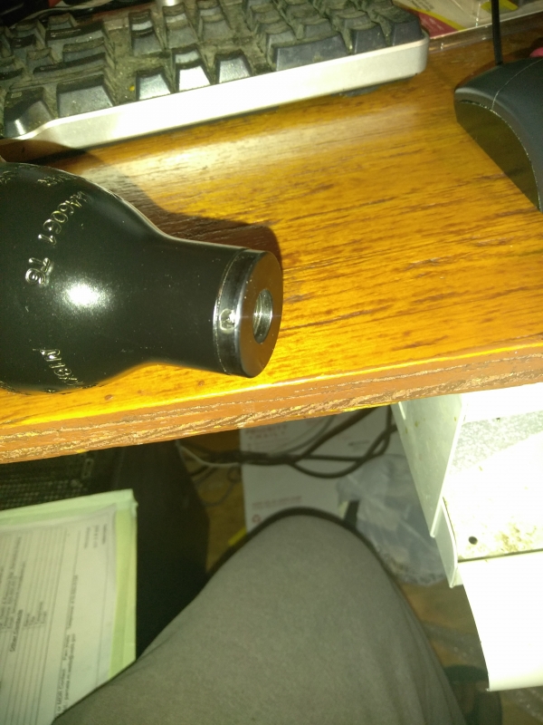

Yes, you will need this tool but its still NOT easy to remove this kind of valve because you have to find a way to hold the bottle in place.
a big vice with soft jaws (usually not available and small ones at home dont work or you will make a dent in it)
you can tie it down with straps between two 2x4 with a layer of sandpaper between. that causes MUCH friction!
If the new valve is not cheap, here what I did to get those AirArms S200 cylinders apart. Anyone who has tried knows how tight they are. Get a Pipe repair clamp that will fit around your bottle. These have a rubber liner used to temporarily seal a hole in a pipe. Here is one that should be close to your bottle
https://www.acehardware.com/departments/plumbing/parts-and-repair/pipe-hangers-and-straps/41838?x429=true&utm_source=google&utm_medium=cpc&gclid=CjwKCAjwx7DeBRBJEiwA9MeX_FxswrO7MyW62wg4KoM1CveXgq7tTBgjGq95vGmjRg4KTDeFoLZ_4BoCG50QAvD_BwE
You clamp this on the bottle without marring and then clamp this into your vice.
Then get a split tubing hanger that will fit the valve. My AA had 2 holes so I drilled and tapped a 2nd hole across from the one already there.
https://www.homedepot.com/p/Oatey-1-in-Copper-Split-Ring-Tubing-Hanger-33559/301505466
I then had to use a 24" pipe wrench to turn the valve (18" wrench not enough torque)
