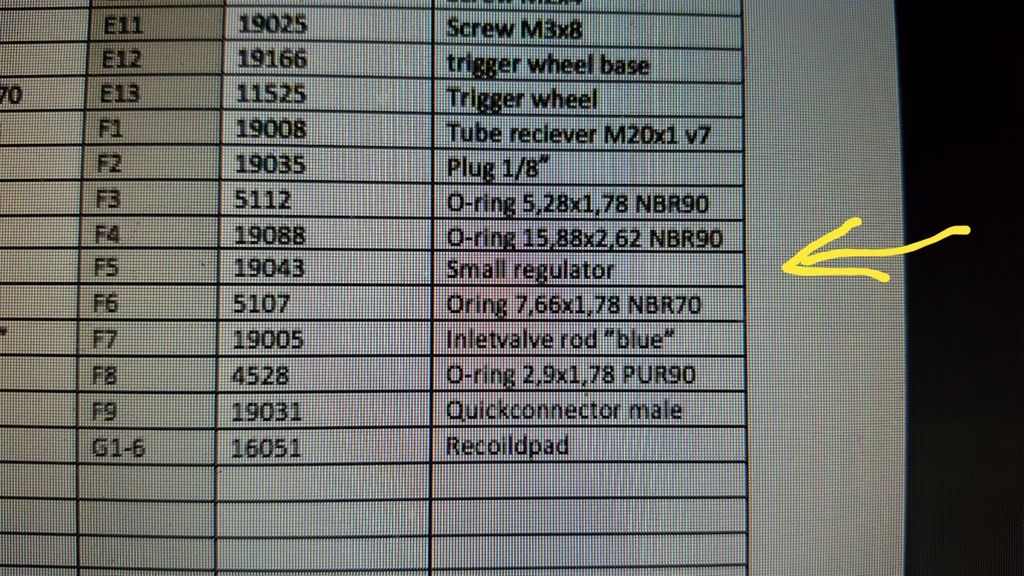

Hi all; were can I buy these partsART LIST:1-Manometer 25mm 1/8" (11505)2-Charging valve:O-ring (5107)Inlet valve rod (19005)O-ring (4528)Quick conector (19031)Thanks Juan
I'd call up Airguns of Arizona, if that's an option for you. I screwed up my gauge on my 400 recently and they were able to get me the right stuff quick! Tom

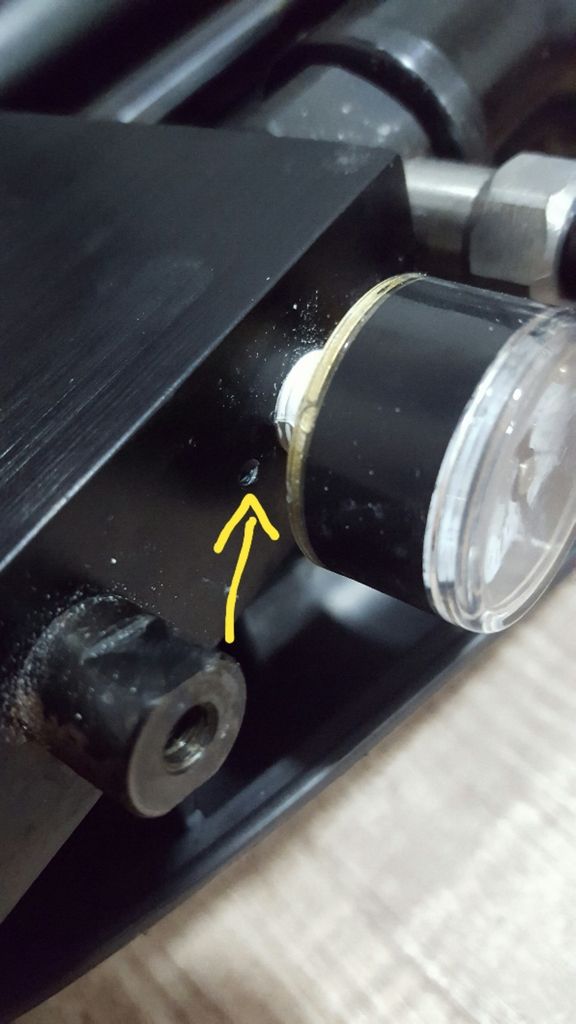

Thanks Tom, just got the parts I need from Airguns of Arizona. and replace the manometer and the feeler valve. Now it has a air leak thru a hole beside the gauge, do you know what cause it ?, what can I do to fix it ? Thanks Juan
Juan, is that hole your referring to below the gauge and drilled into the body of the receiver? If it is, that's the vent hole for the regulator and would indicate you have a O-ring leaking on the regulator. Jk
I hope that one of the 2 external oring are damaged. If not you will have to dismantle the reg to replace inner orings. It is quite easy (refer to ernest video on youtube).

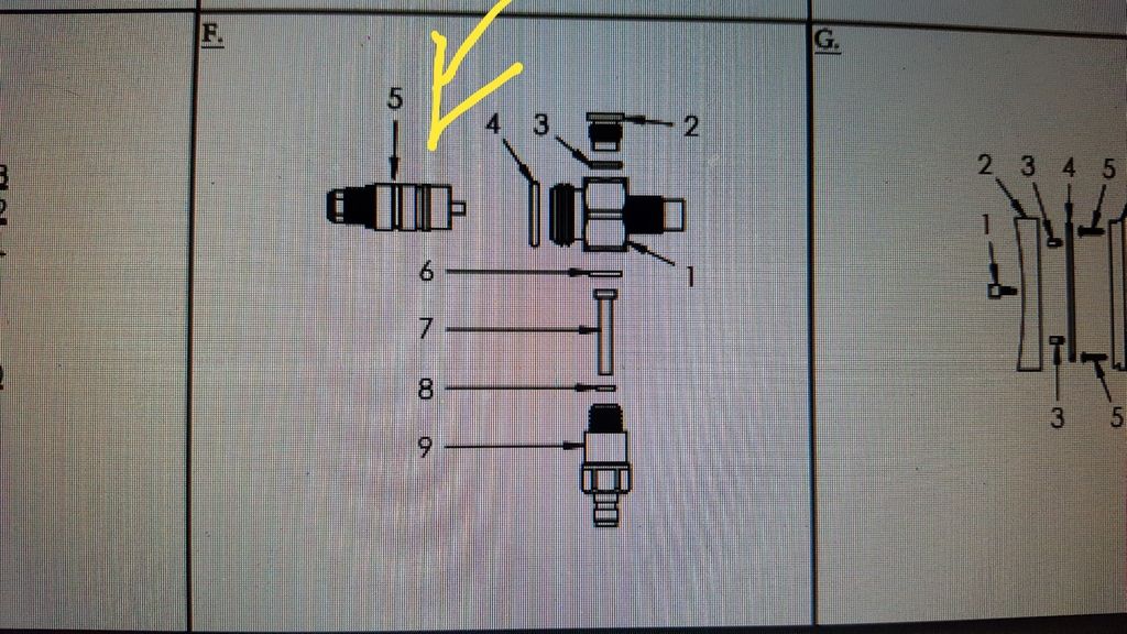

Thanks for all the inputs. Are this (show with the yellow arrow) the regulator of my FX Boss ? Also, can I remove my boss air bottle safety even if it has pressure ? Thanks
Juan, as far as I know you can remove the bottle safely, The FX400 and FX500 are capable anyway and that's why I'm assuming you can. You can unscrew it slowly until it starts bleeding air and watch the gauge go to zero. Even after you bleed the air off the gauge there may still be some pressure trapped behind the valve so cock the gun and fire it make sure. The picture you had is the regulator. It may just be one of the two outer O-rings leaking. I'd replace them first and reinstall the regulator and see if that doesn't fix the leak. If you do have to disassemble the regulator get some good measurement of it before you take it apart. A digital mic works well. Here is a link to Ernest Rowes website that has lots of good information to help you out. Jimmy http://ernestrowe.com/wildcat
