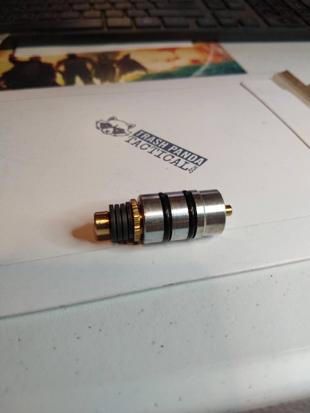

Also, my factory reg is just fine. I kinda remember someone on the forum saying that it can be tweeked to get higher pressures from it. I've checked the youtube videos for information, but my reg looks a little different and I dont' know if that is a concern
FX has either changed its reg design, or the Boss uses a different one than the Royale, because that one is definitely not like the one that came in my Royale. Looks like it may be designed to hold the stem by the knurled wheel while turning the adjustment end, or vice versa, can't tell from the photo.
That's what I'm trying to figure out. If you need better photos, I finally figured out how to upload pictures to the forum. All of the videos that I have found concerning the FX Boss factory reg have one with a lock nut - mine doesn't. I don't know how much of a difference that makes.
To adjust the factory reg, just hold the center stem stationary whole turning the adjusting nut. Turn it in for a higher setting, but go slow, no more than a quarter turn, and test. Given your mods, I have no idea of an appropriate reg set point, or whether the FX reg will accomplish it.
