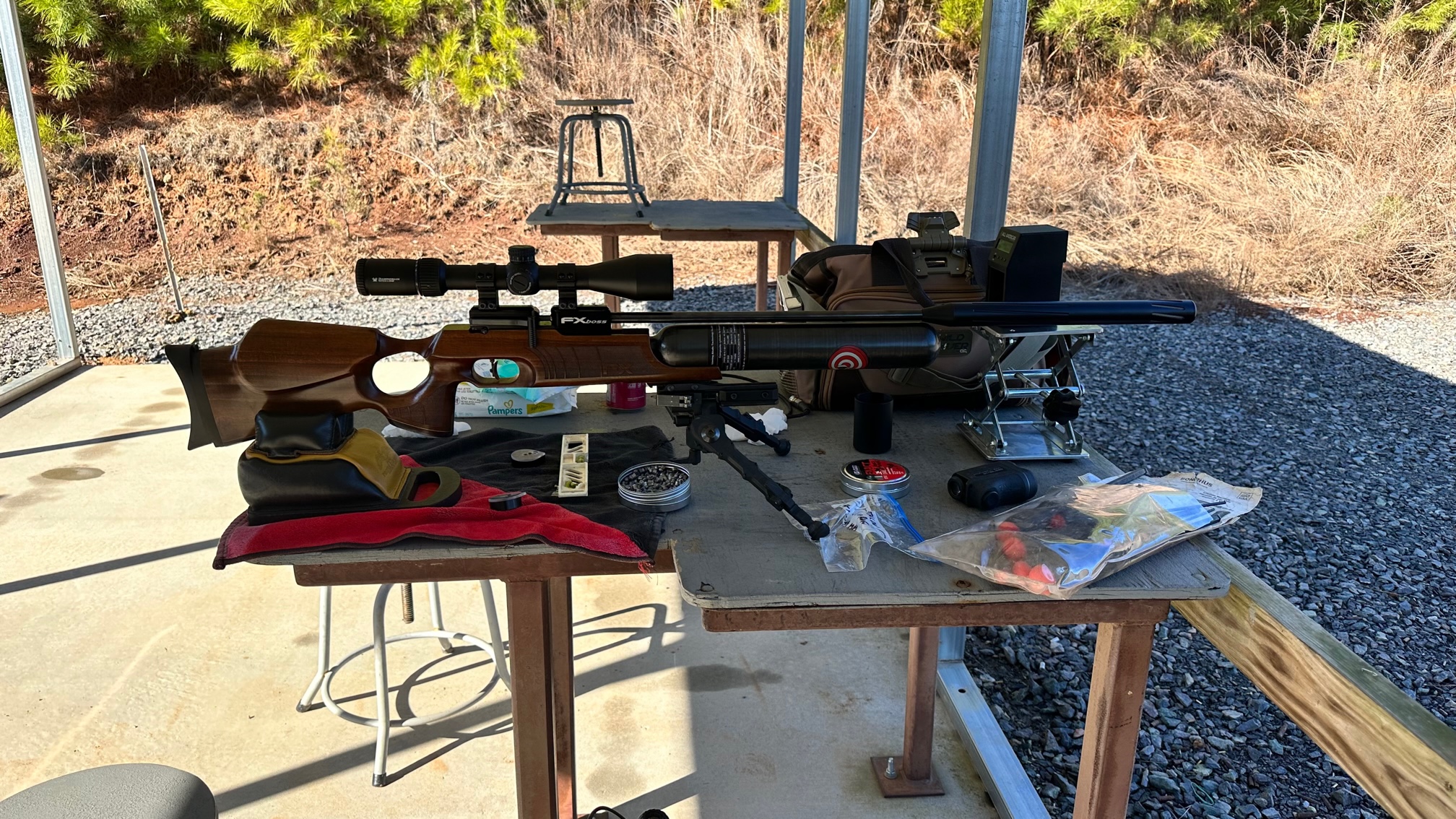

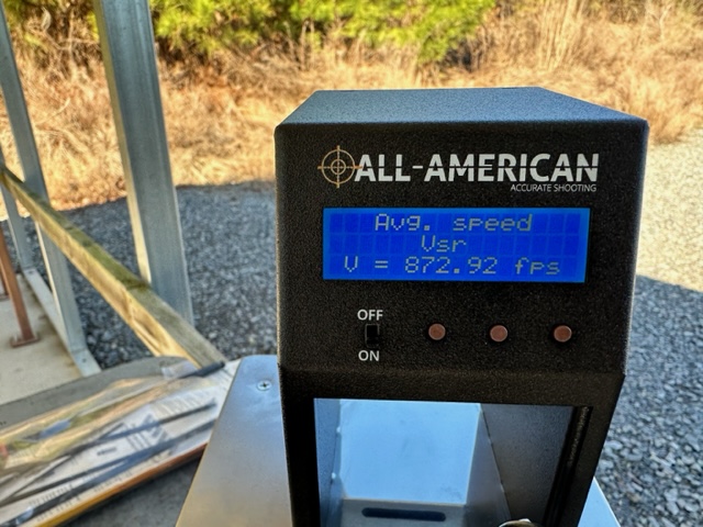

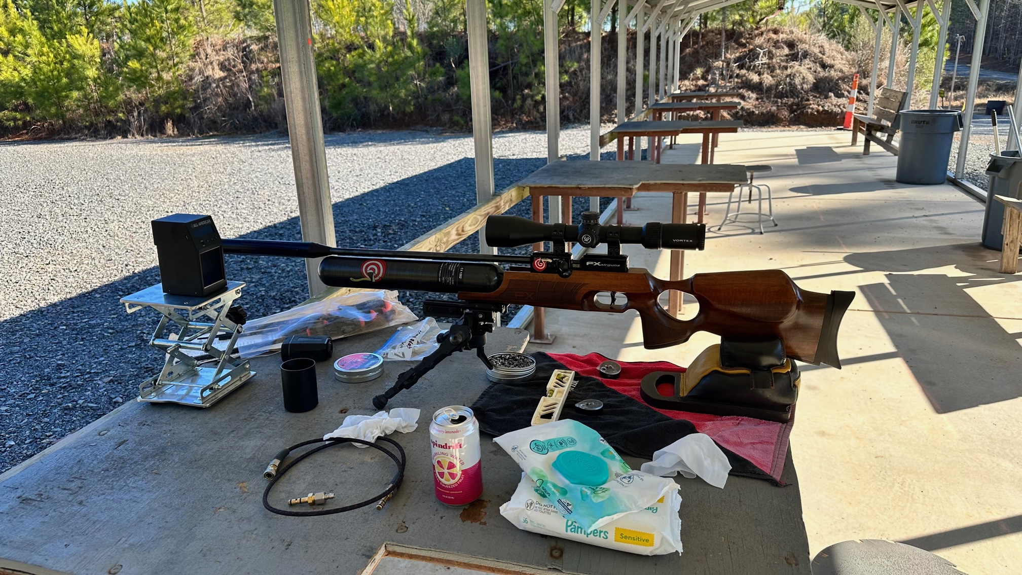

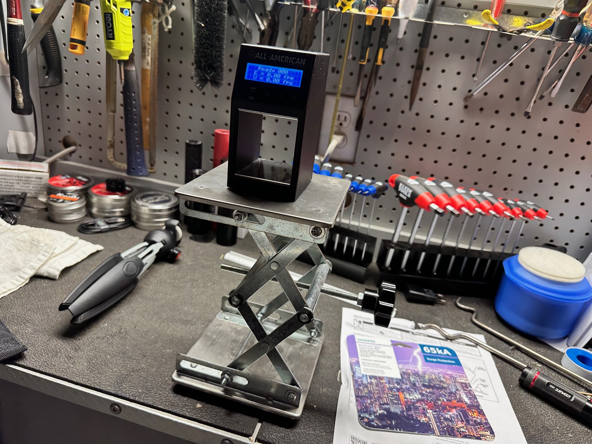

Today, I just shot at 50 yards because I wanted to Chrony the BOSS and just shoot 5-shot groups. It was a light wind day, but at times it would get to 4-6 mph. I just purchased a new Air Chrony MK3, and I am delighted with the performance so far. Unfortunately, with the Huggett moderator ( see picture ) on the BOSS, I could not fit the Chrony on the bench -- too long. The Boss with the Huggett is a whopping 49" long with the Huggett. I did remove the Huggett and was able to then Chrono the Boss. My 8 shot magazine group with the Chrony was a ragged hole about 1/2" . 873 FPS average with ES=8. Exactly where Newman had it set with the tune.

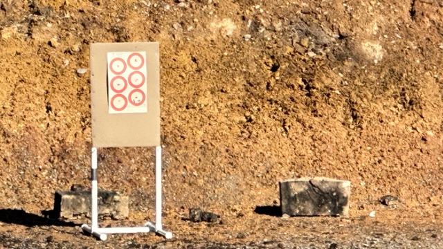

I shot about eight 5-shot groups at 50 yards with an average CTC of .51" The JSB 44.1G leaves big holes, so my target paper with cardboard backing did tear a bit making it difficult for precise measurements. I did all measurements with my Caliper and also measured just the cardboard holes to see how close I got to the paper measurements.

Went to the range today, and it was a bit windy. I set up some paper targets at 50 yards and was planning to shoot some 5-shot groups and then an N50 target
