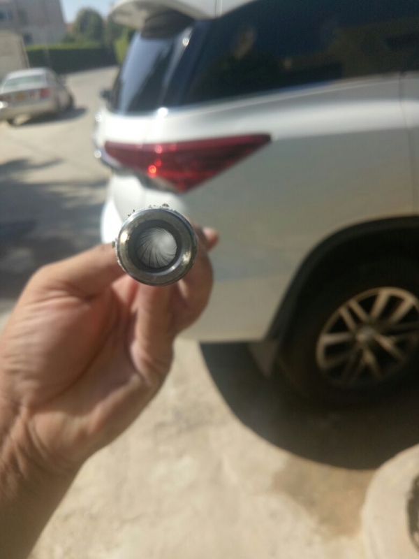

My friend's cricket .25 has a barrel problem. The choke area has some digs and bumps.
It's not accurate at all.

I checked choke on cricket and that was normal for cricket. Group was pellet on pellet if I managed gun movement. But shifting was unavoidable. However I set reg at 120 and could get better accuracy of it.
