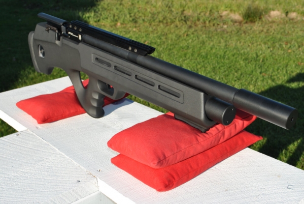

Fx Bobcat on JSB King Heavy mk 1
hy guys!
today i got out my Bobcat and shooting a Little bit, from the truing capability on strelok it says that it shoots the JSB Kings at around 1000 fps. Then i go to the King Heavy mk1 and they were only at around 738 fps fast.
so my question: are the mk2 a Little Bit smaller in diameter ore the same as the mk1s?
cause i could Not unterstand the big difference in fps between the Kings and King Heavy mk1s, normal the King heavy are around 80fps slower then de Kings or am i completely wrong?

crittahitta with Kings i mean the 25grains. No chronographing yet. I just Go with what the app Said, and its correct with the scope Setting at different distances. (25grains) Zeroing at 57meters and for 74 meters i have to Go 4.6 MOA up and it works. (34grains) Zeroing 47meters and for 74meters i have to Go 9.1 MOA up (34grains). So i really dont know Whats Up.

In the last few days i‘ve testet a lot and chronographed each shot string!
my Bobcat doesnt really like the King heavys, so i changed back to the 25 grain Kings an tuned it back to shoot at 910 fps.
and the best thing ever, accuracy was back , i‘ve shot a 10 Shot group from 81yards at .63“ctc.
I got 88 good shots with a high at 915 fps and low at 906 fps.
