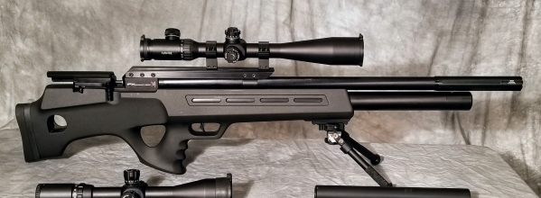

I bought this FX Bobcat last month from Beefbonks (Awesome seller!) Shot it, and it was very accrate, but I wanted a bit more at 100yrds. Not a fan of how the action seats on the stock allowing a lot of barrel and action movement, so I glass bedded the action and receiver up to the barrel shroud and kept the entire barrel/shroud free floating. Modified a DonnyFL Koi for 30 cal and its about done. I may play around with some differnt speeds, but at least I'm very happy with the starting point Ill be tweaking the speed from.

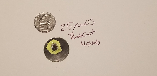

25 yards it boring, only took a couple shots

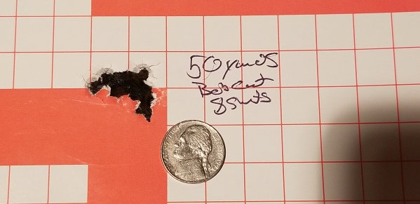

50 yards it shines (-1.75 MOA elevation drop)

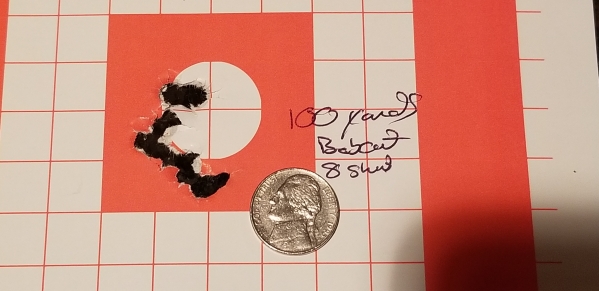

100 yards much tighter after glass bedding (-17.25 MOA elevation drop)

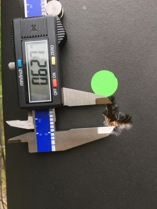

Nice looking setup you have there, I recently purchased the exact rifle in exact caliber about a month ago from AOA. I’ve tested and tuned the gun since ive had it and came up with some great results. I did notice some fluctuations on my regulator though...That being said, I purchased a Huma regulator and received it Friday evening and installed it not long after. I started the regulator at 170 bar and shot over the chronograph several strings, the results were phenomenal around 920fps. For some reason, when I refilled the cylinder to max pressure I noticed the regulator gauge was reading 180bar. I was thinking that the gauge was malfunctioning so I shot another string, man was I wrong. The gun was putting out 950fps roughly 90fpe, I thought to myself no way could it be accurate at that speed. I was once again proved wrong, at 75yds a 9 shot group ctc was .627in. It’s going to take a lot for someone to persuade me that there’s another rifle at there that can do what this thing is doing. By the way the shots were made off of a bipod and sandbag in the rear.
