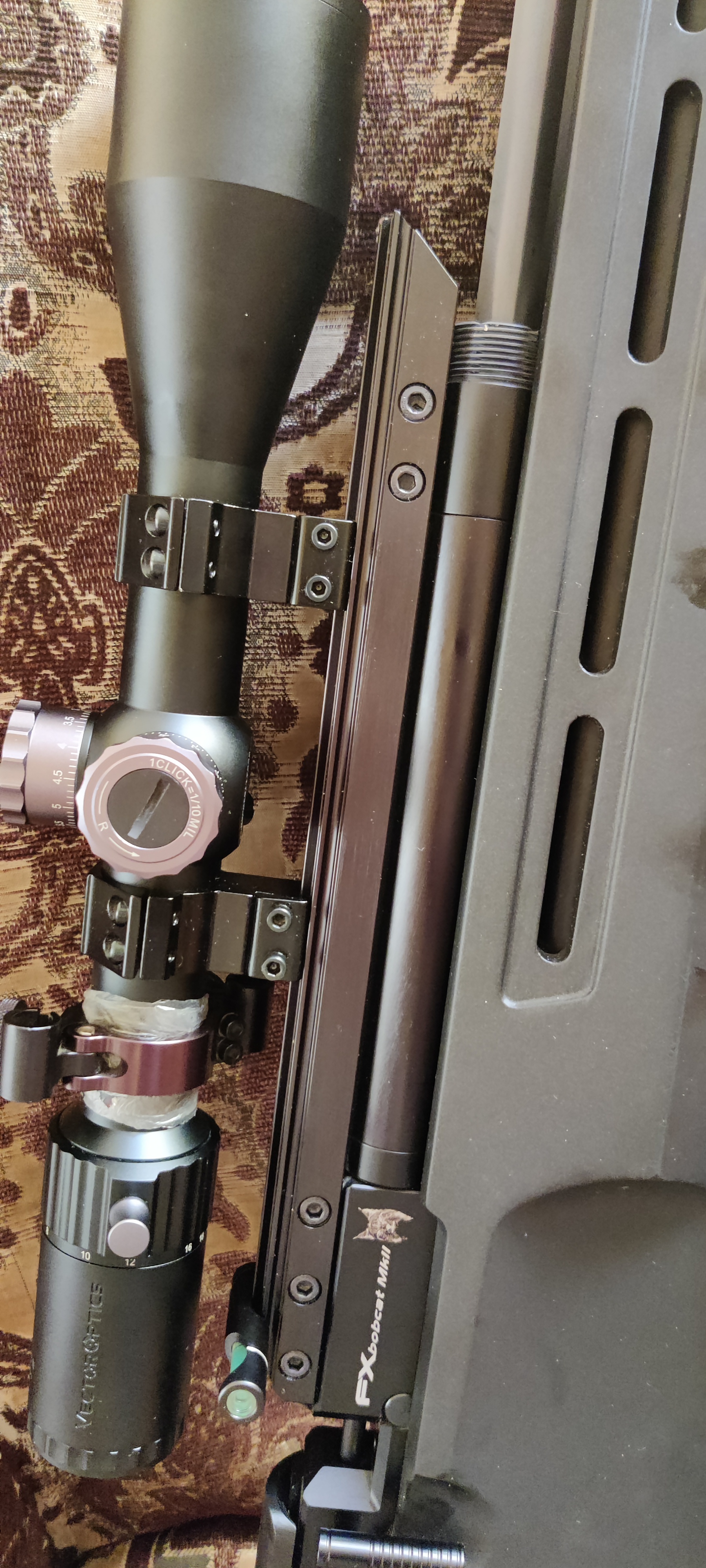

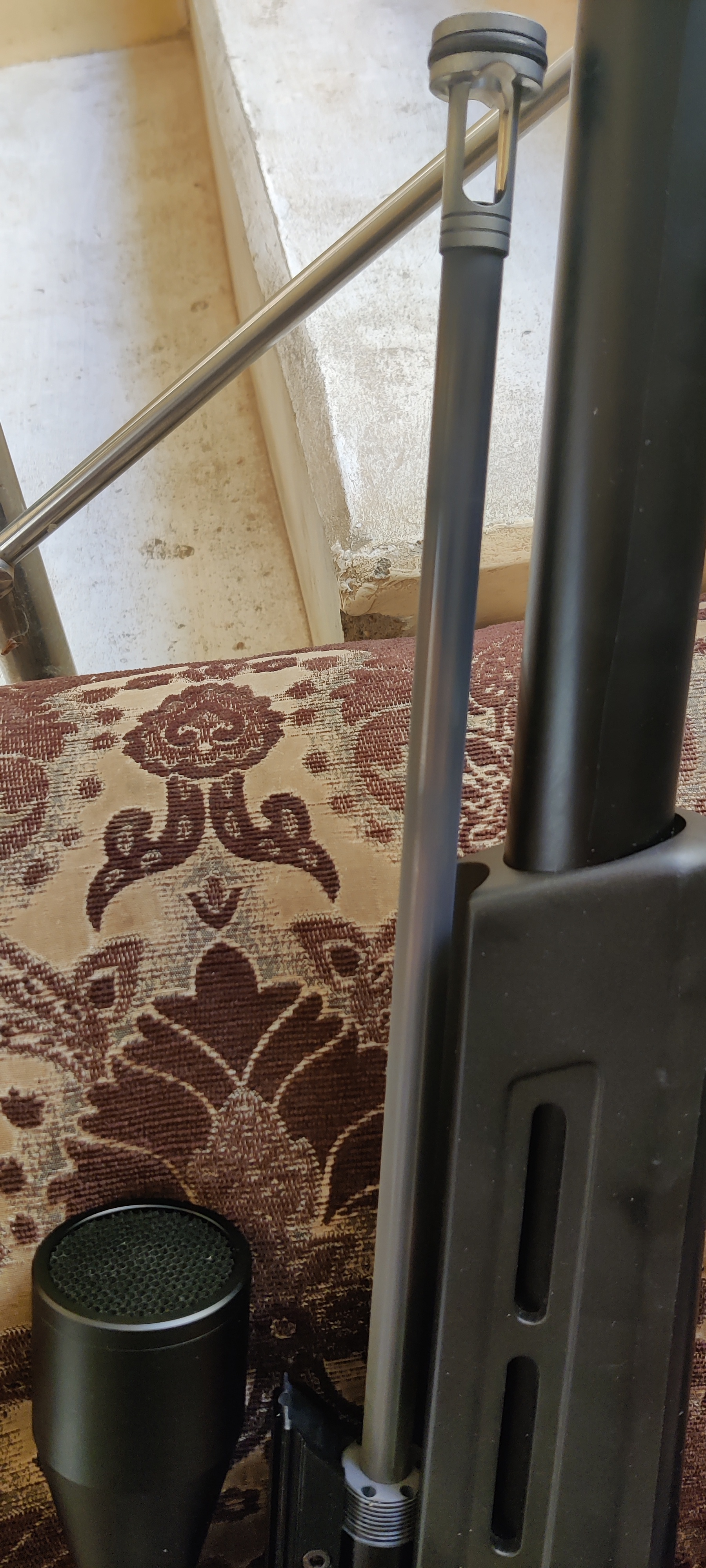

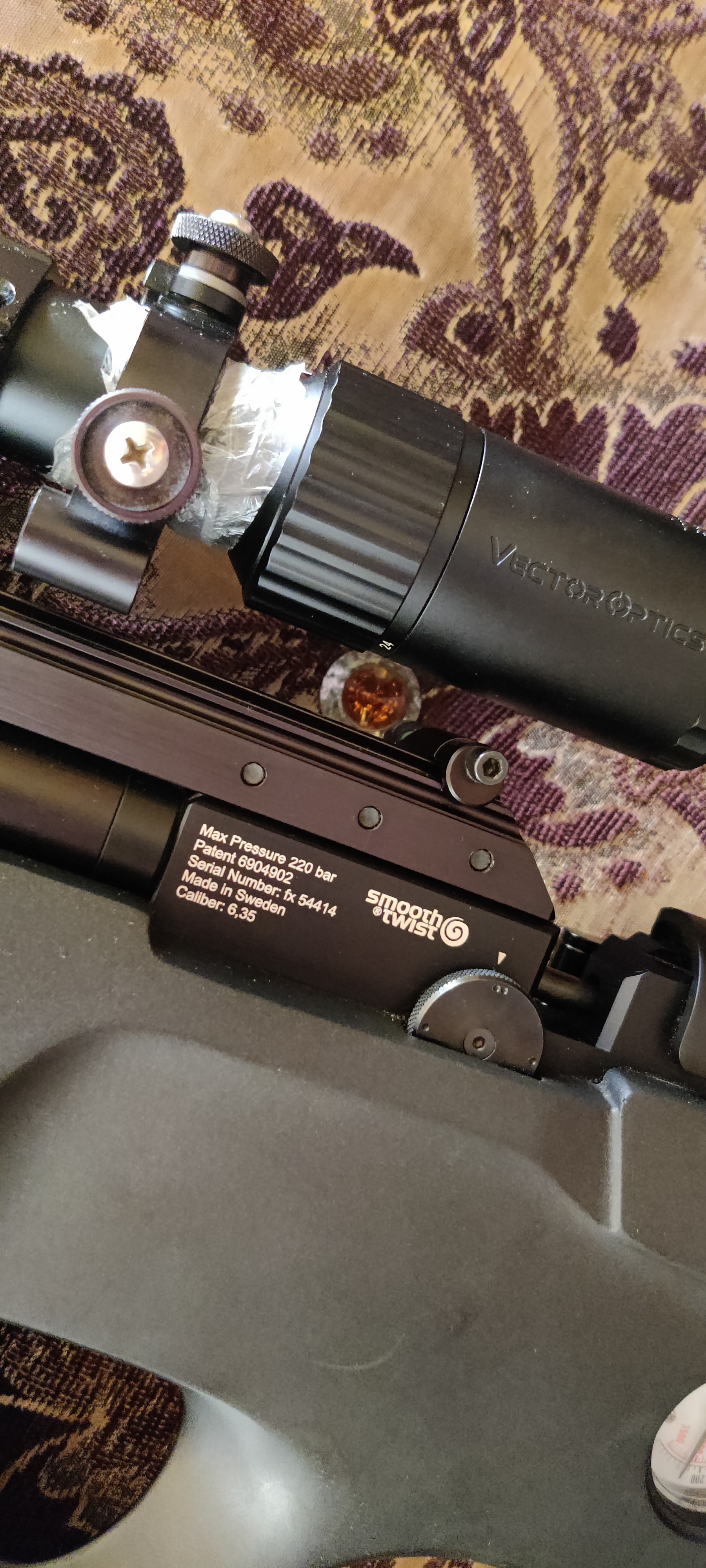

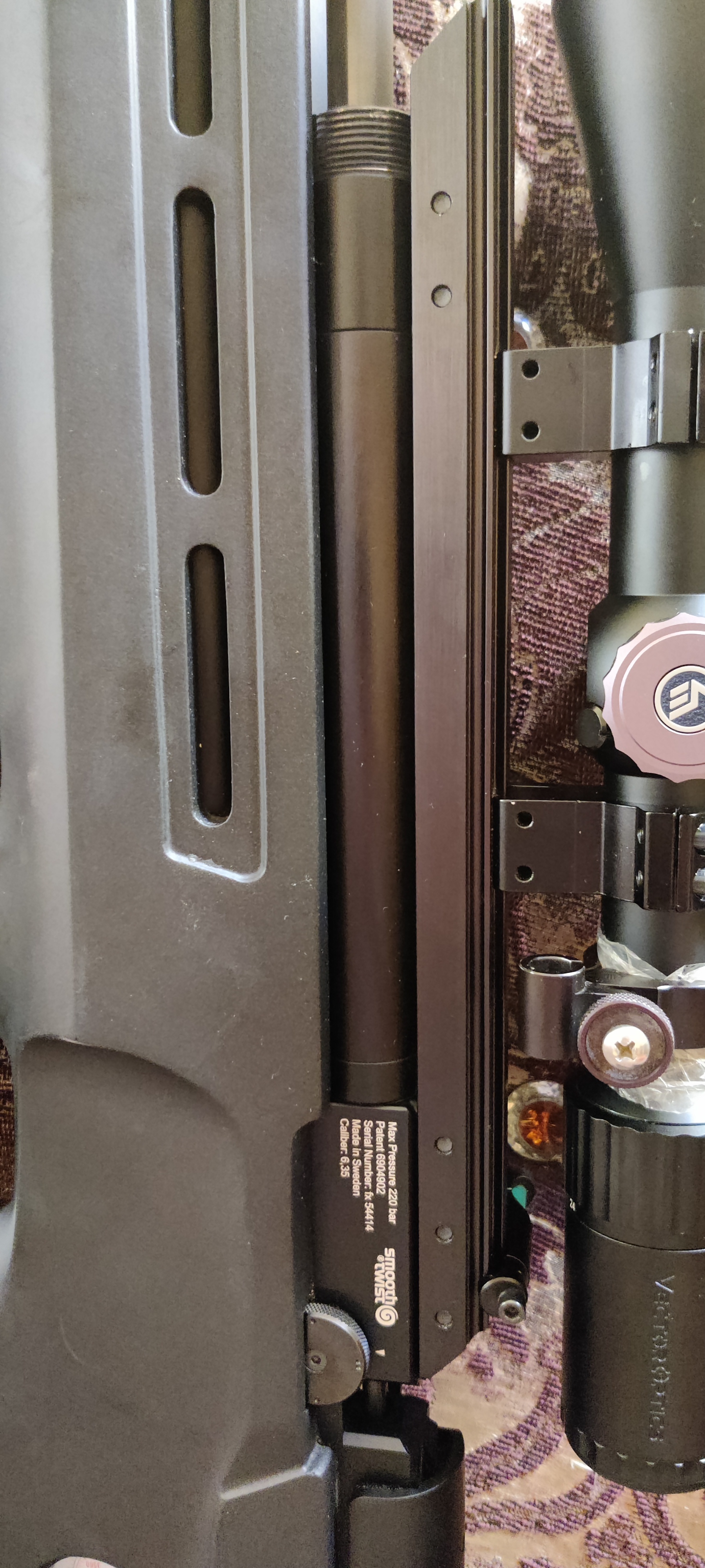

I don't know which barrel is but of course that is 600mm and i share some pics may you understand that barrel but i don't
Please guide wich barrel is mine
