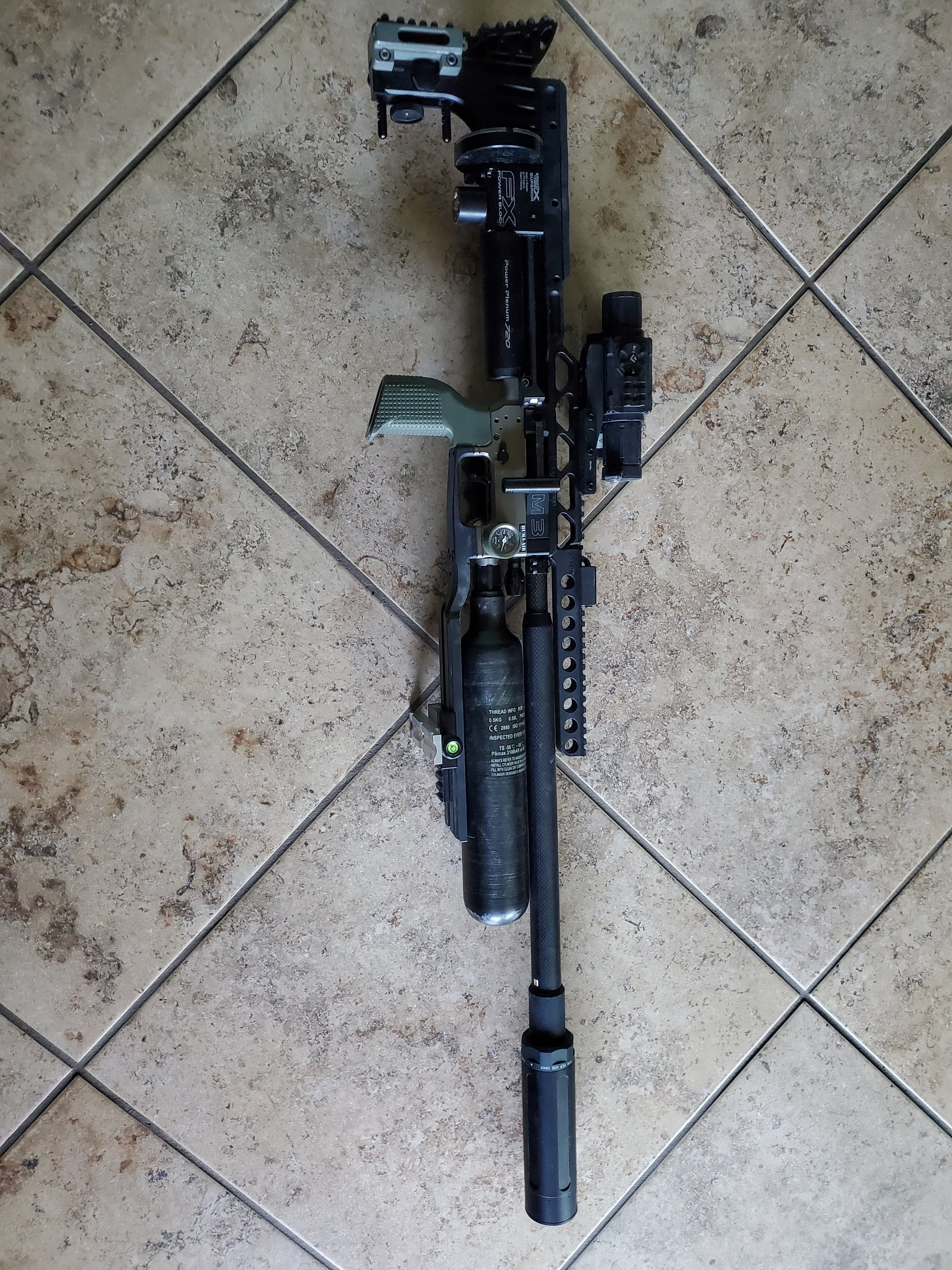

The tensioner block may not jive with the trigger block of the M4 iirc. I have one on my m3. I might suggest the carbon harmonic shroud . They look good but add length and weight, which wasn't for me on a 700mm at the time. The tensioner significantly changes the barrel harmonics tendencies too. If you're not doing high power slugs with an abnoxious shot sequence, I might steer people away from it unless they're suffering barrel whip.
Attached Pic was a remachined carbon shroud over carbon tensioner. The carbon shroud does a great job with noise absorption too. Mines an m3 and I know the tension kit fits that architecture.
Reactions: JaceSpace1369

Utah air or anywhere that sells fx accessories. They usually list it as "carbon harmonic tuning shroud" the harmonic tuner is useful, but it is to be adjusted in very tiny amounts in my experience.
Thank you about my m3. It's changed a little. Different moderator, no shroud, just the tensioner. I'm a stickler about it being quiet and at the time this is what it took to make the gun a click noise. It just wasn't balanced to my liking because I do a lot of odd position shooting away from the bench but still on a rest or bag of some type. It's very much personal preference.
