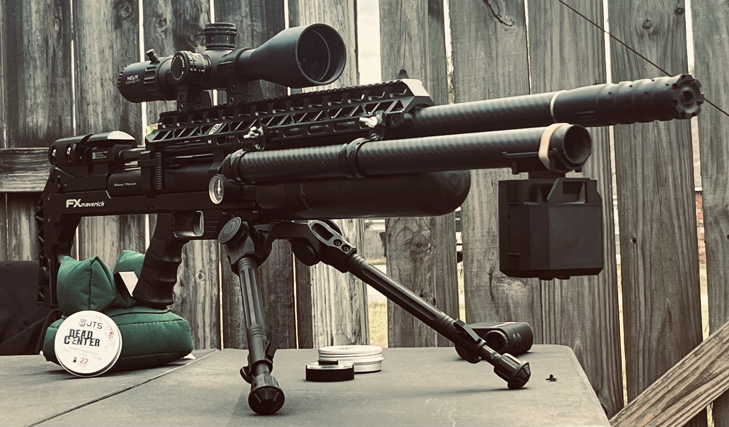

I have a quick question on fx barrels. I use a carbon fiber barrel sleeve on my Maverick and this actually goes to the impacts also. I was curious has anyone ever used a carbon fiber tube instead of all the original barrel kit?
Instead of the, which I’m guessing the steel threaded tube, switching it out for a carbon fiber that will capture the liner and thread the ends to mate with the transfer port and the jam/lock nut. Has anyone thought of this for stiffening the barrel and reduce vibrations?
My first thought is, the FX liner system places the liner in compression, which is the least favorable arrangement. So if one were to put effort toward fabricobbling a carbon fiber & liner assembly, it would be worthwhile to do it in such a way as to place the liner in tension.
I’m not thinking of tension more than more stiffer and less vibration. If that makes sense.
That's what he's telling you. Tension kills vibration while compression magnifies vibration. Just adding a carbon fiber tube helps a little, then adding tension helps a lot. Use the carbon fiber tube as a spacer between two threaded ends to create tension on the liner... or whatever arrangement that creates the same result.
Reactions: nervoustrig
I'm just saying I don't think the goals of "stiffer and less vibration" are served by taking the OEM FX approach of a threaded steel tube and jam nut, and adapting a carbon fiber tube to it. Whereas an arrangement that applies tension does benefit those two goals. But if applying tension is of no interest, you're probably better off simply bonding a CF tube (or 2 or 3) to the liner.
Oh I misread I’m sorry

I've taken two carbon fiber sleeves and cut the one down to have the jam nut tighten onto it instead of the barrel it helped
The problem with that is your cut down carbon fiber sleeve is far less rigid now that it's under compression. The best way to reach your goal is to fix the barrel to the receiver better by making the dimple deeper (FX) or whatever method you like and then put a larger diameter spacer between the receiver and a threaded area at the muzzle end so the compression goes onto the larger diameter spacer and tensions the barrel. Any compression on a barrel amplifies vibration while tension decreases it. I'm sure there are guys much smarter than me here that could explain it better.
