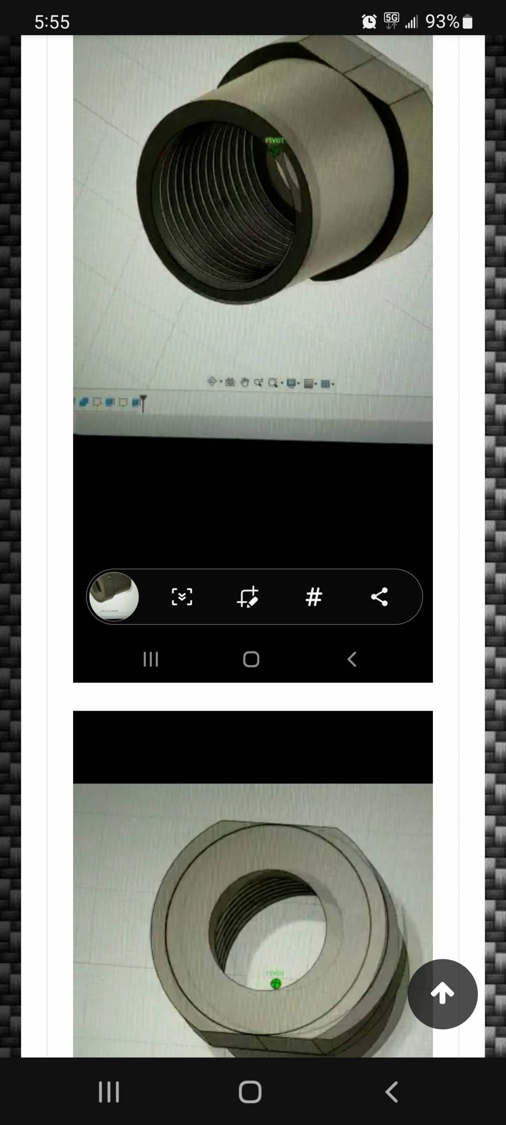

Contacted a local gunsmith that will try to make one. Does anyone have the exact dimensions of this part ?
This should get you close, I'd suggest making the hole that the pellet/slug goes through to be ever so slightly bigger than bore. So .225 for a .22 for example. The first version Sub12 made was bigger and it wasn't very accurate but once very close to bore size for the caliber that made it accurate.

I’ve found that my sub12 adapter with 600mm fx barrel shoots pretty good, plus it’s shrouded. I bet a 380mm fx would do great with shroud and small ldc.
+1
I have 600mm barrels in both .25 and .30 using the Sub-12 adapters. In both cases the accuracy has been simply superb. In my experience the FX barreled L2 was significantly more accurate than the original 350mm barrels that I had on the gun. Of course, I can’t tell the extent to which this is a function just of the FX barrel system, the longer 600mm vs 350mm barrels, or the change in velocity due to the longer barrels, or some combination of all opt these factors
