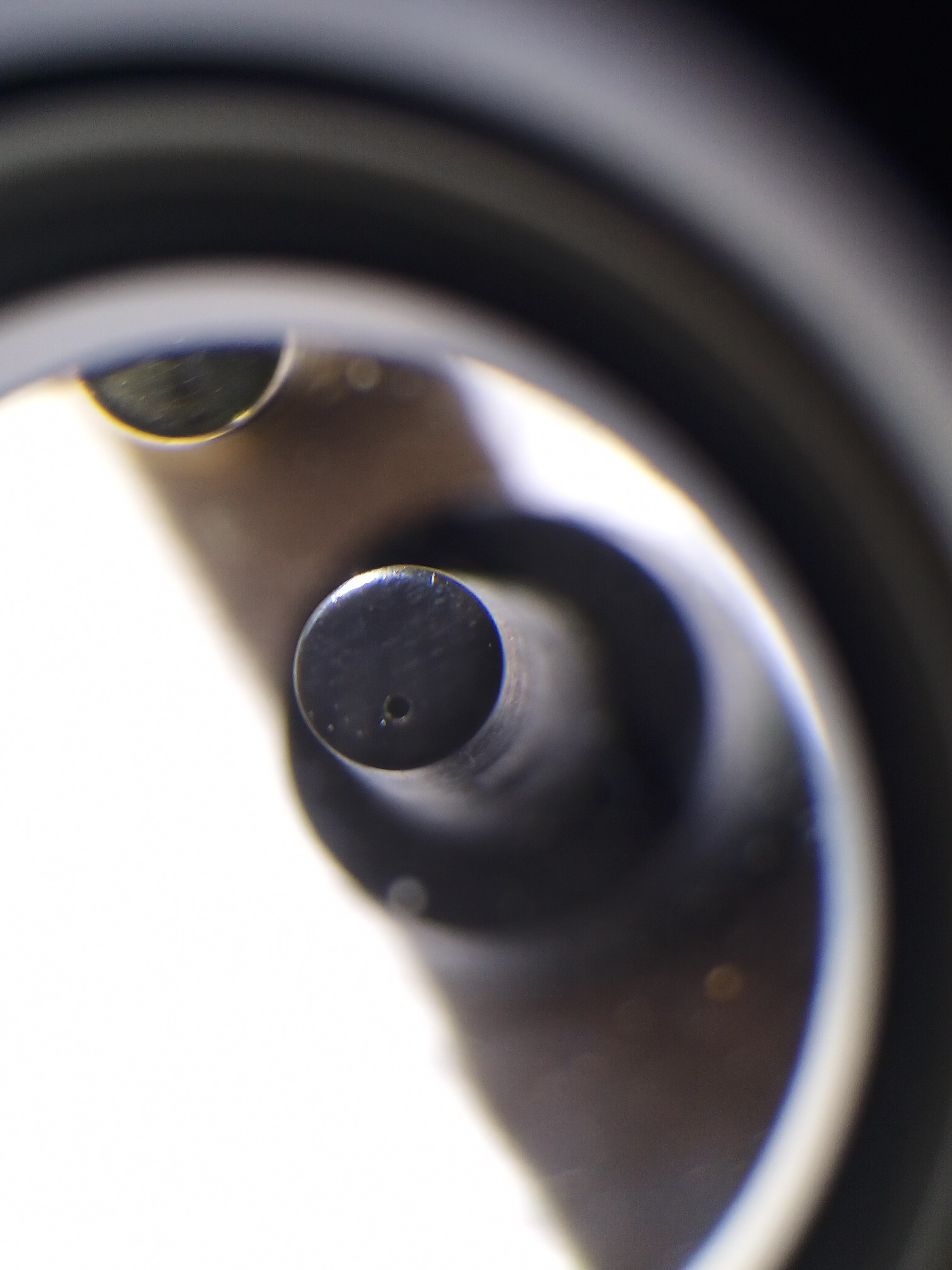

What bothers me is that i set those speeds at 25°Celsius wich corresponds to 170Bar but in a hot summer day the reg pressure goes to 160bar when temperatures are around 40°C. Again its not creep and reg is properly bedded. Tested through the afternoon when temperaure went progressively cool again and slowly back to 170bar. Kept shooting through as time passed and temp cooled.

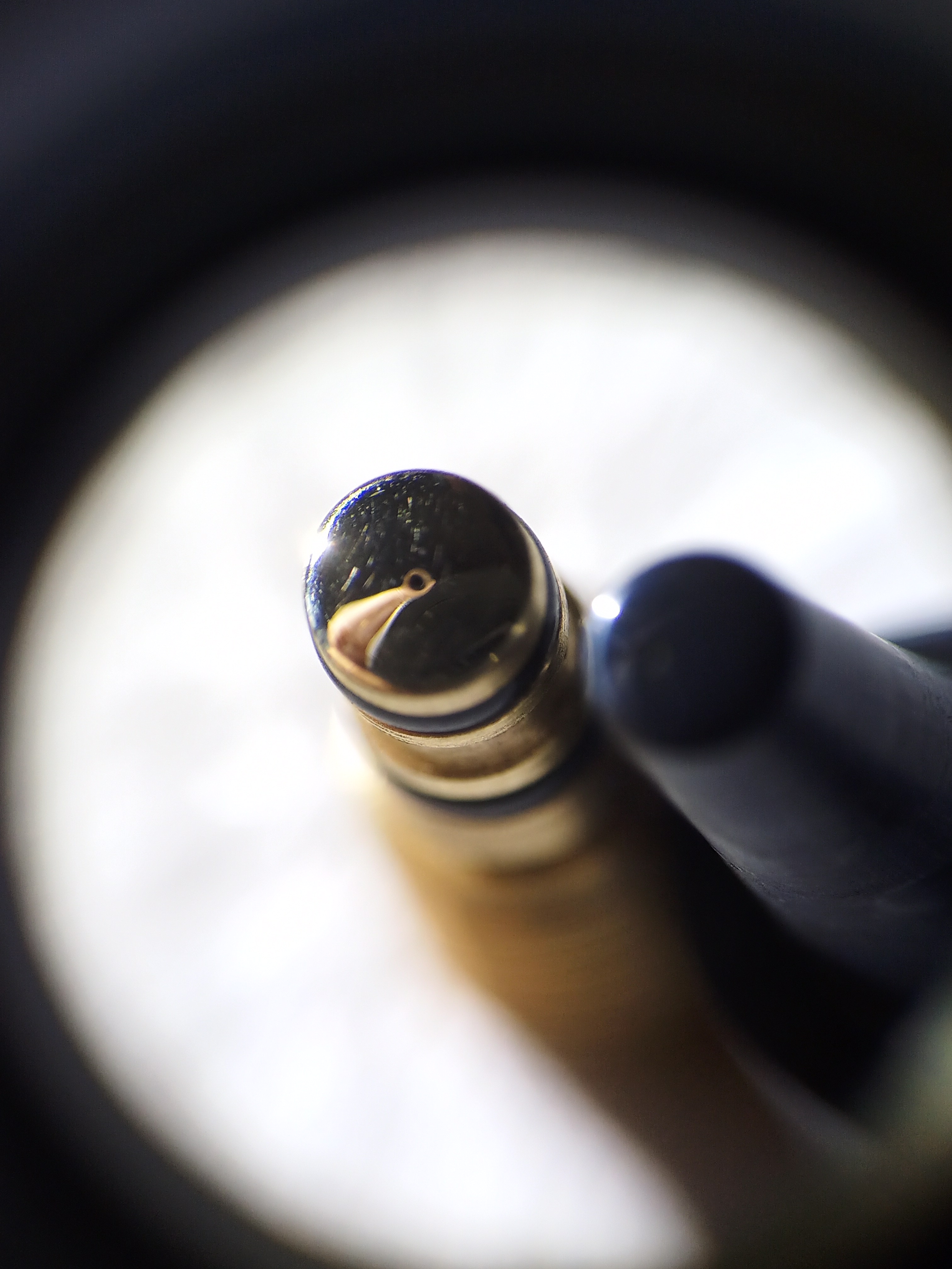

I rolled my head around and the only thing that makes sense in my mind is thermal expansion of regulator piston being about 5x more than the body and Belleville's. I have polished both ends of piston and screw and successfully eliminated creep.
That's why i am now noticing this.
I will make a reg piston out of aluminium later and compare results unless anyone can explain me what other phenomenon could cause this.
Yes Delrin has a significantly higher rate of expansion than the surrounding metal parts. When it elongates slightly at elevated temperature, the piston will reach the seat sooner and settle at a reduced pressure.
A new brass piston is becoming available according to some forum chatter so you may want to look into that.

Thanks man! 👍in fact i do recall some recent video showing some brass on new regs by fx just don't remember wich but i think it has something to do with rmac maybe by Giles from UK. If it is a simple replacement i might try it out.
