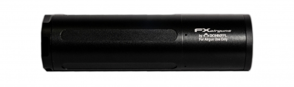

FX Airguns USA is also proud to announce their collaboration with renowned airgun moderator maker DonnyFL. Dealers in the US will have the option of offering the FX Dreamline with a custom made FX Airguns DonnyFL Moderator.

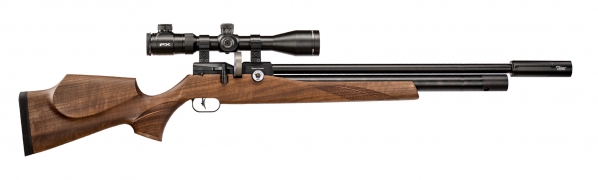

FX Dream-Classic
The FX Dream-Classic is the natural evolution of the FX Streamline. FX has taken the proven Streamline platform and added world class features that take it to the next level; bridging the gap to ries such as the FX Crown and FX Impact.
The Dream-Classic is full of adjustments and options to tailor your shooting experience. Adjust the ow of air using the valve adjustment knob. You can also adjust the hammer spring tension (accessed by removal of the stock) to match the projectile you are shooting as well as adjusting the AMP reg. With each Dreamline having the ground-breaking STX barrel system, shooters can swap barrel liners and calibers as well.
The Dream-Classic is available in Walnut, Black Pepper Laminate, and Synthetic stock options. These stocks are slightly different than the previous Streamline stock in that they have a higher cheek piece to allow for the use of high scope rings like the FX No-Limit rings. These rings are recommended if using the large capacity magazine included. All Dreamlines can use standard FX rotary mags if shooters want to use low or medium rings.

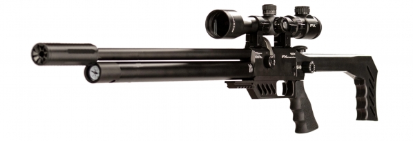

FX Dream-Lite
The FX Dream-Lite is a a striking new rifle, unlike any past FX model. Weighing in at 5½ pounds (un-scoped), this Dreamline lives up to its name of being ultra-light weight. It features a Hogue pistol grip and Skeleton butt stock. There is also a picatinny accessory rail built into the trigger guard making the Dream-Lite, bipod ready.
In addtion to the valve adjustment knob featured on all Dreamline models, the Dream-Lite also comes standard wita hammer spring adjustment knob. This is the same high-end adjuster that is found on the FX Impact and FX Crown. This hammer spring adjuster, in combination with the adjustable AMP regulator, makes changing calibers or adjusting to different pellets and projectiles an easy possibility. Dealers in the US have the option of carrying the standard Dream-Lite, or offering a Dream-Lite with a custom FX Airguns DonnyFL. DonnyFL is known worldwide for producing the finest airgun moderators around and FX Airguns USA is honored to offer this option on many of the FX models including the FX Dreamlines.

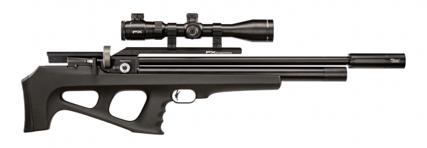

FX Dream-Pup
The FX Dream-Pup finally answers the question many airgunners have had: bullpup or standard sporter air rifle? Why not both?! The Dream-Pup takes the same Dreamline internals of the other models but fits it into a bullpup configuration to shorten the overall length to just 29 inches (33 inches in .25 & .30 caliber due to the longer barrel). Yet can easily be converted back to a sporter stocked rifle with any of the Dreamline configuration kits.
The Dream-Pup has the valve adjustment knob as well as the addition of a hammer spring adjuster. Shooters familiar with the hammer spring adjuster on the FX Impact or FX Crown, will instantly recognize this adjustment, allowing for 13 settings of the hammer spring. This makes the Dream-pup a versatile bullpup that can not only adjust caliber and barrel liners, but also the regulator, hammer spring tension and air flow needed to find the perfect harmonic balance for the projectile you are using.

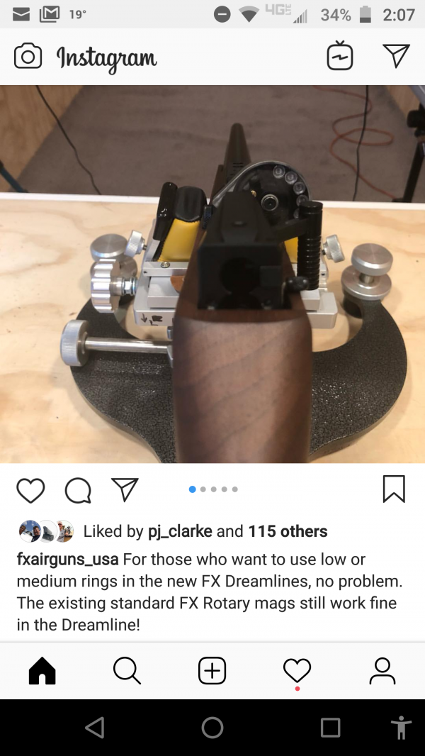

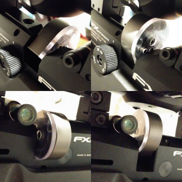

Someone posted a pic/video recently stating/showing a Streamline magazine in the Dreamline.
If a Crown magazine can be used in the Dreamline, but MY Streamline magazine won't fit in MY Crown, how can the Streamline mag work in the Dreamline?
ADDED:
Found it. Seems maybe the mag fits well enough to function, but won't exactly lay flat where it slides in?
I'll have to try my SL mag in the Crown again to see if it will fit. Just looking at the back of the magazines showed a major difference between the two mags that I didn't even try to fit it.
ADDED:
Okay, the SL magazine works in the Crown also, but not a good fit. Notice in my pic how it will rotate like 60 degrees when mounted. I suppose this will be okay as long as it doesn't move out of alignment when cocking.
I imagine it will be just like this in the DL. I'm glad FX posted this, because now I have two spare mags for the Crown.
