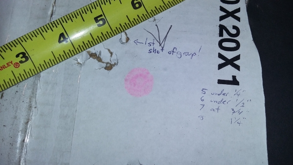

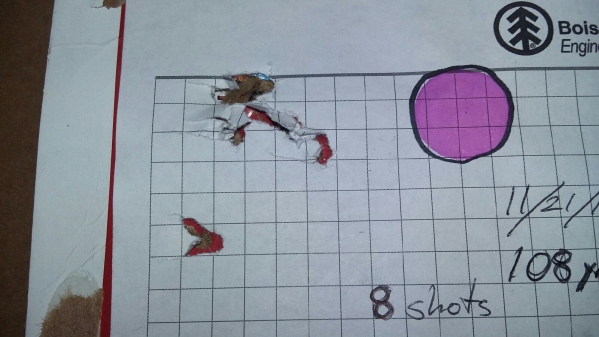

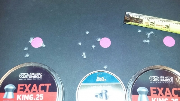

I have shot sub 1/2in groups with 3 FX rifles also at 60 yards. Bobcat,Impact and boss. Definitely accurate rifles.
This is my best group to date 5 shots 58 yards Fx Impact .25 JSB heavy's
