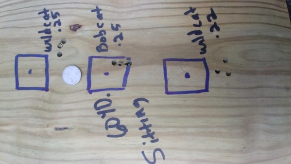

I was taught to measure the widest outside edges of a group and subtract one projectile width to get true C.T.C accuracy results. A dime will cover three .22's in a straight line touching each other (not tears) and the C.T.C group will be .44" Am I wrong?
