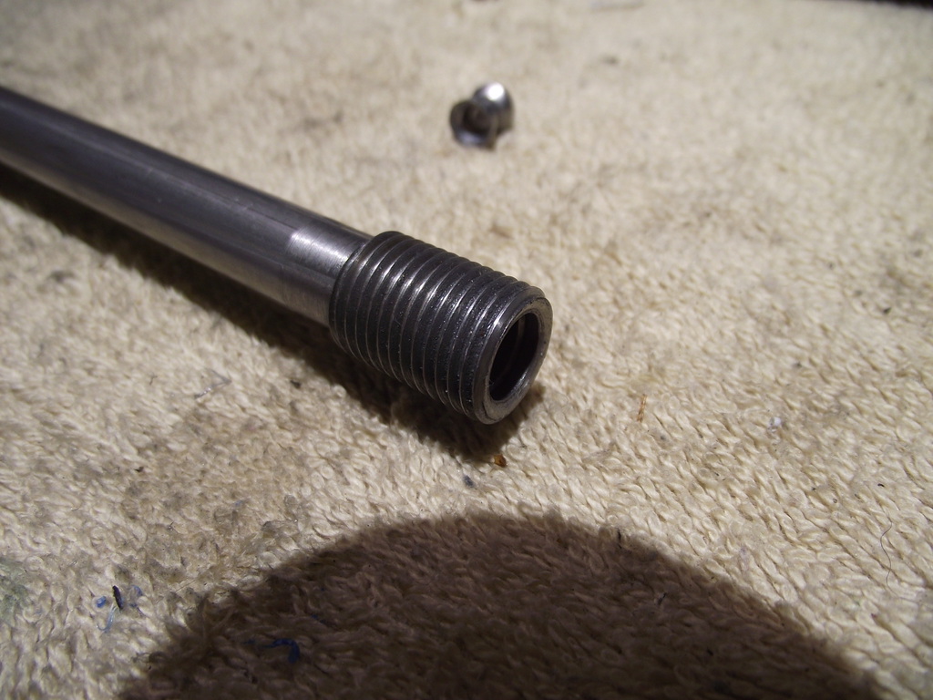

I recently acquired an FX liner to retro fit into a Non FX rifle
An @ .395 O.D. Liner ... Fully 4 groove rifled at 22-1 specs ... 700mm / 27" long in .30 caliber.

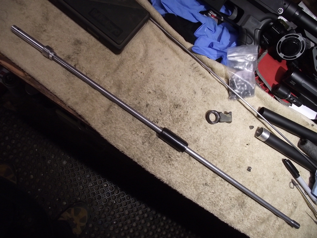

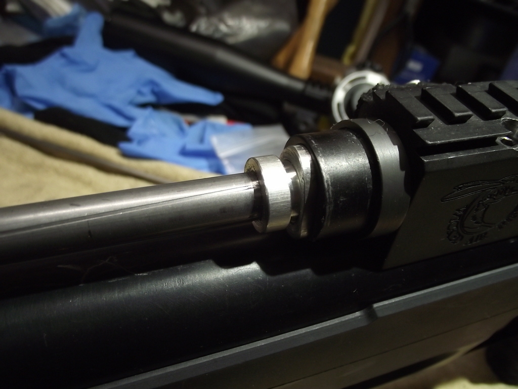

Adapted it to fit my WAR Flex using a steel slip on 1/2-20 thread for muzzle and a 3 1/2" long machined aluminum tube with OEM snap ring groove at breech. Breech o-ring moved to probe. Pressed together with loc-tite 640.
Full length shroud drawing the liner into tension.

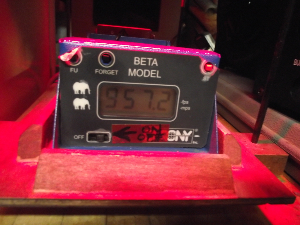

Chrony shot is with a NSA 49 grain dish base ... 957 fps = 99.63 fpe Yea that's healthy enough

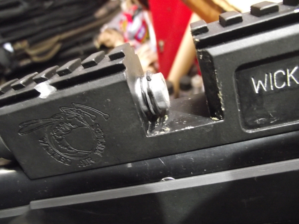

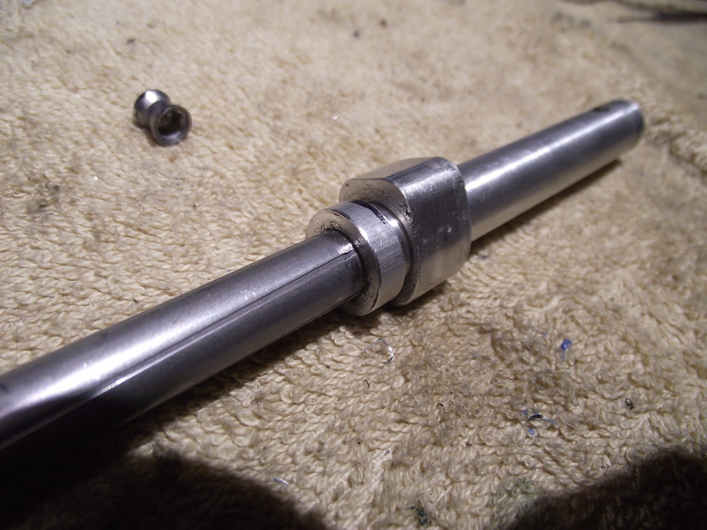

Being we could NOT machine in o-ring grooves either side of transfer port due to the liner ... opted to machine the slip fit sizzle tight. Then placing a 1mm o-ring against breech face, then washer & clip. When drawn into tension the o-ring crushes into the small bevel on receiver/ barrel hole & crushes in enough to flush up & make a seal.

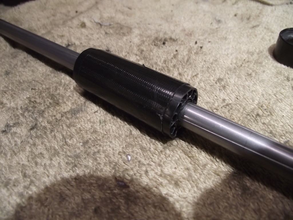

Last pic was my idea to stabilize liner within the shroud. What is it ? It's a core of a printing paper roll ... LOL Made a split sleeve to snap over the liner having the paper roll core press over it. Then slightly built up the O.D. with @ 2 wraps of gorilla duct tape for a firm press fit into shroud tube. No internal shakes now !!

Also make note on the 4th picture the COLLAR up against the receiver on the shroud mounting shoulder. It is NYLON and gives tad bit of yield when tensioning the barrel and helps stabilize the shroud assembly letting it find it's natural square to base position.

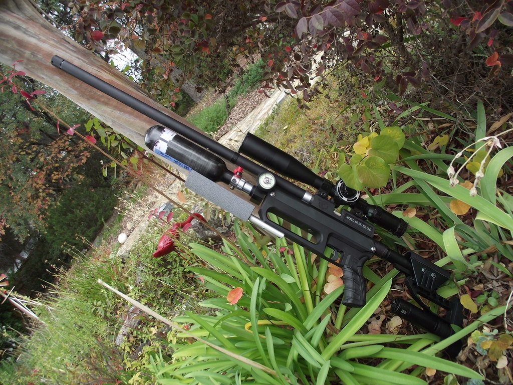

Also on picture 6, is a Donny FL TATSU Moderator that is threaded on a dummy 1/2-20 stud on forward side of Butt plate. Muzzle has a thread protector cap in place and if you need to hush it down simply swap em out. Interesting tho is the fact the rifles not that loud for making 100 fpe and this has a lot to do with the JSAR inspired hybrid balanced valve, SSG hammer spring and light hammer. Air delivery is switch on / switch off fast having a fairly short dwell cycle ... Just a quick SNAP firing cycle.
