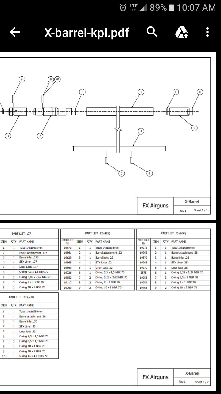

Can someone tell me the o-ring size for the outside of a .22 liner?
nomojo65 Member Dec 3, 2015 3,028 1,093 60 Great Lakes, United States Dec 27, 2019 Add bookmark #1 Dec 27, 2019 Add bookmark #1 Can someone tell me the o-ring size for the outside of a .22 liner?
F Fire_at_will Member Aug 26, 2018 218 7 MI Dec 27, 2019 Add bookmark #2 Dec 27, 2019 Add bookmark #2 5.23 x 2.62 Upvote 0
F Fire_at_will Member Aug 26, 2018 218 7 MI Dec 27, 2019 Add bookmark #3 Dec 27, 2019 Add bookmark #3 Here is all parts list for x barrel Upvote 0
nomojo65 Member Dec 3, 2015 3,028 1,093 60 Great Lakes, United States Dec 27, 2019 Add bookmark #4 Dec 27, 2019 Add bookmark #4 Thank you! Helps me alot no time to order trying to get locally Upvote 0

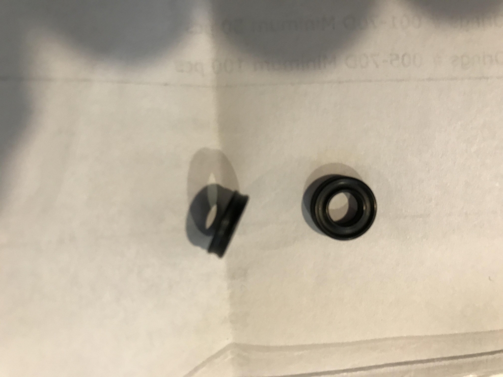

nomojo65 Member Dec 3, 2015 3,028 1,093 60 Great Lakes, United States Dec 31, 2019 Add bookmark #5 Dec 31, 2019 Add bookmark #5 This is what happens when you don’t know what your doing when ordering o-rings? I guess? Upvote 0
