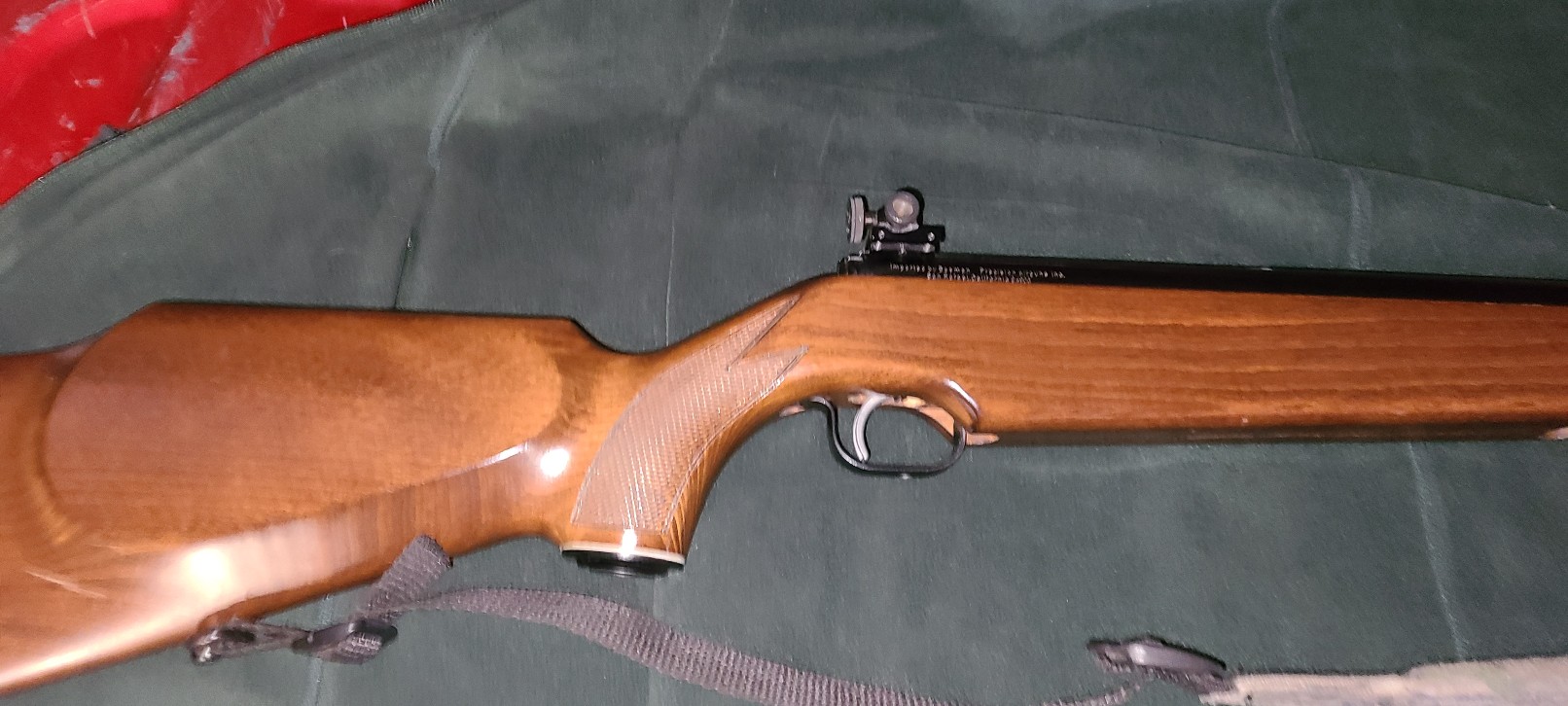

Thanks for the trigger guard John. The gun looks great.
A before and after
Waiting on new spring and seal but very happy with how the stock came up.

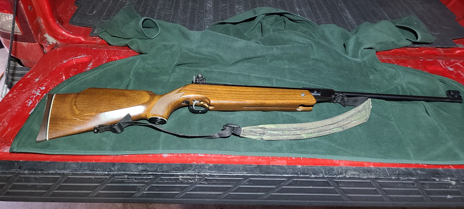

I chemically stripped the stock and the old lacquer came away and left a lot of the original stain. I very lightly sanded and worked on keeping the original stain as even as possible. Then applied one coat of walnut stain by hand over the original.
It still has the odd small scratch but I didn’t want to sand it all out. I like the colour.
Then sprayed clear vanish to finish.
I wanted as close to original as possible but it is very glossy! A bit too glossy.

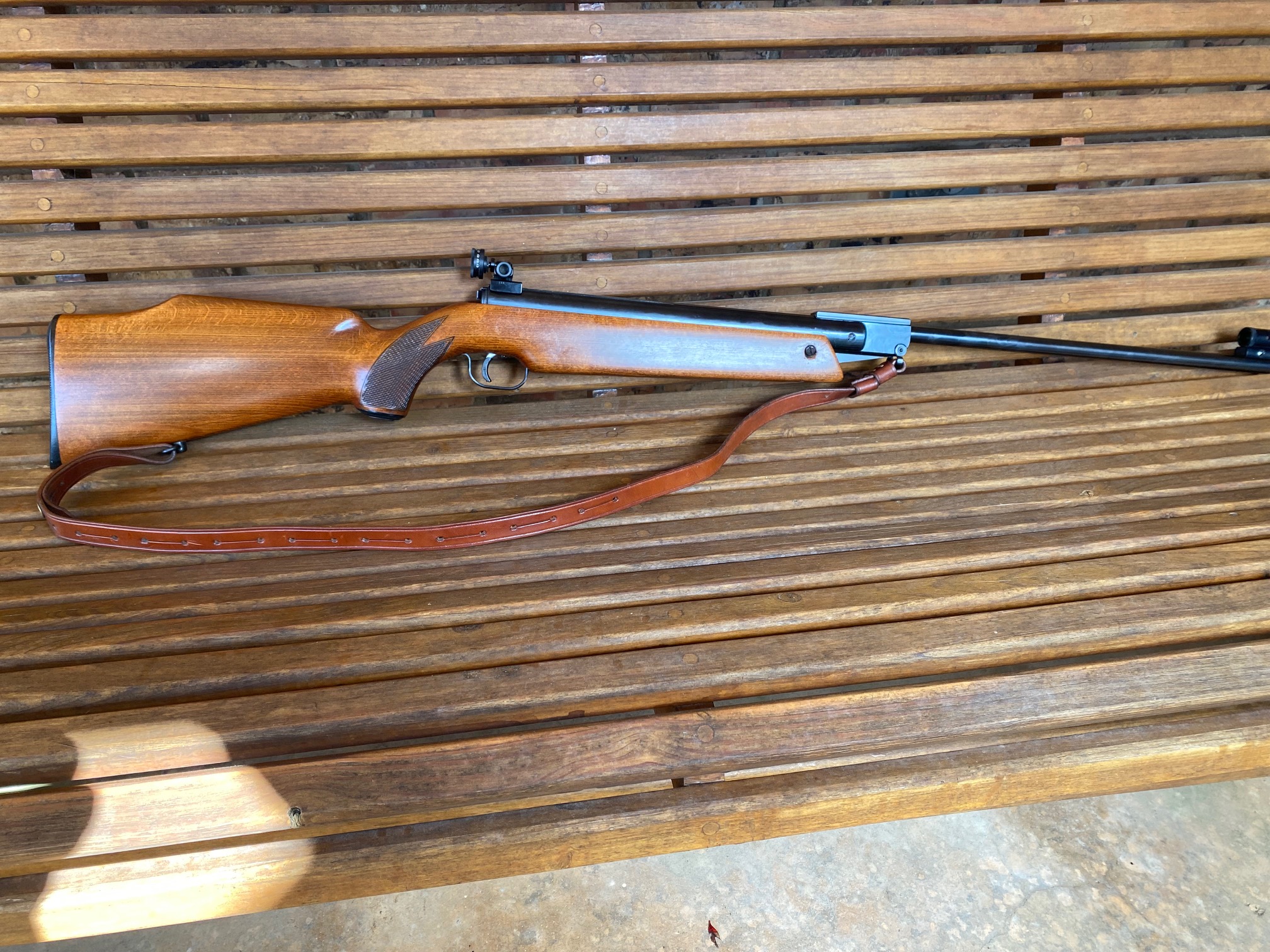

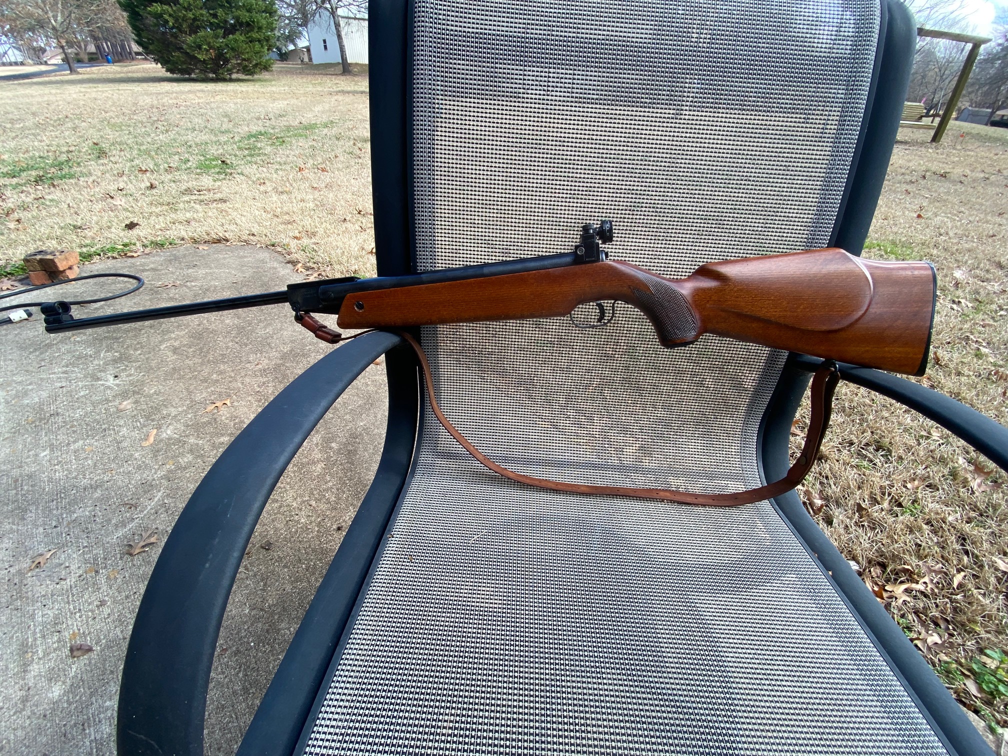

Not the best pictures, Trying to position to eliminate glare. I used to have it set up with a "muzzle brake" like yours. I had this WIliams sight on it for about the first five years then the muzzle brake and a Beeman blue ribbon scope for a little over 40 years. I had the gun rebuilt internally a couple of years ago and went back to the receiver sight with a Gehmann adjustable diopter and put an Anschutz front globe on it. I have a clear plastic diopter in that globe, and find it excellent for target and casual plinking, basically no matter what the range is I just center my target in that front ring.

Very nice. You got the stock spot on. Yours has the early plastic butt pad too. That wasn’t around for long , they must have changed that in the first couple of years of production. I’m surprised it’s not mentioned in association with the early guns more often.
So is that just an oil finish?

Thanks, yes it is an oil finish, It has been too many years for me to remember exactly what though. As far as the muzzle brake, look to see if there is a little screw to hold it on, otherwise if it was like mine it is just tapped on. Mine came off without any damage to the barrel finish. Off a bench at relatively close range 10-25 yards I can shoot groups almost as good as with a scope. Longer ranges a scope is better. but I find the gun just balances and handles better with the iron sights, plus it's more challenging. I like to stand up and shoot if offhand more than off a bench. At my age it is no longer easy to get into or out of a sitting, kneeling or prone position. I did learn to shoot the double diopter system 60 years ago on a college ROTC rifle team.
Looking at the pictures I posted, I find it amazing how the color looks different under different lighting condition. Both were taken outside within a few minute of each, just with sunlight coming from different directions
