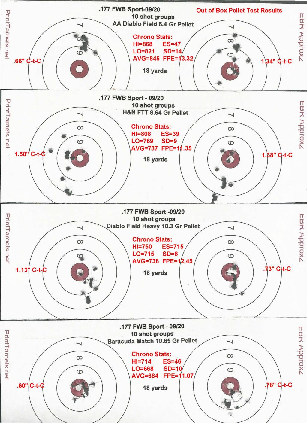

Upon receipt, unboxing, studying the owner's manual, and prepping the barrel, I put it through the paces shooting four different pellets using my indoor 18 yard range. As you can see by exhibit 3, the results were less than stellar, especially compared to what I am use to with my HW77, HW97, and TX200 rifles. I found the shot cycle to be really harsh, and the trigger only fair. It was also hard to get the pellets to seat properly.

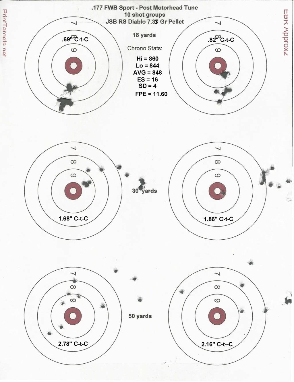

The results can be seen in Exhibit 2, as the SD dropped from 12 to 16 FPS depending upon the pellet, to 4. The groups sizes diminished considerably. The rifle is very smooth to shoot now and the trigger is perfect. He did a great job with it.

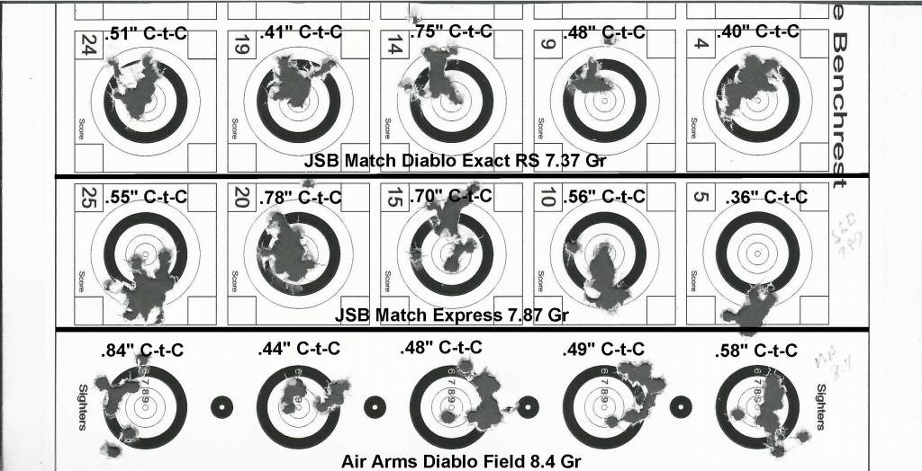

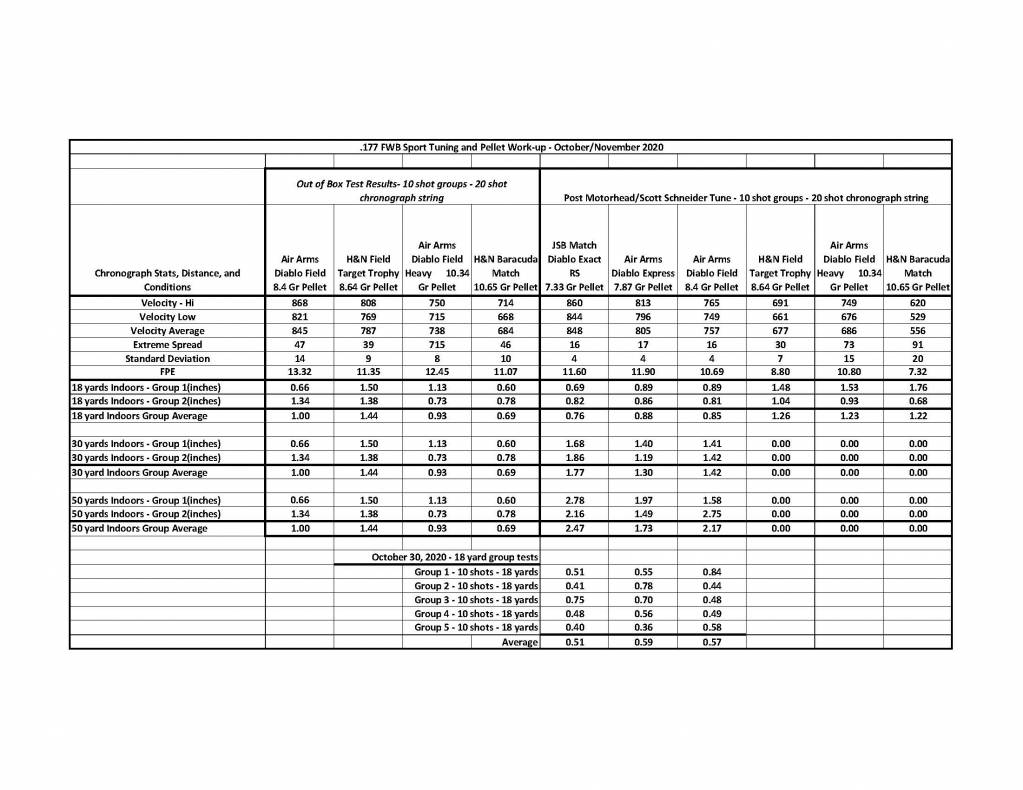

I next tested six different pellets at 18 yards, with the results shown on Exhibit 2. The best three were the JSB Diablo RS 7.37, the Air Arms Diablo Field 7.87, and the AA Diablo Field 8.4. To really test consistency, I then shot five 10 shot groups of these pellets at 18 yards, with the results shown on exhibit 4.

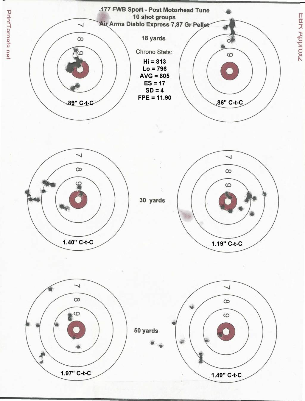

Finally, I took the FWB to my 150 yard indoor range today, and shot 30 yard and 50 yard 10 shot groups to determine the best performing pellet, and then shot to POI every five yards from 20 to 55 to develop the range card I attached to the rifle. See Exhibits 5, 6, & 7.
