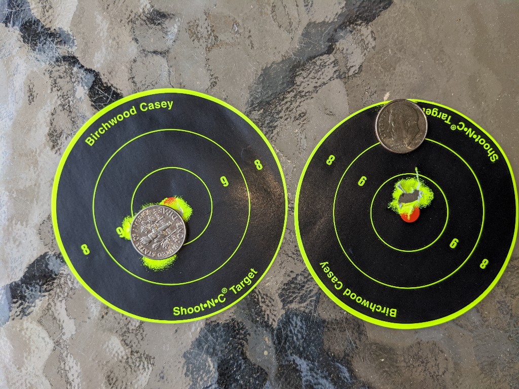

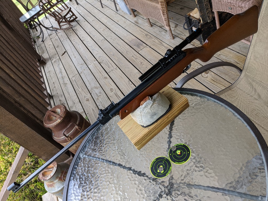

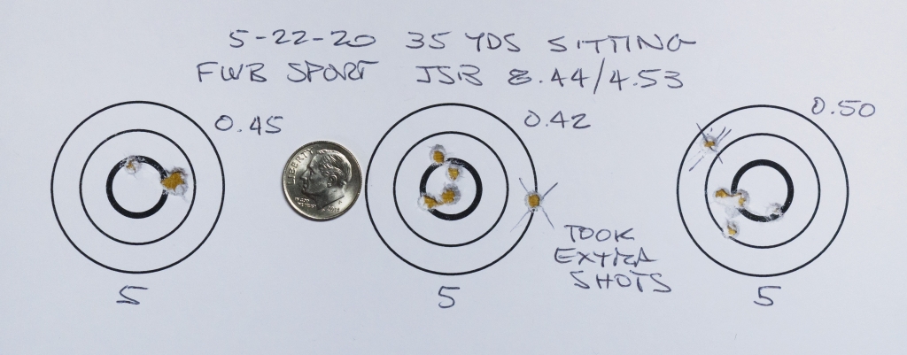

In spite of the noisy shot cycle, which really comes across after a session with the TX200, this gun is turning out to be surprisingly easy to shoot well. After sighting in the TX I decided to shoot a few with the FWB Sport to see how it would compare. I have only shot it scoped once before, but even without a lot of time with the gun I keep getting good groups, and without a lot of effort. About the only thing holding it back is the trigger force, which is a little high for best shooting with a springer. So if you will forgive my mistakes, I think this gun is showing a lot of promise, even in its stock configuration. Almost makes you think FWB knows what they are doing.
