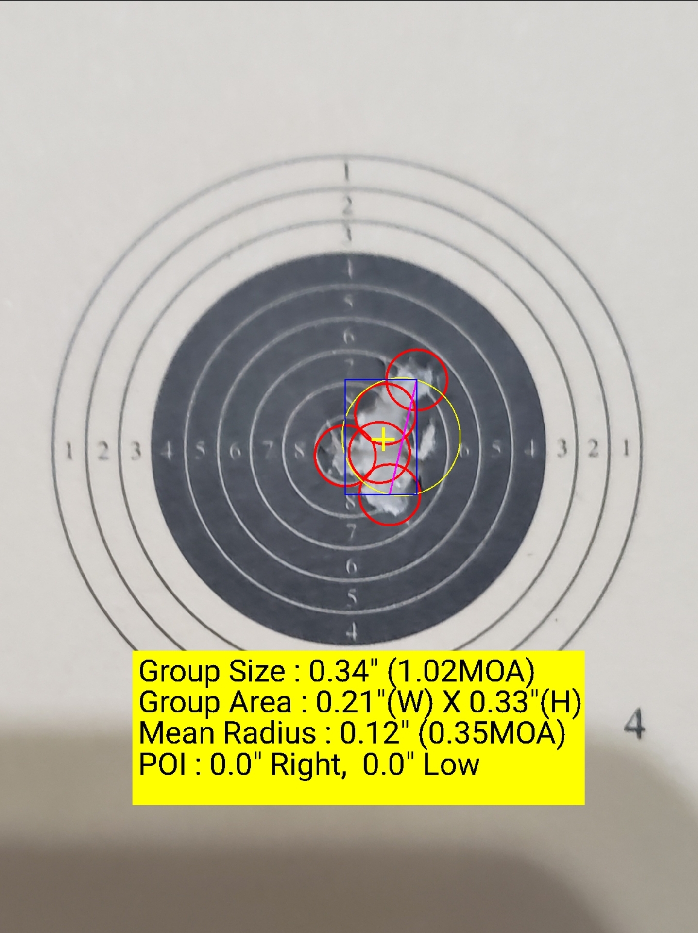

Same with mine. My scoped Sport had been sitting for a couple of months and I decided to take it for a spin. My intention had been to shoot 5 groups but then I shot one group, no warmups, and put her away. It wasn't the greatest group I've ever shot but from a cold gun that hadn't been touched in awhile, I wasn't going to push my luck and just end things with a grin on my face.
