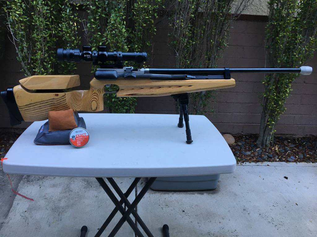

This is how I did my FWB 601 SSP. Used the short gate sold on eBay. Zero eye relief MTC scope. Dovetail to pic rail riser.
