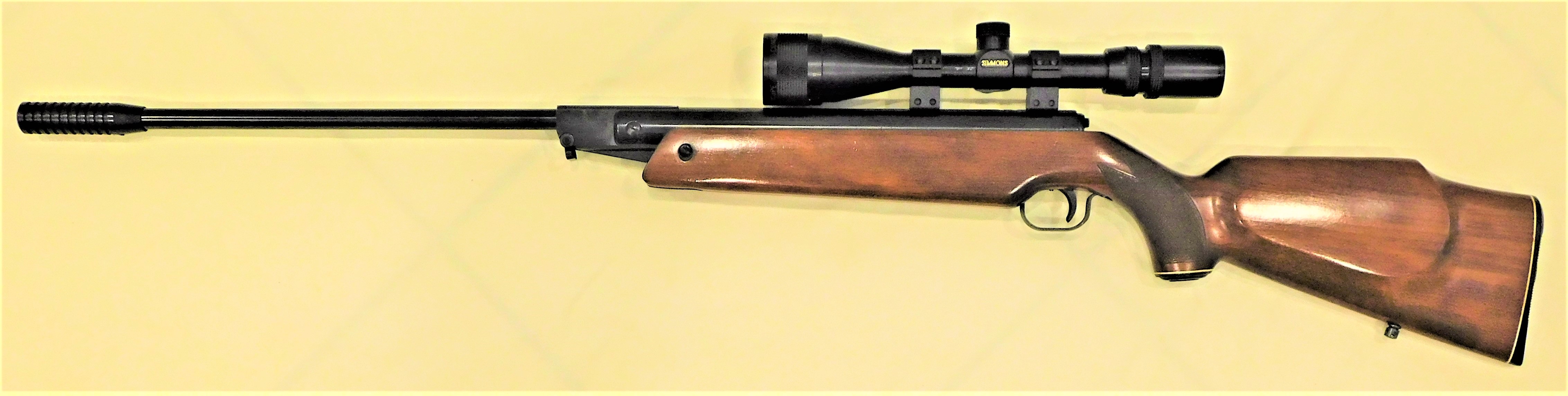

I have one because I had to have one of everything and like it but to be honest my HW50 is a whole lot better. Lighter, better trigger, shoots nicer, and just as accurate. A little bit less power becaus my 124 is full power. Even looks better especially with a custom stock. An HW50 sells for less than a used 124.
Oh heck, have both!
Oh heck, have both!
Nice looking 50!!!!! .

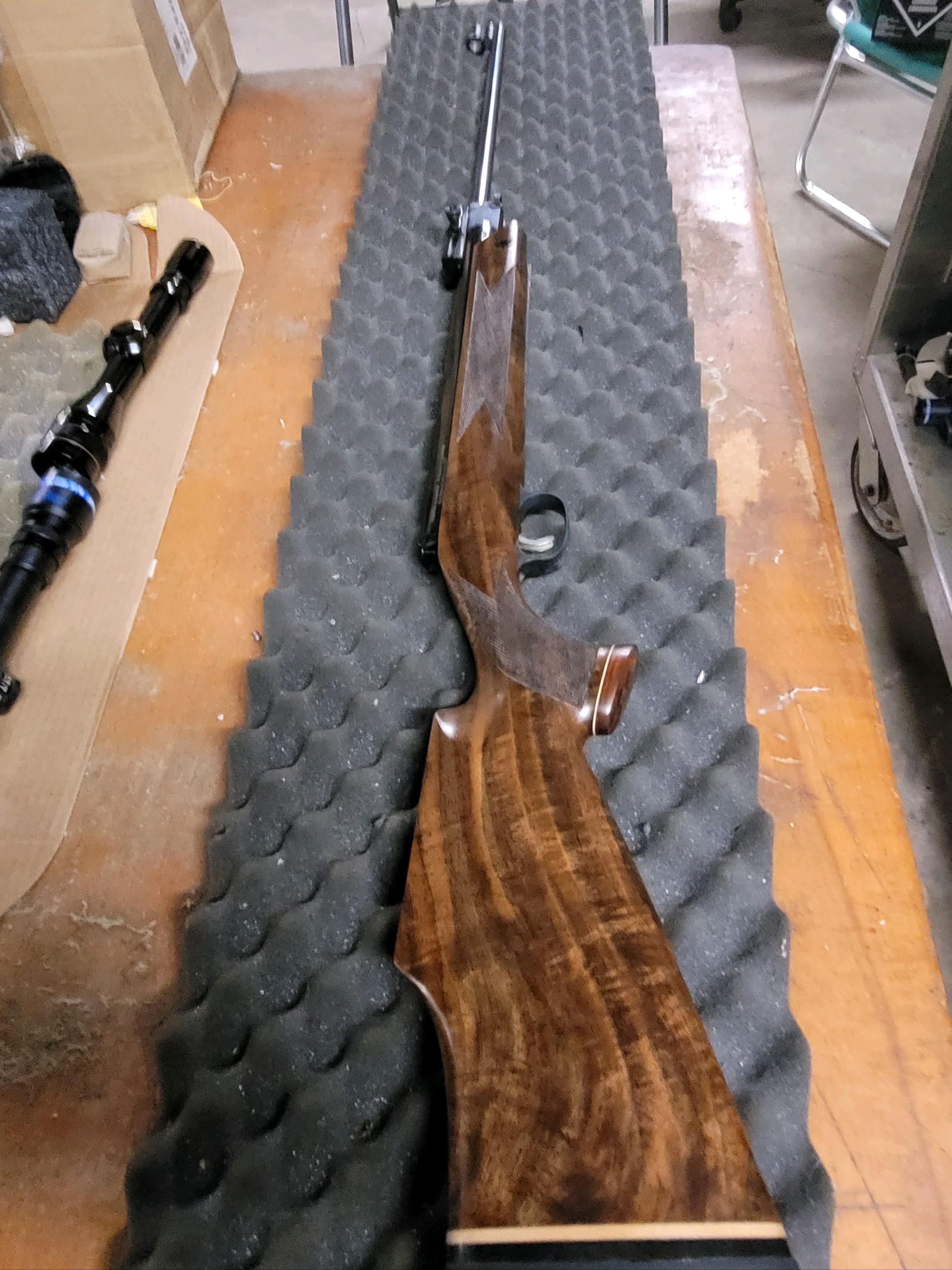

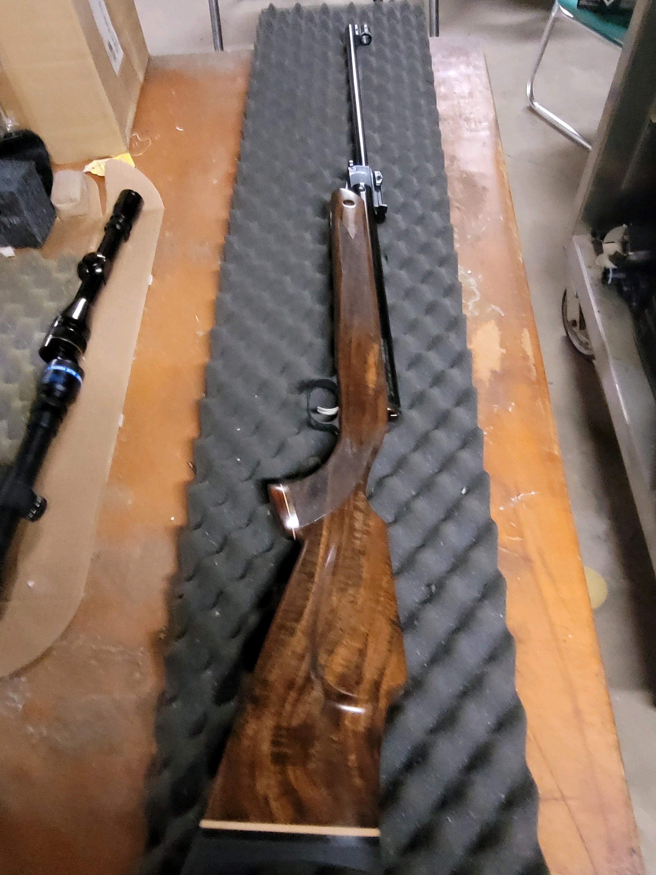

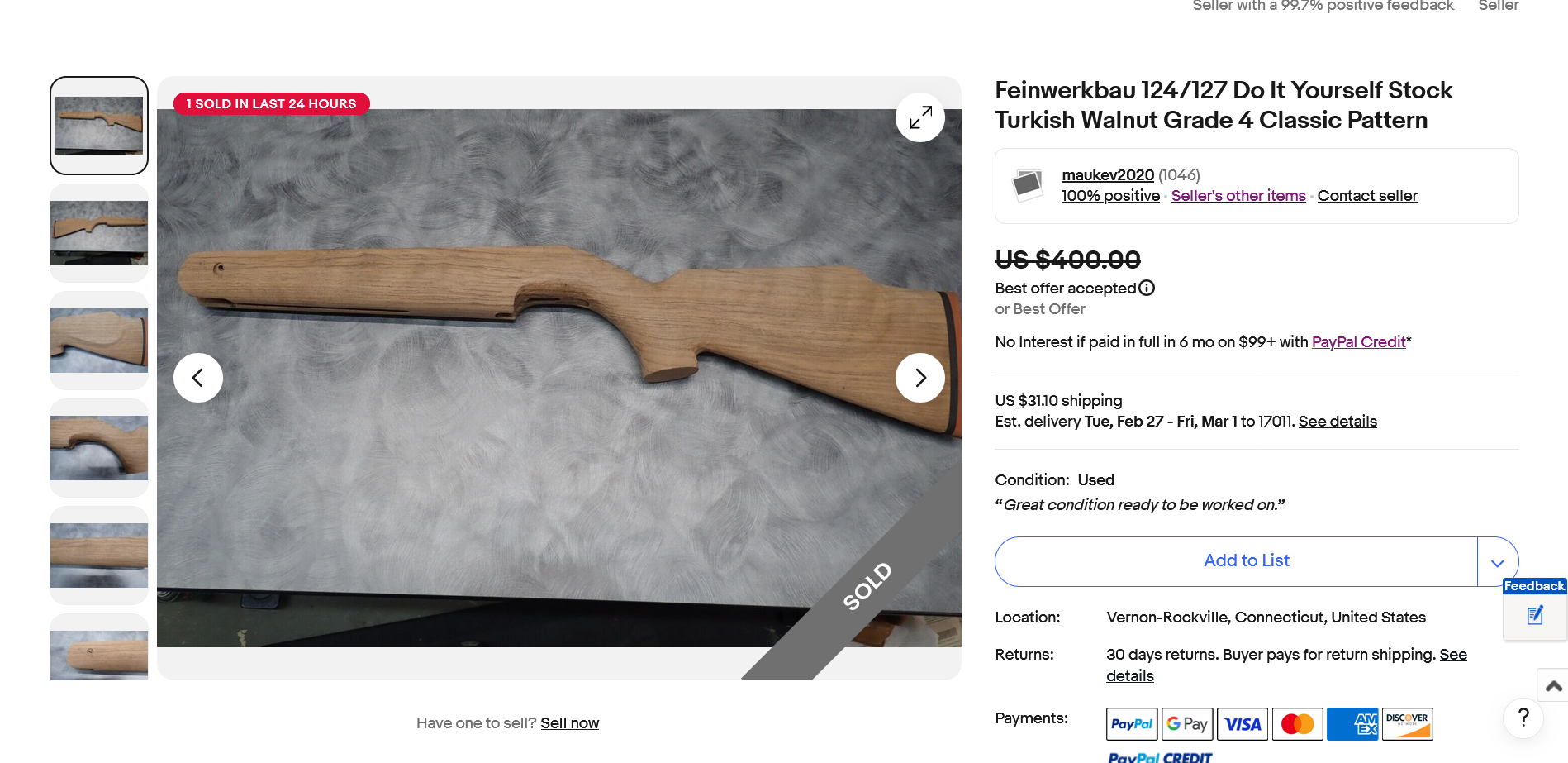

Probably stain or dye to bring out the stripes and any figure I think I see something in it based on some of the pictures. I haven't received it yet. I can play with it before I do final shaping and finish sanding. And see what I like. It's all up in the air. If I'm staining it I have to do the checkers first. Blond walnut isn't my thing. I'll know a lot more when I get it wet.
For sure it will get a sanded in finish. Shadow line cheek piece? Maybe a little delrin domed grip cap? Dreaming? Perhaps
Yeah, I could have said HW guard. Same thing. They're reasonable and easy to get. I really should make a milled and filed steel one but my shop time is limited. Two more years I plan on going part time. I'm 64 and really fit so I should have some great years ahead to make and do everything I've dreamt about. Praying for that always. And giving thanks for how it's been (y)
a light wipe with water brings grain out to see what it may look like after finishing. then a light finish sanding b4 any stain or oil .

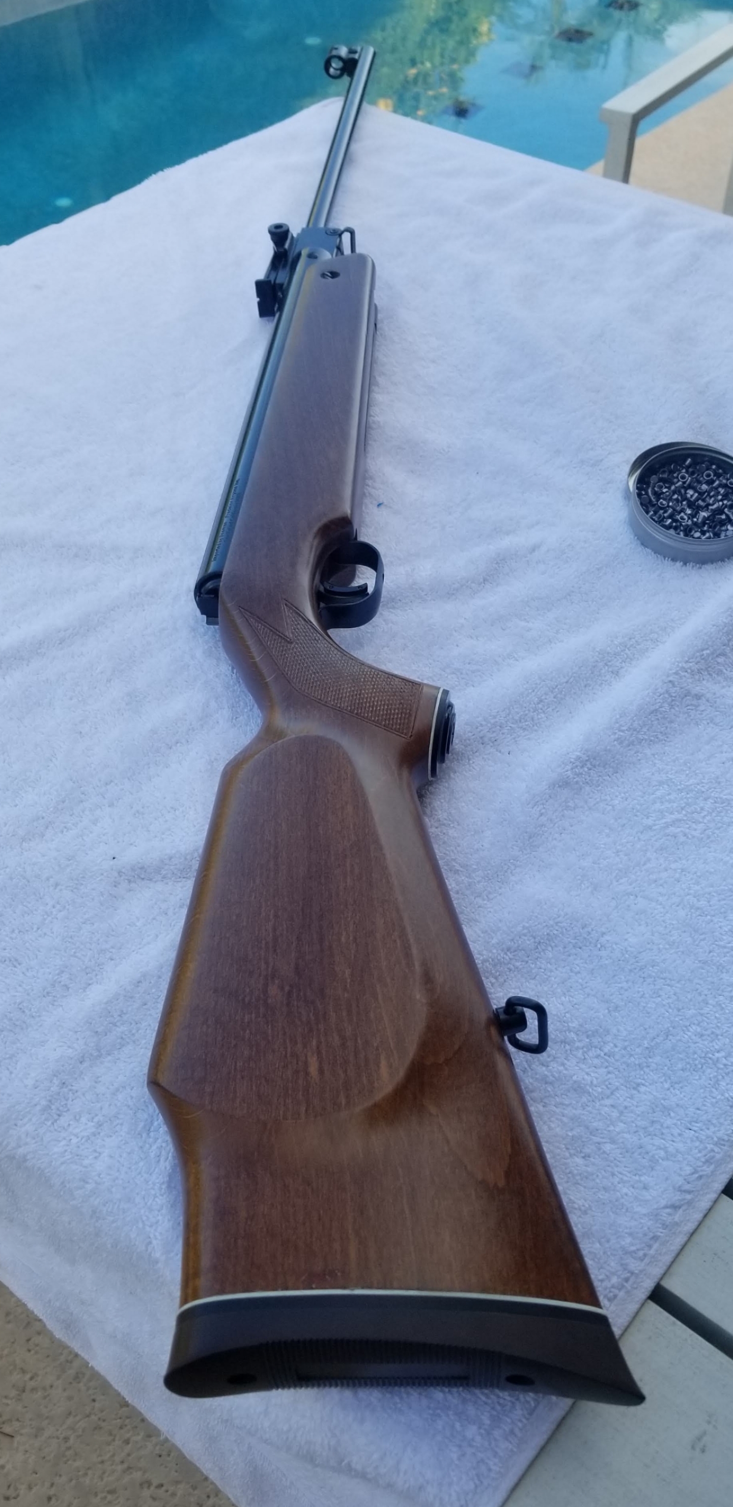

Mine's a little different. The price a little dear. But the wood looks like it has great potential.
Did you use a Beeman trigger guard?
To the guys that passed it up.
This might make you cry.
First sneak peek not the best lighting. It looks much better in person. Both sides.
