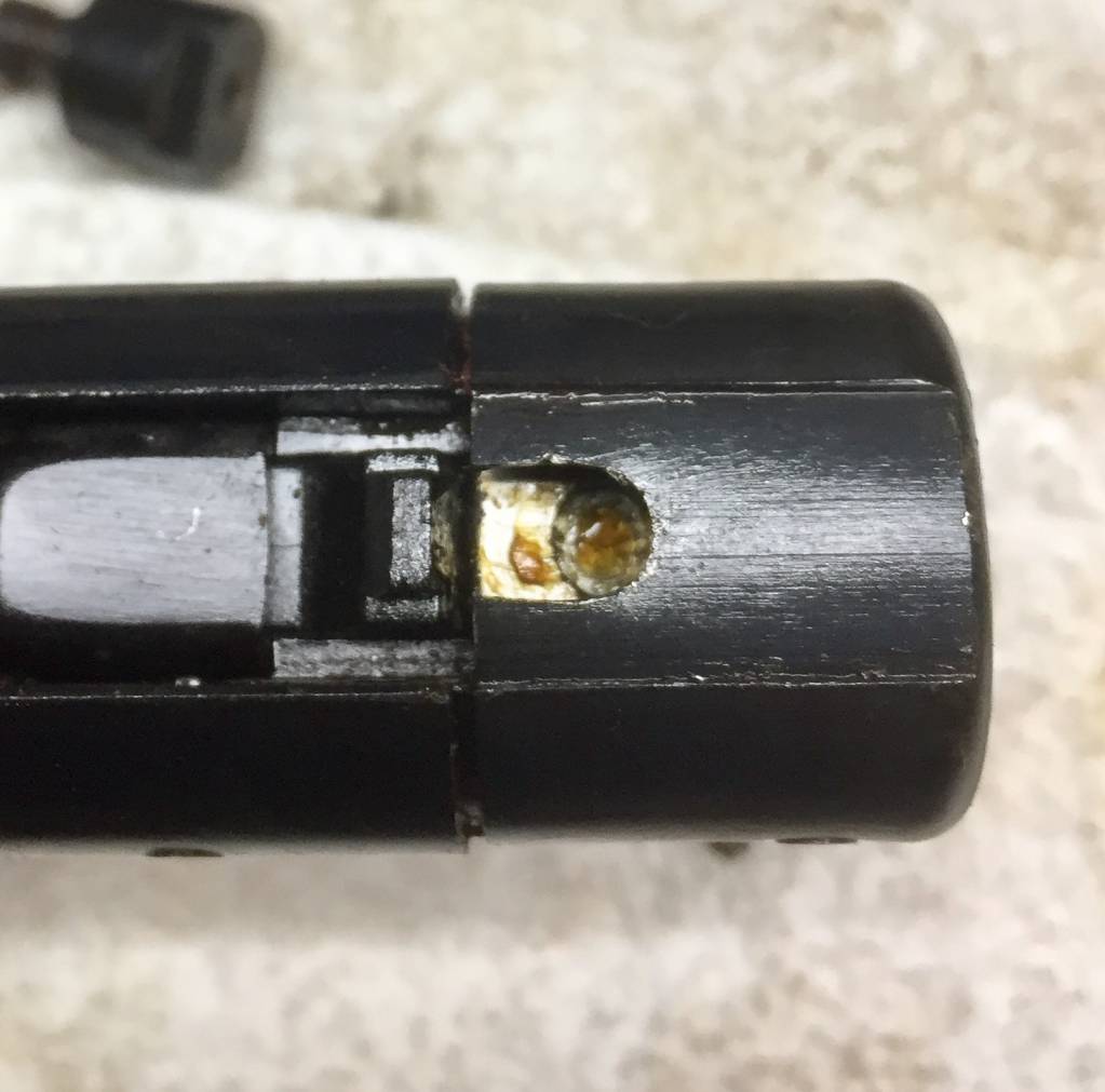

Have two early, 4-digit FWB 124's that I shoot all the time. Just noticed that, on both guns, if I cock them, Load & close the barrel, leave the safety on and pull the trigger, both guns will walk the safety in a bit, then fire. Kinda small potatoes, (till I go to sell one) but is this a quirk for these? Kinda weird that both rifles do it. One has the aluminum trigger, and the other is plastic. No matter how I adjust the trigger screw on each gun, It doesn't change, and both rifles discharge with the safety on. Had both apart recently for installation of a Maccari "softer" kit on one, and a standard polish/lube tune on the other. Safety & spring was put back correctly on both, using the zip-tie trick. Could it be something I did? (Didn't touch either trigger assembly when work was done).. If anyone has had this issue and has a fix, It'd be much appreciated.
Thanks MH... I appreciate the reply. Actually just checked and you dont have to cock the rifles. In de-cocked state , just pull back and activate the safety like it normally goes. Trigger is then hard to pull, as safety is in the proper position , but with every additional pull on the trigger, the safety walks forward, and the gun can discharge. It's like the trigger is helping the safety to disengage. Not a clean disconnect like a Rekord...Happens to both guns, irregardless of plastic or aluminum trigger. Just curious if I can fix this problem with just the trigger parts & without gutting the guns, as they both shoot hard and are lasers.. I will look into what Motörhead suggested,,,Any additional help here would be great.
Broke out the spring compressor and will pop out the trigger pack today at some point, and make sure everything's Kosher.. I tried adjusting the trigger screw in half turn increments all the way in & all the way out. Safety still pops in when trigger is pulled, regardless of trigger adjustment.. Think its something maybe I did when I last reassembled it, or maybe one of the little springs broke? but theres not much to mess up there. Will report back later. Thanks all.

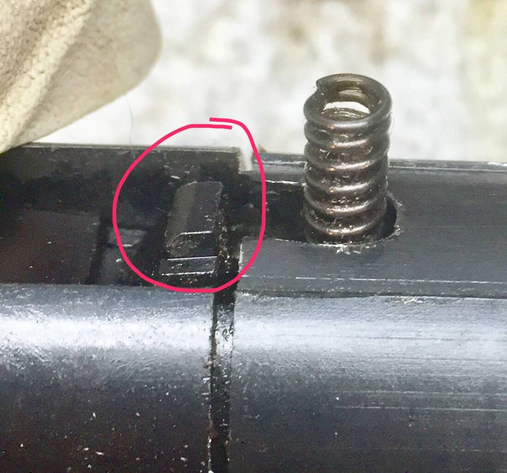

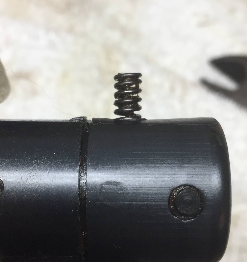

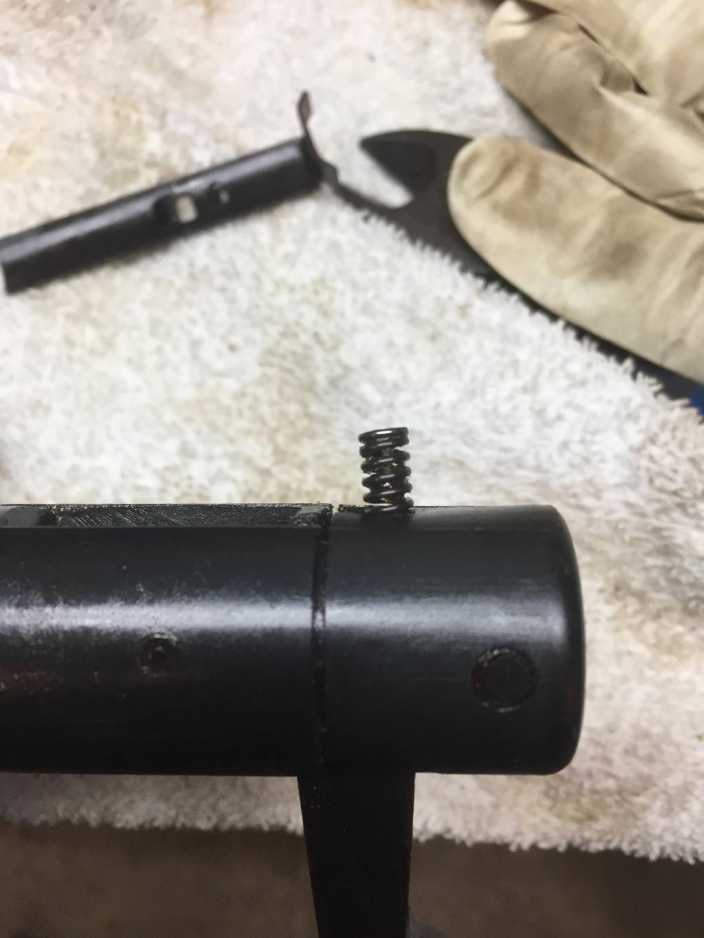

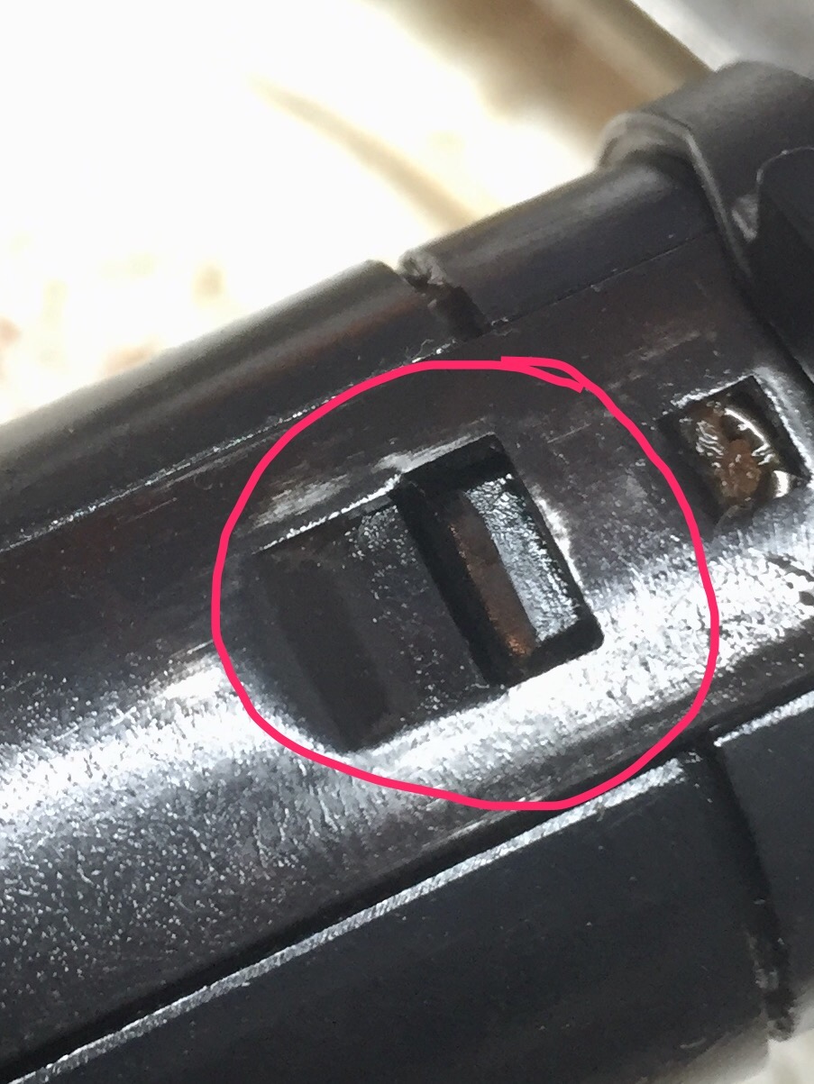

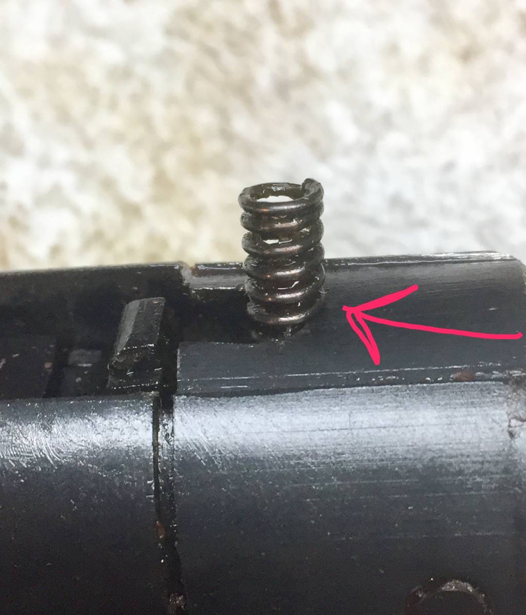

Well....tore into it and found what was wrong. Two things actually. First, the vertical sear/safety spring was cocked at an angle. The spring was fine, but the hole where it sits was occluded by the top sheet metal by about 1/16", preventing rearward movement. I dremmeled the recess so the spring now rides unimcumbered. This is a factory foul-up and while it helped, the rifle still fires on "safe". Here's a few pics to illustrate what I mean.
BEFORE
AFTER
Now, the spring stays vertical and rides free. This enabled the sheet metal safety to slide back more, but still not enough.
Now to what I think is the real issue. A worn plastic trigger. I'm sure its supposed to have a minor bevel on top so it can slide over the safety, but I feel the bevel has grown too big from use, and the safety now won't go back far enough to properly block out the trigger top.
The fix for this particular rifle is either extend the safety somehow by 1/16" so the safety can properly slide over the flat part thats still there on the trigger top, or get a new trigger blade that hasn't got the large bevel. In fact, when I push the safety lever back 1/16" further than where it usually registers when cocking, the rifle's safety works perfectly. I'm thinking I should build up that 1/16" somehow..
