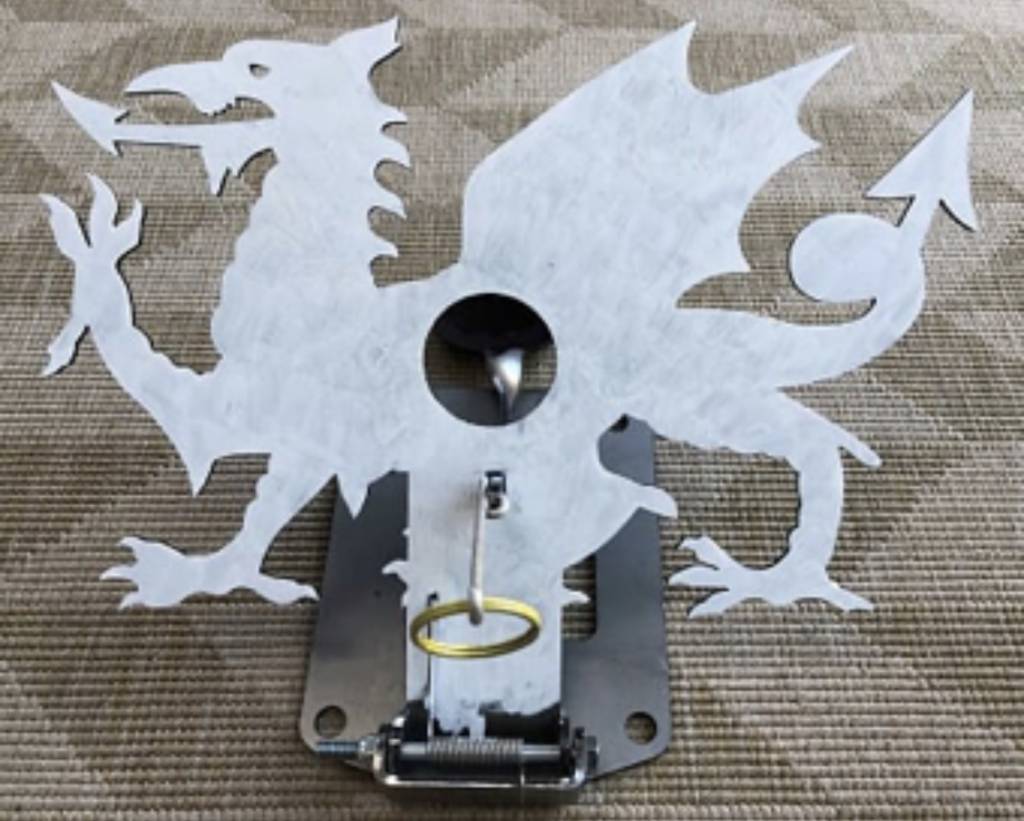

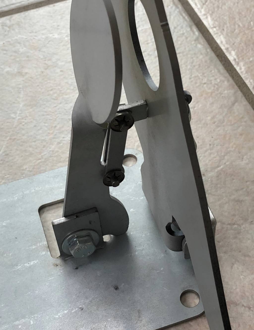

http://www.flop-over.co.uk/
Flop Over Targets are less than Paul’s targets and more than Gamos or Air Venturis.
If you order at least six targets, the UPS shipping and price per target becomes very reasonable $34 each. All welded construction with no bolts to loosen up. No maintenance except for repainting.
