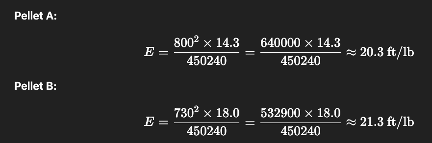

Let's assume you have two pellets:
Pellet A: 14.3 grains at 800 fps
Pellet B: 18.0 grains at 730 fps (heavier, but slower)
Result: Although pellet B travels slower, it has more energy because it is heavier.
