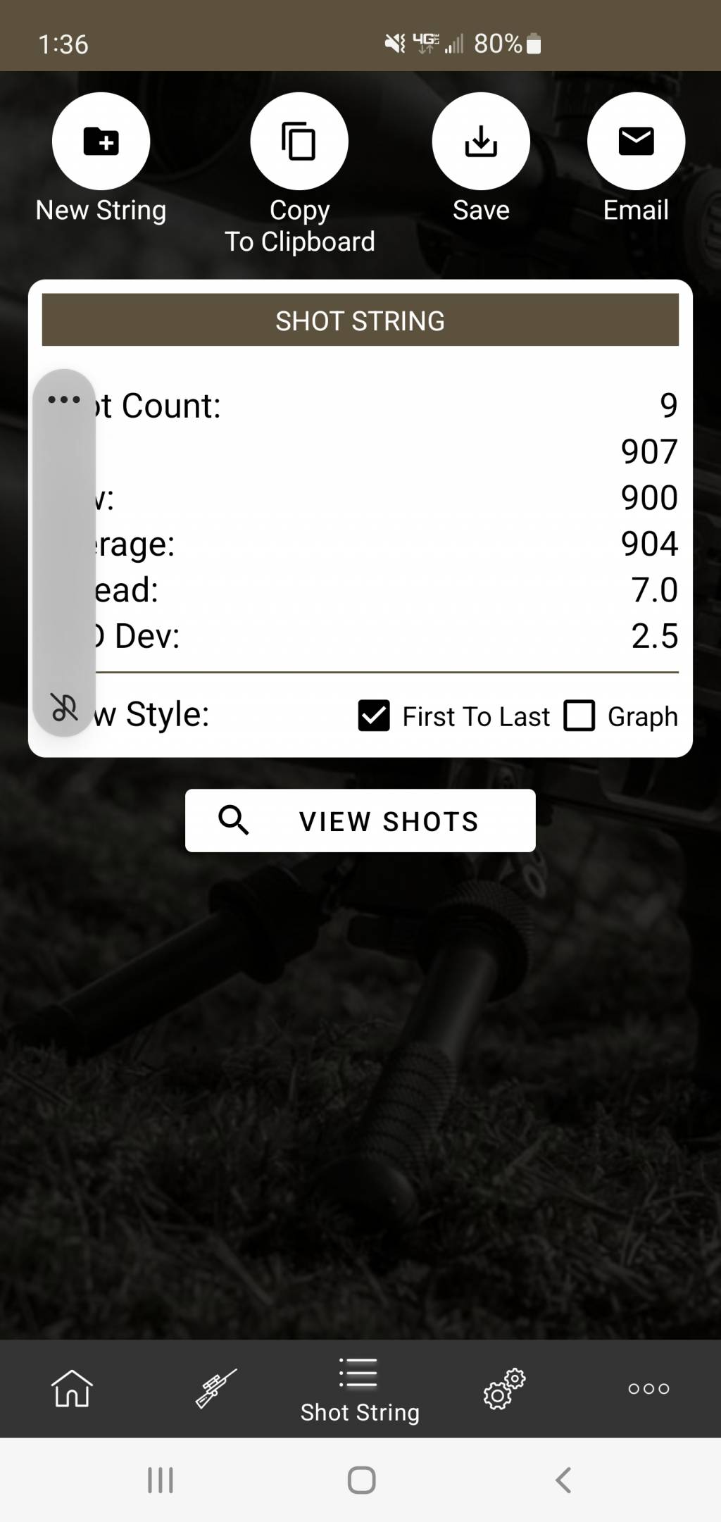

Saved my life man. Got my answer: self inflicted.
Looking for the peak fps I had to completely max hammer spring out at 5. 950ish. The next part is where i would go wrong. Id turn macro hammer adjuster back down not the valve. Using your method: turned valve adjuster down brought fps back to 900. This is what I have now. Much much better. And stacks pellets at 30 yards like it should.
mine is very similar to Al_Miller
difference in my m3
