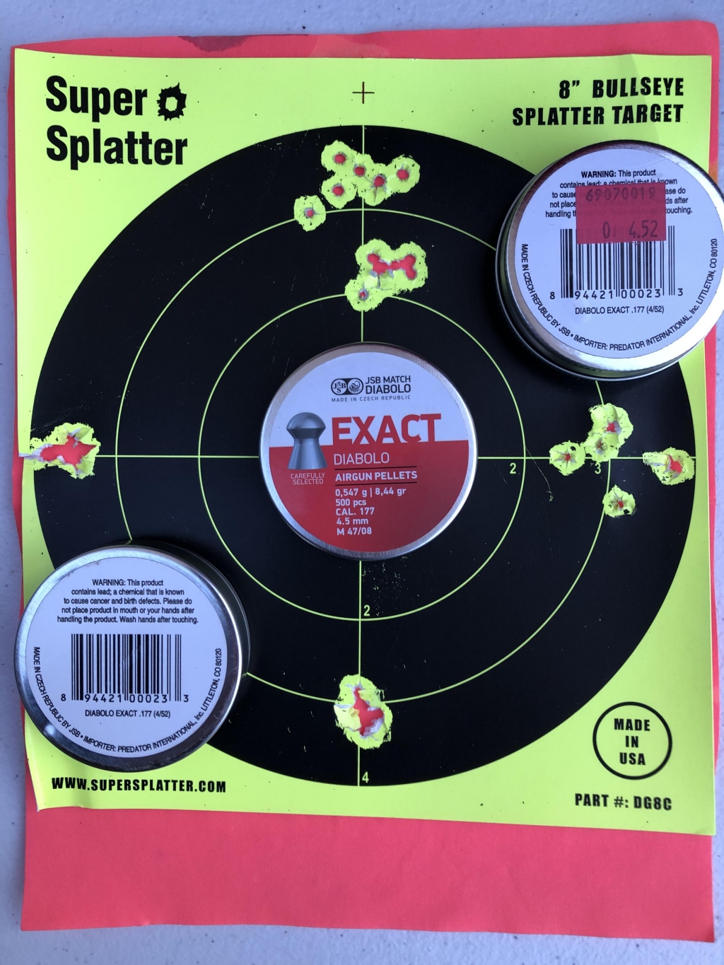

I was down to my last 2 partial tins of 8.4 JSBs. I added 4 tins to my last order. I emptied one of those partial tins so now I only have 1 partial left. I grabbed a new tin and started shooting. They weren't grouping consistently and they were hitting 5-6" higher than the others at 80 yards. I moved the target in closer at 40 yards and started with a fresh target. The groups are terrible.
I shot two magazines (8 shots) with the new pellets and two with the old. Then I shot one last magazine with the new just in case I had warmed up threw the groups off while shooting the first ones with the new pellets.
Big difference. Really a bummer because now I have 4 tins of pellets that I'm not satisfied with their performance. I wish there was some better consistency in making these pellets so things like this wouldn't happen. At least I didn't make a HUGE pellet order like I was going to and get stuck with 20 tins.
I have had this happen before and it was just as disappointing then as it is now.
How do you guys deal with this?
Attempt a return or exchange? Just shoot them? Any other ideas?
It feels like I am stuck with an inaccurate gun. Now my second most accurate pellets have just jumped to first.
I know that this isn't the end of the world but it still bothers me knowing that I can't shoot as well as I had and I have no control over it.
Top and right are the new pellets. Bottom and left are the old.

AA and JSB are made in the same factory. AA use proprietary dies and different lead. If you look at a die 11 AA 8.4 and die 11 JSB 8.4 side by side they will be different in head shape, skirt shape and skirt depth. You'll also be hard pressed to find die lots of each brand run on the same day.
