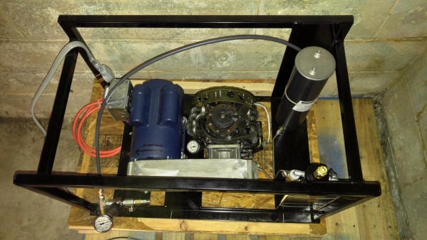

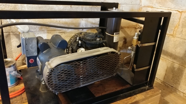

Would you mind posting a pic of the compressor you got from Jim Sheldon? I'm curious to see what they look like?
I actually got it from a fellow airgunner. He was getting out of PCPs. I had to choose between a nice 30 cal RAW and the compressor. It only had 13 hours of use time when i got. I have talked to Mr. Shelden. He likes to follow where his compressors are and keep a registry of owners. He said there are some of his compressors still in use that he built in the 1970s. I have 13 PCPs, 5 (ea) 87 cf tanks, 3 (ea) 65 cf tanks and one 45 cf tank and the compressor still on has 25 hours on it. I volunteer to fill my shooting buddies tanks because it is pretty fast.
