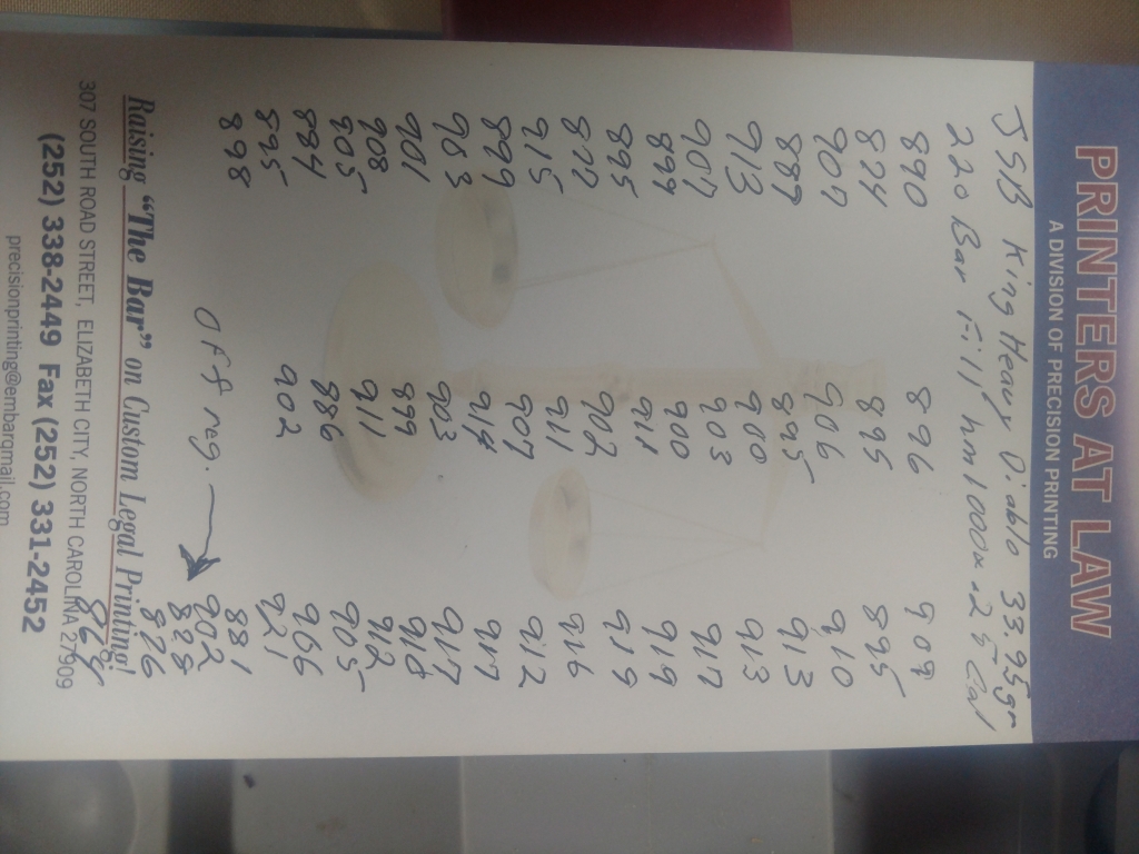

Here is what I've done today. Removed scope checked the barrel screws. They were tight. Reinstalled scope level with rifle. Shot this shot string on the chrony.
It was windy but the grouping was 2.5-3.0" low. The wind was from behind me 7:00 to 2:00. Thanks Bob I will definitely check the torque on the mounting screws. Barry

@Barry seems like your standard deviation is in the double digits, it’s at least 11 FPS between shots, and your ES is at least 40 FPS. Those numbers seem high for a regulated gun.
I agree about the chrono numbers, they seem to be all over the place from a reputable gun. I am hoping it is the chronograph. After my last post I recounted the scope but I used my torque driver to tighten it down. Somehow tightening down on the scope rings too much makes a lot of sense. My scope reticle moves greatly over an extended time. We will see tomorrow if this has anything to do with my issue. If my poa and poi are good tomorrow I will be a happy camper. Many thanks to all who have chipped in to help. I enjoy the shooting but not the trouble shooting too much. Thanks again Barry
