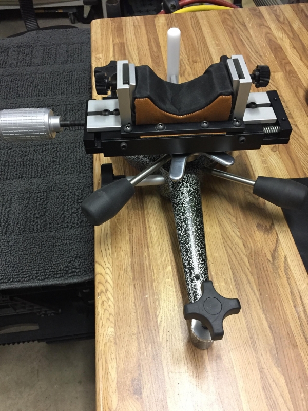

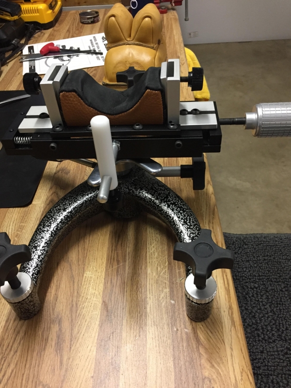

The rest worked great, but the cable being bent is glitchy for the windage. My friend Jimmy, AKA Camp Fussell, bought one when I sent him the info. I told him I was cutting the cable and would tap the knob onto the windage bolt. He suggested a sleeve over the parts. So off to Tractor supply and $9.00 dollars later I came up with the sleeve and tapped in some allen grub screws. Then turned the table to the left for us righty's and done! It now operates like smooth glass...
