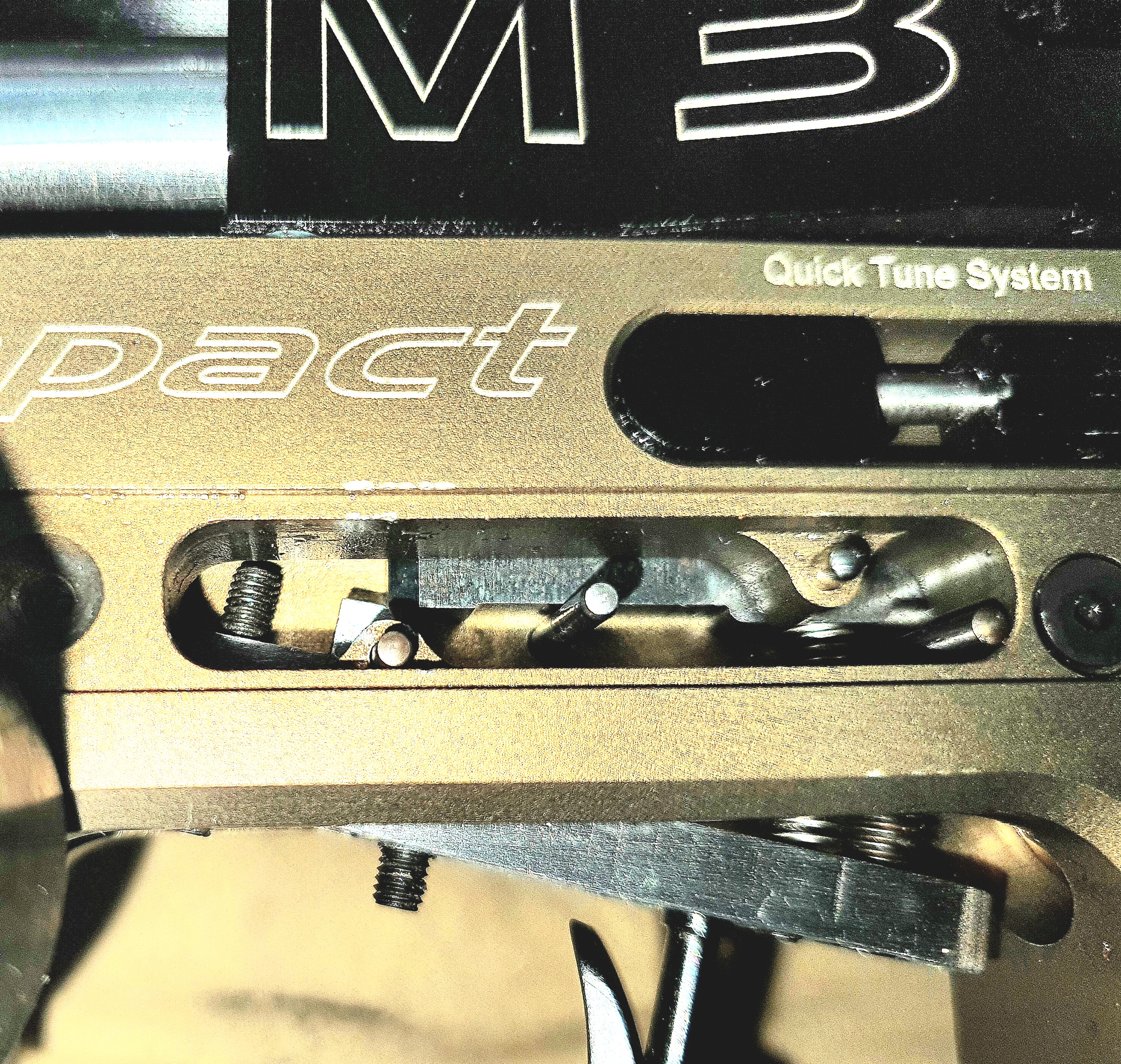

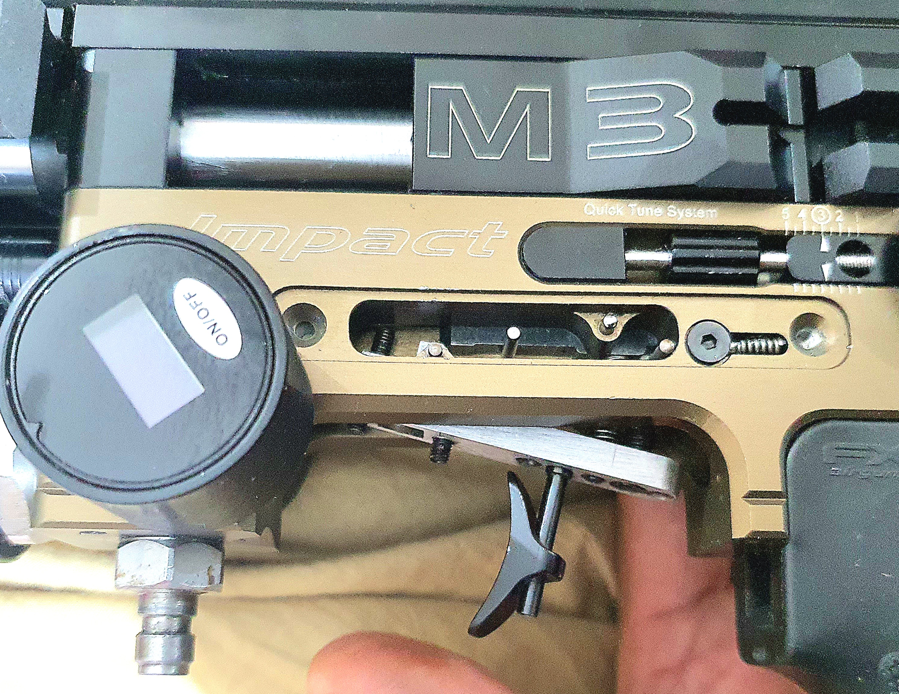

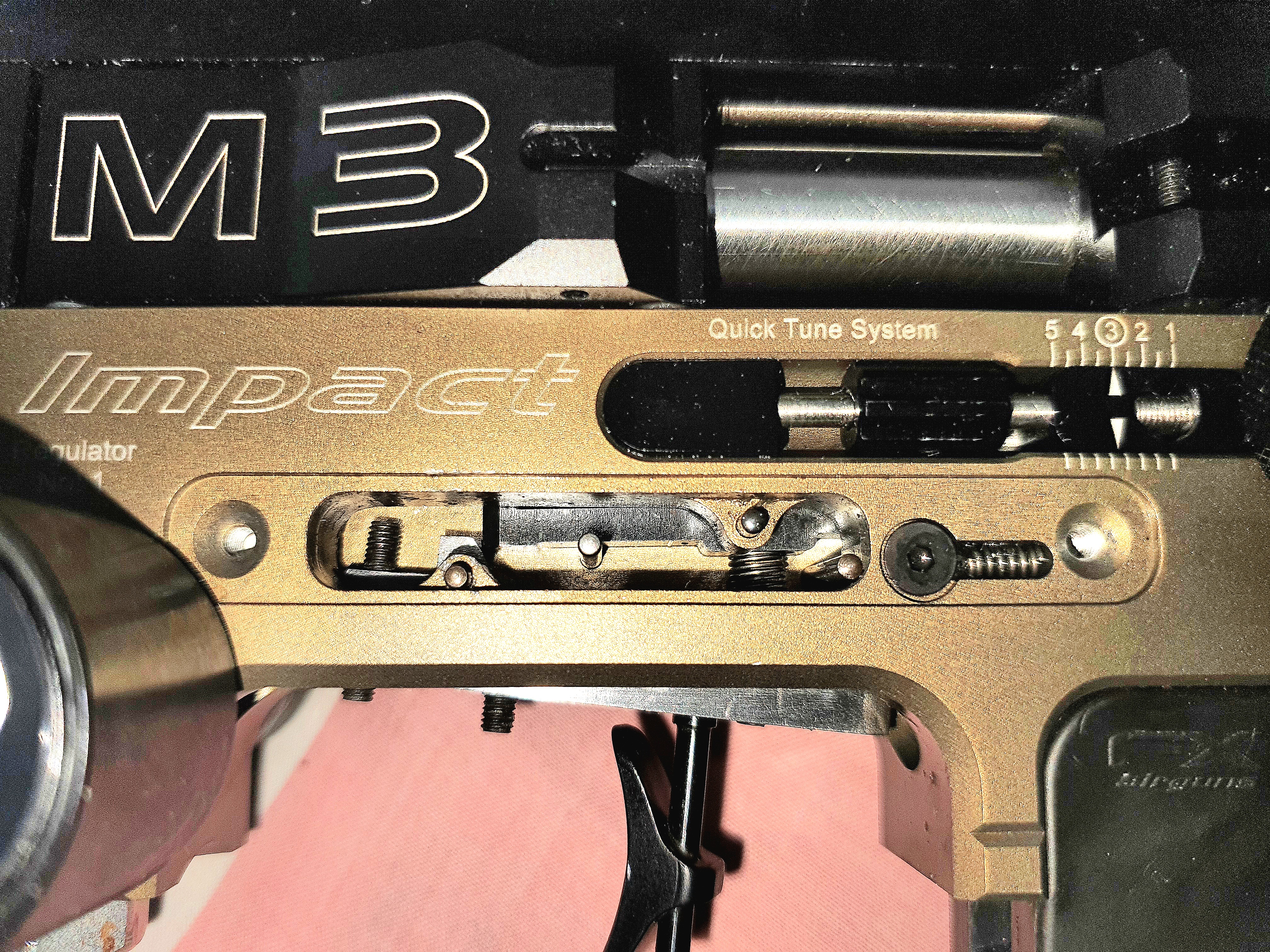

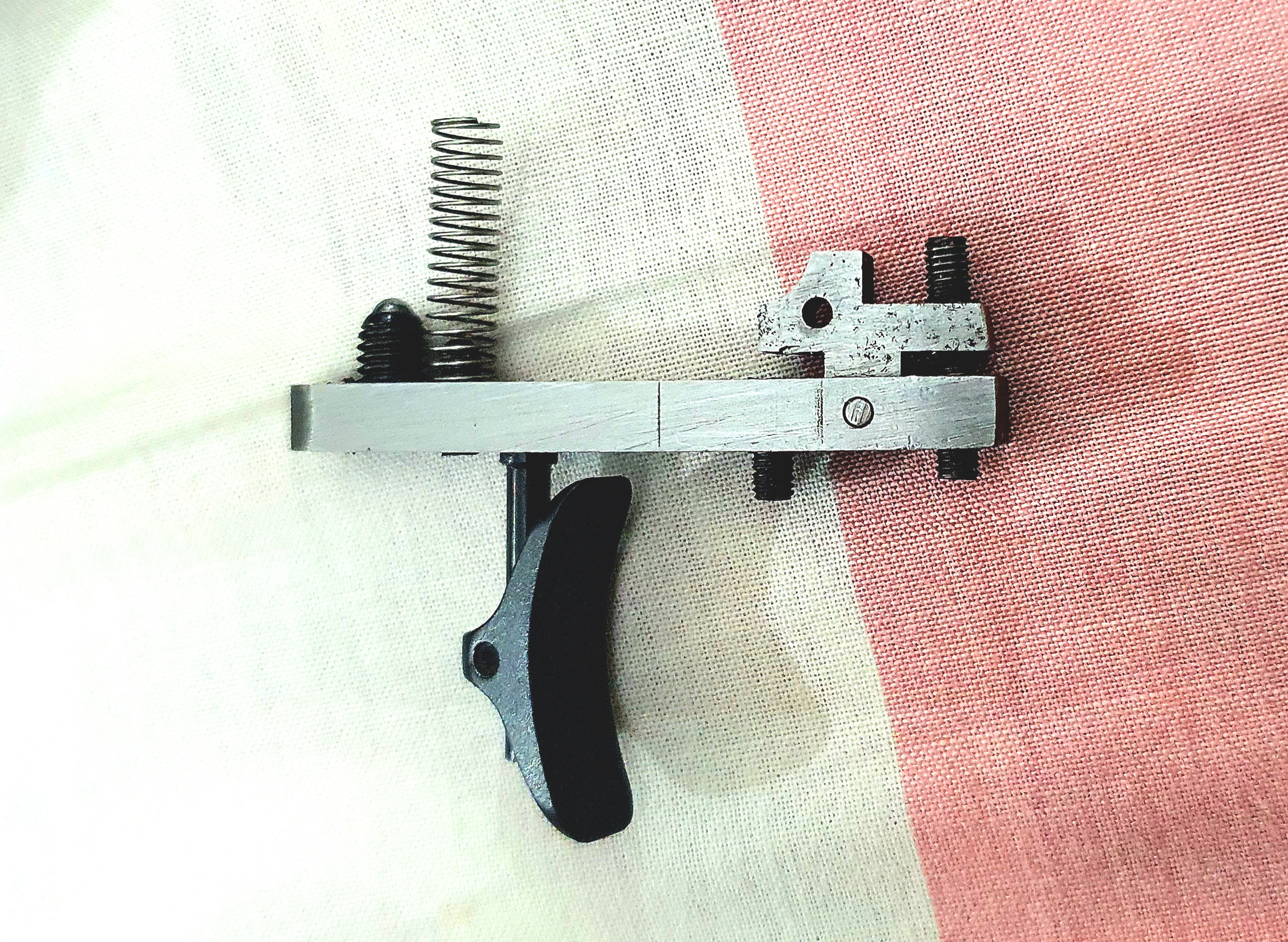

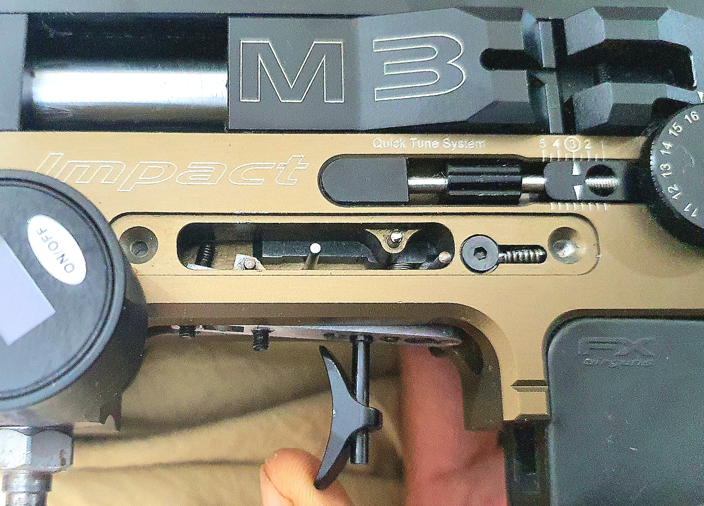

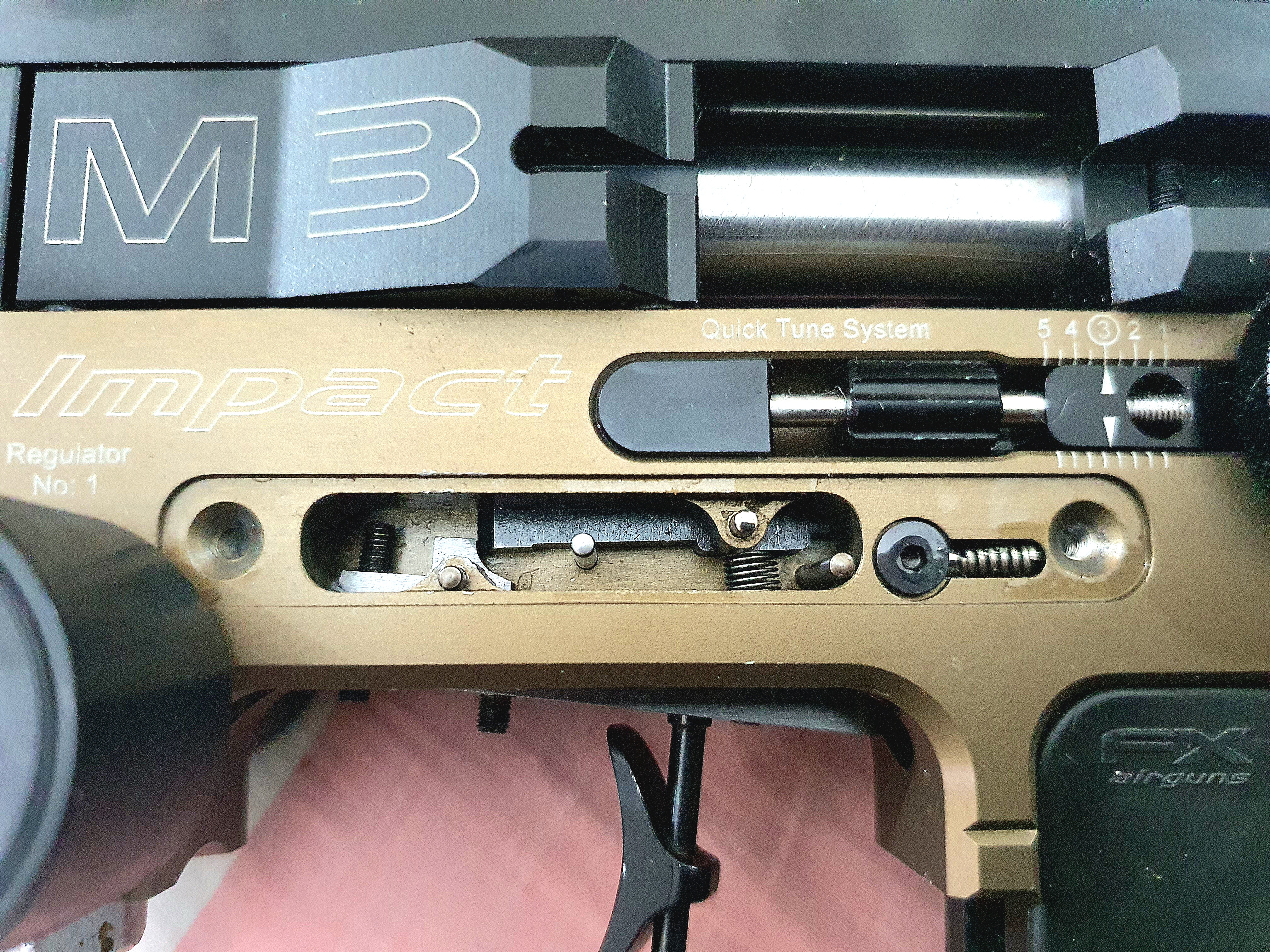

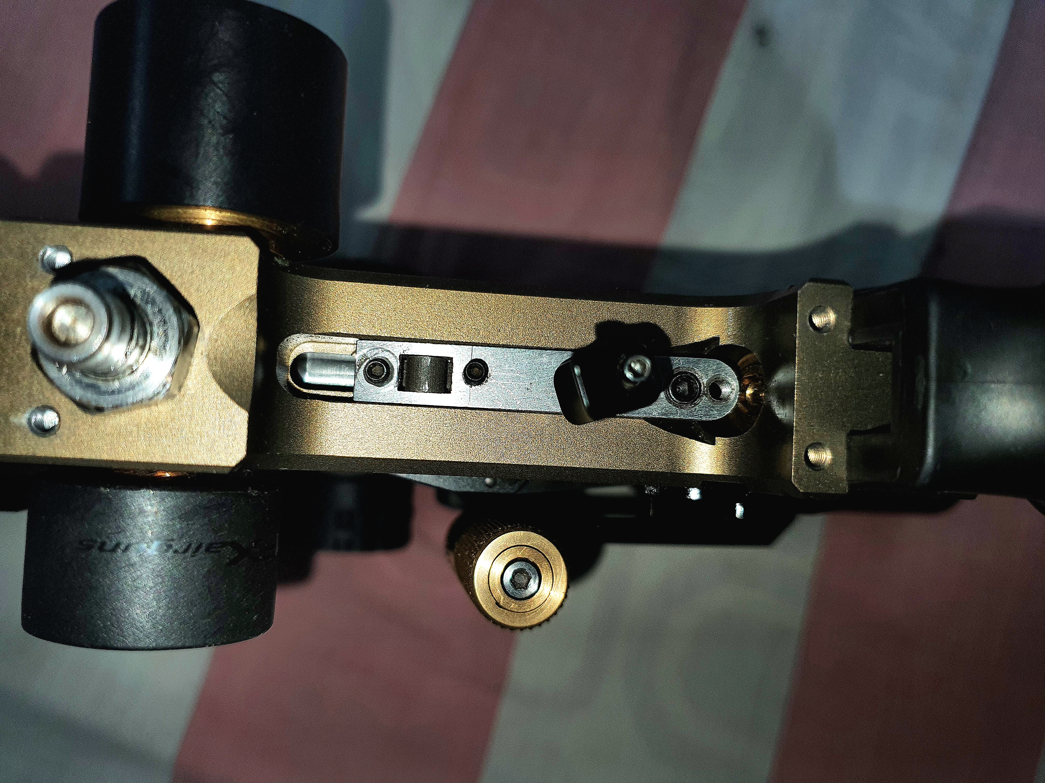

Fx Impact is the PCP of this modern time with most good things like external adjustments, high power and accuracy.
I always kept and updated my FX Impacts. Right now I have M3 in which I have done a few improvements.
To me the main deal breaking from go to gun had always been its trigger.
Sorry to say but Technically not a match grade and not a real two stage trigger.
For some reasons trigger is one of the most important things for me.
I always scratched my head to find a way to make it as good as I need.

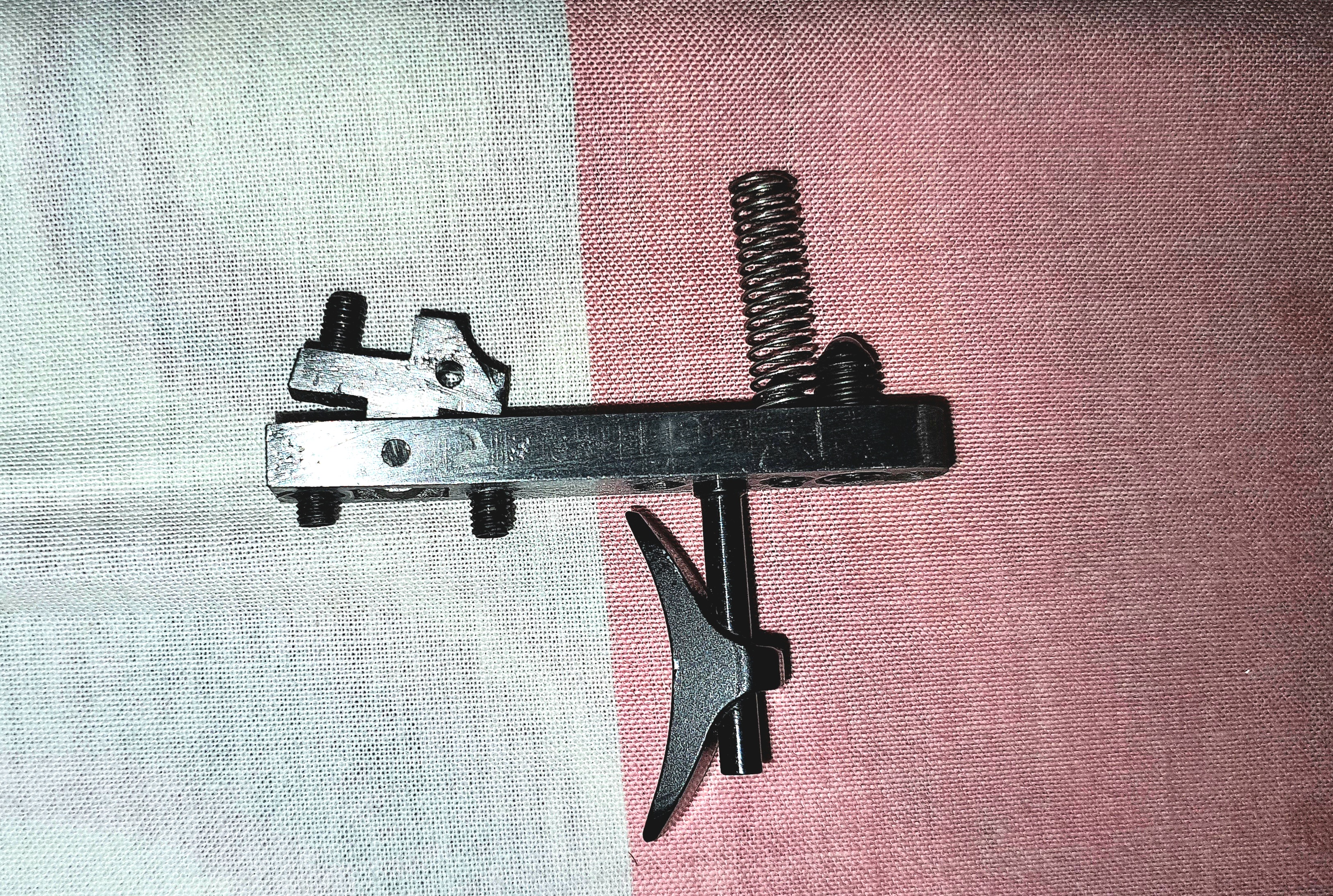

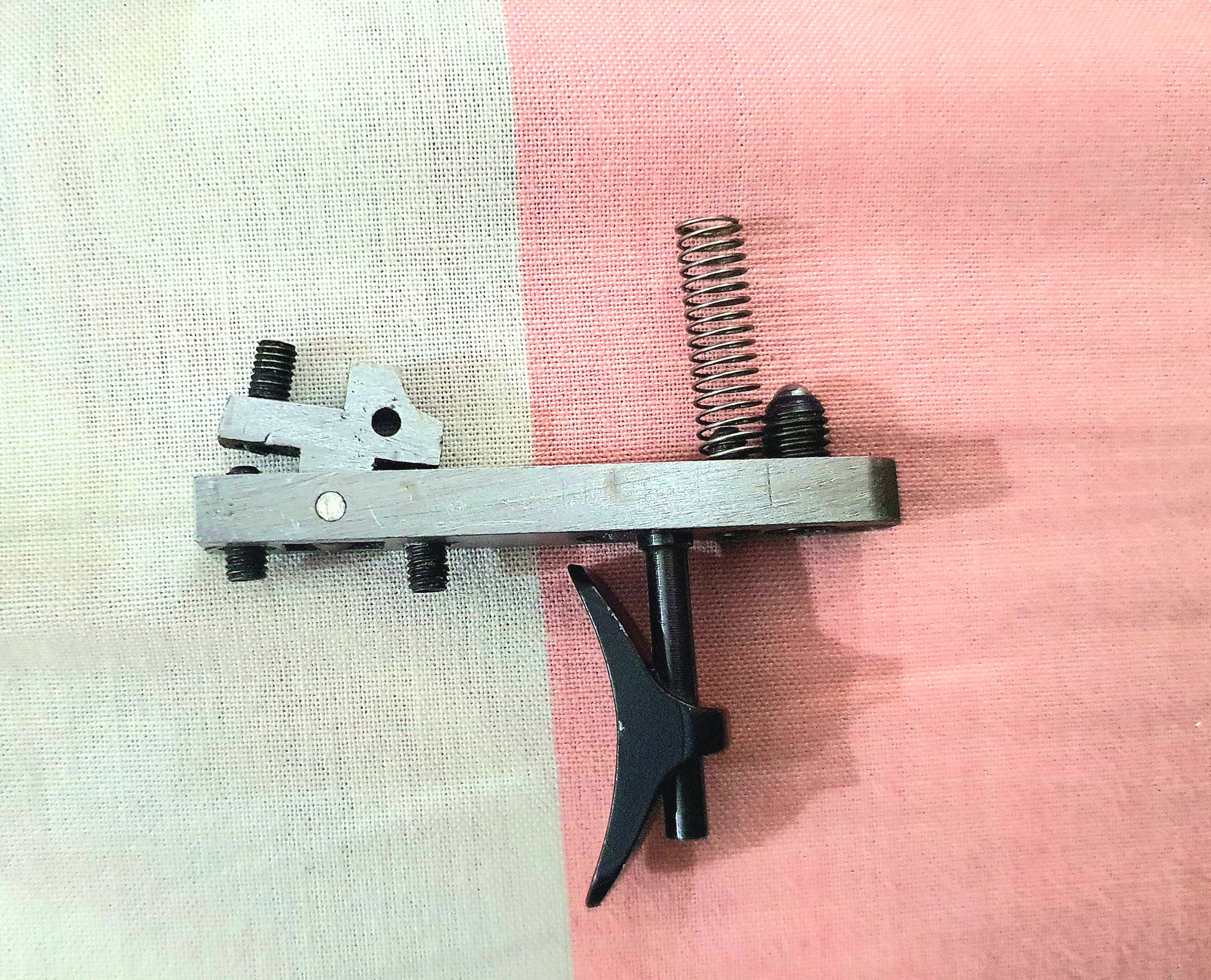

While discussing this matter on the forum and myself designing some triggers drawings, an idea of another airgunner clicked me but he had only drawings and never tried to make it.

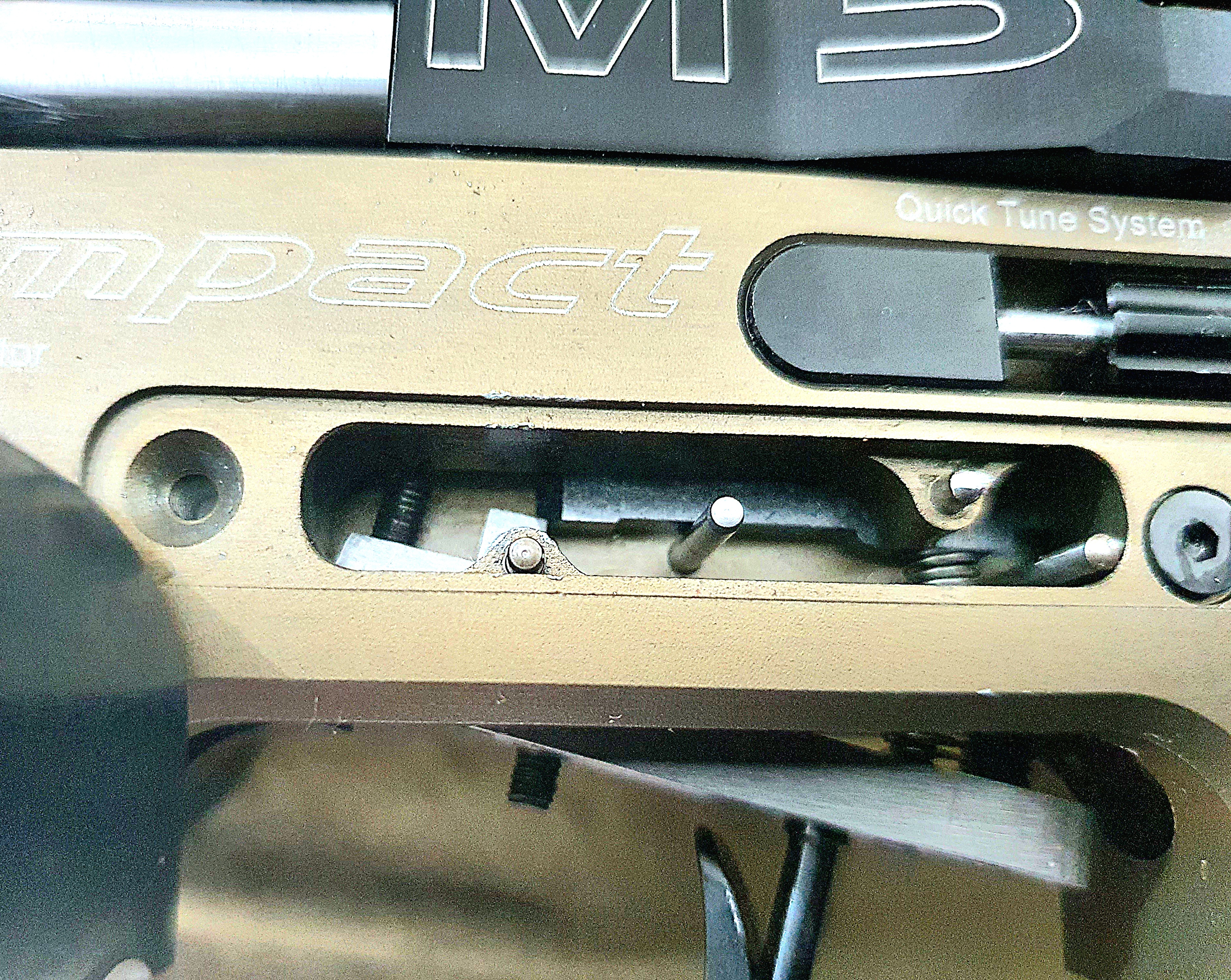

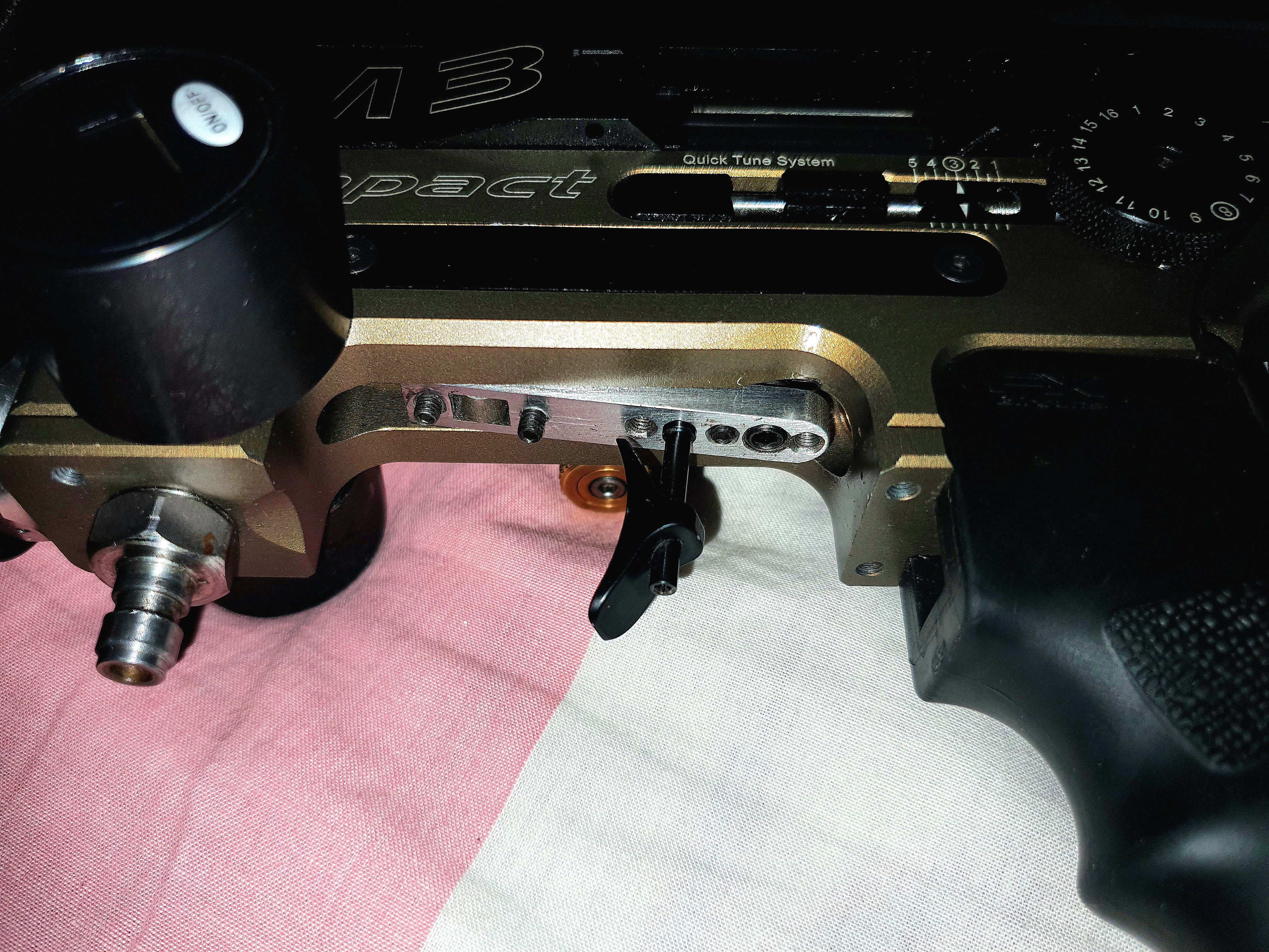

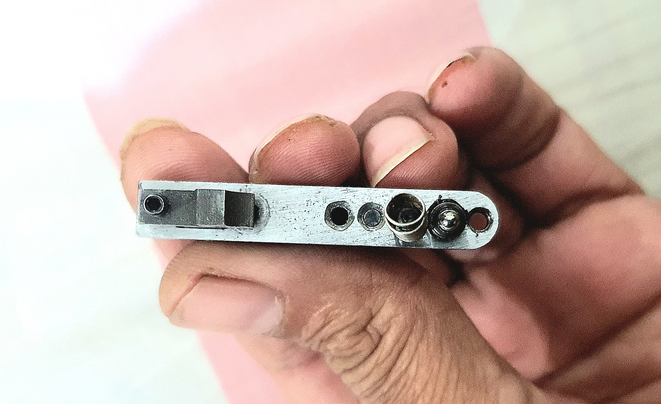

I plunged into it and with my own input in his drawings I made some parts of the trigger.
After a long time and cost of R&D finally I have achieved a very nice 1st stage around 2 ounces and 2nd stage is adjustable that right now I have at at around 8 ounces.
The good thing is that the trigger alway come back if I don't pull it through the 2nd stage and let it go back to reset for availing 1st stage again.
The 2nd stage adjustments do not affect the first stage smoothness at all.
Still a long way to go to make it better and better. But for now this has made Impact my go to gun.
I wish Fredrik you could use this style or any other better way to make the Impact trigger a perfect target trigger like HW100, RAW and some FWB guns.
Following is my work in pics.
I plan to also make YouTube video on it for better understanding.

I think I like it but to us no tech guys it would be nice if pictures had the details denoted. Especially for the amount of work you have put in too it.
Tim
Thank you.
Really a lot of work and a number of set ups with a bit different angles.
It's not my own product, normally me and my machinist both work on the ideas.
Mostly where high pressure air is involved then me, a mechanical engineer and the machinist are involved.
But for this trigger me and the machinist did it all.
At a stage we felt it is not possible. But suddenly some adjustments that we made did the magic for us.
It's not perfect yet but I am very comfortable now.
I think that FX can do something like this on same lines and give us a more refined product.
Why YouTubeer showing FX guns don't discuss this matter, I am unable to understand.
