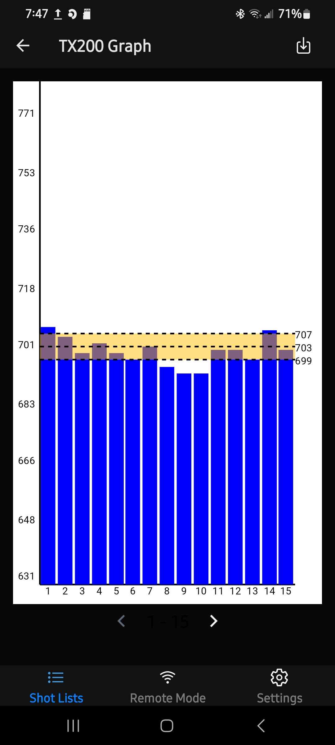

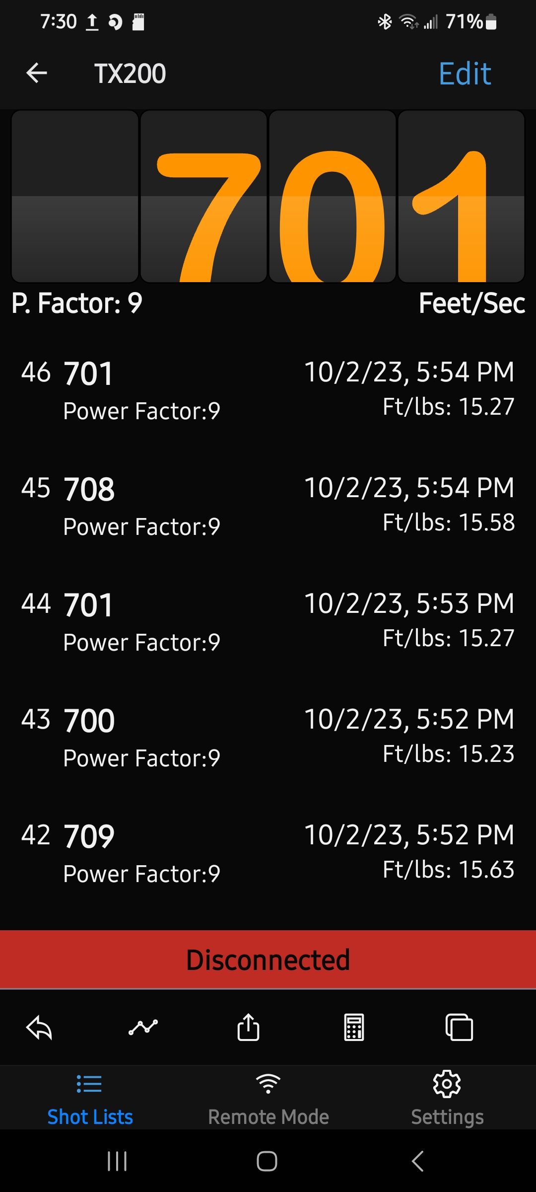

My TX200 22 cal was brand new at the beginning of this month. I was shooting Crosman Premier Ulta Magnum 14.3 gr. As the gun breaks in I'm not sure what will happen to these numbers but right now they seem to be very consistent. This springer is about as accurate as it can get. Beautiful gun! :>)
