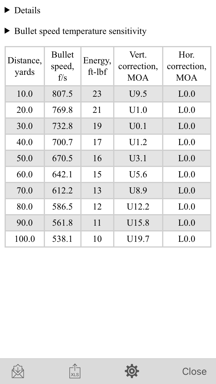

Didn’t check americanairgun chart but this is what StrelokPro shows with 16 gr. pellet
B
