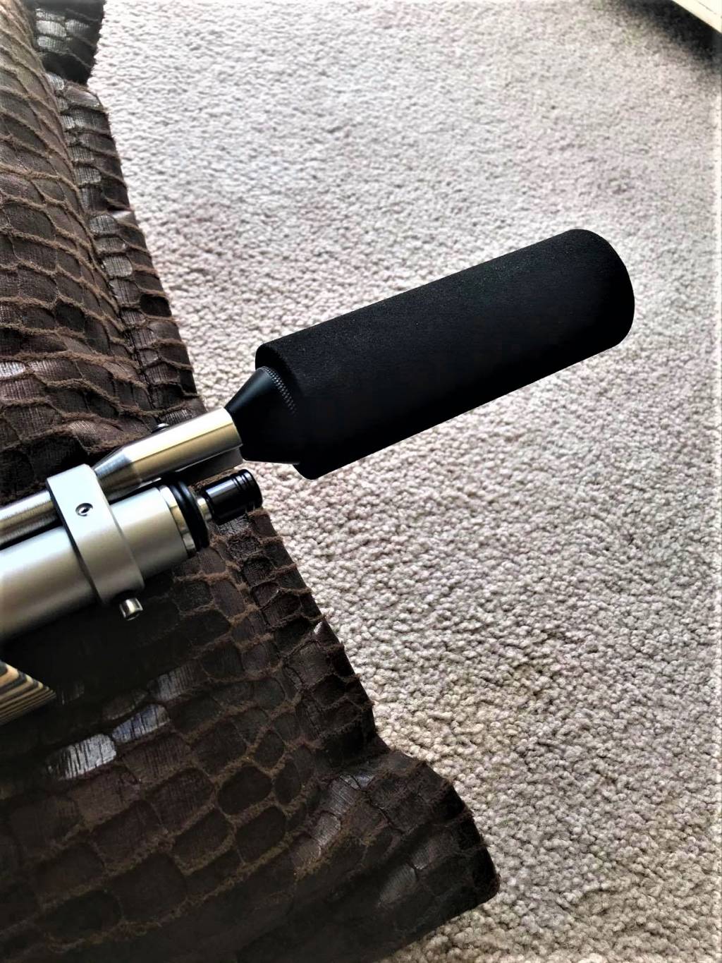

Moreover, I also prefer the fill probe assembly being sold by Archer Airguns--I chose the one for the Disco (dual groove and stainless) and not the PROD (single groove and of weaker aluminum construction).
I bought one for my custom Disco-based Don Cothran 2260 PCP, and I was pleasantly surprised that it only had 1 O-ring groove, thus shorter and translates to a bit more air in the air cylinder.
It is also made of stainless + the nipple is not removable but machined along with the body; ergo, like a single piece to negate another source of air dribble.
It looks much cleaner, too!
