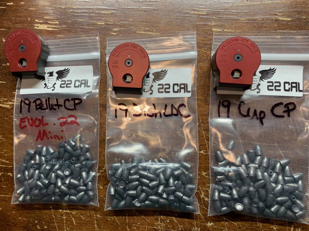

I'm running out of US slug brands here...... Been looking at Griffen for a while but took a pause with their LDC and stuff because I don't hunt..... Past weekend decided to order a variety in .177, .22 and .30...... They arrived today - YAY!
Looking at the .22 slugs I got 3 types in 19 grain. My EVOL is tuned for JSB 18.1gr @ 875 fps right now which is giving me 3 solid mags on reg from a 4000 psi fill with about 2-300psi remaining before I hit reg pressure. That works out to ~54psi used per shot for 38-40 shots on reg at 30.75 fpe from a 135CC air tube. (Shame on you Brocock - I could only get 70 freakin shots on reg at 30 fpe from a 480cc bottle). Do I digress? Yeah - I am prone to ramble and do that. Focus! I choose the 19gr so it would be close to the tune of the EVOL.
For testing I got:
- .217 Pellet Base, Cavity Point
- .217 Dish Base, 2 Stroke LDC
- .217 Cup Base, Cavity Point
