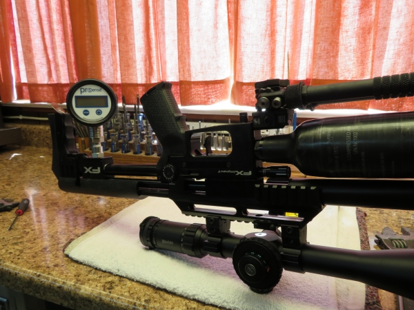

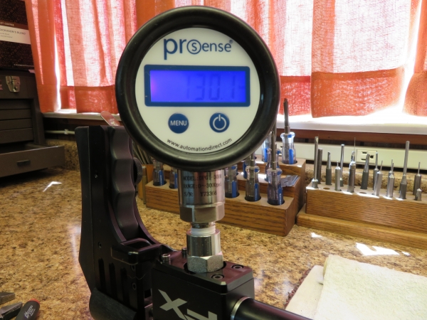

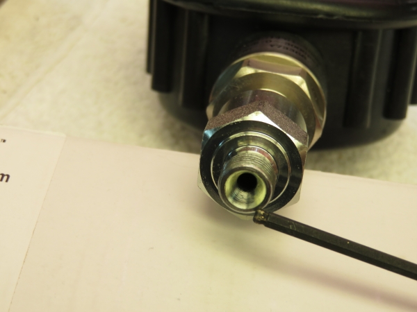

I wanted to get a true reading of my regulator on my Impact so I looked into a digital guage. I found one for $100 dollars and it included free shipping. It has a 1/4 npt male end I found an adapter 1/8 bss to 1/4 npt for around $10.00 dollars . The Gauge was from www.automationdirect.com the fitting is from www.hydraulicsdirect.com. You will have to take a little off of the bottom of the fitting so it will seal well. I used a lathe but you could use a file just keep it square. I found that my FX guage is off almost 10 bar.
I'm kind of a tool junkie was going to buy one of the super expensive ones but didn't feel I would get the use out of it to make the price ok. So I started looking for a cheap one. I found these and did some research on them. Found a lot of people who were very happy with them. It took a while to find an adapter from British to NPT but I did and had everything in a week. However if you order one I would get the 0 to 5,000 PSI They are the same price. I bought the 0 to 3,000 PSI it works but would have liked the higher pressure guage then I could use it on my compressor.
