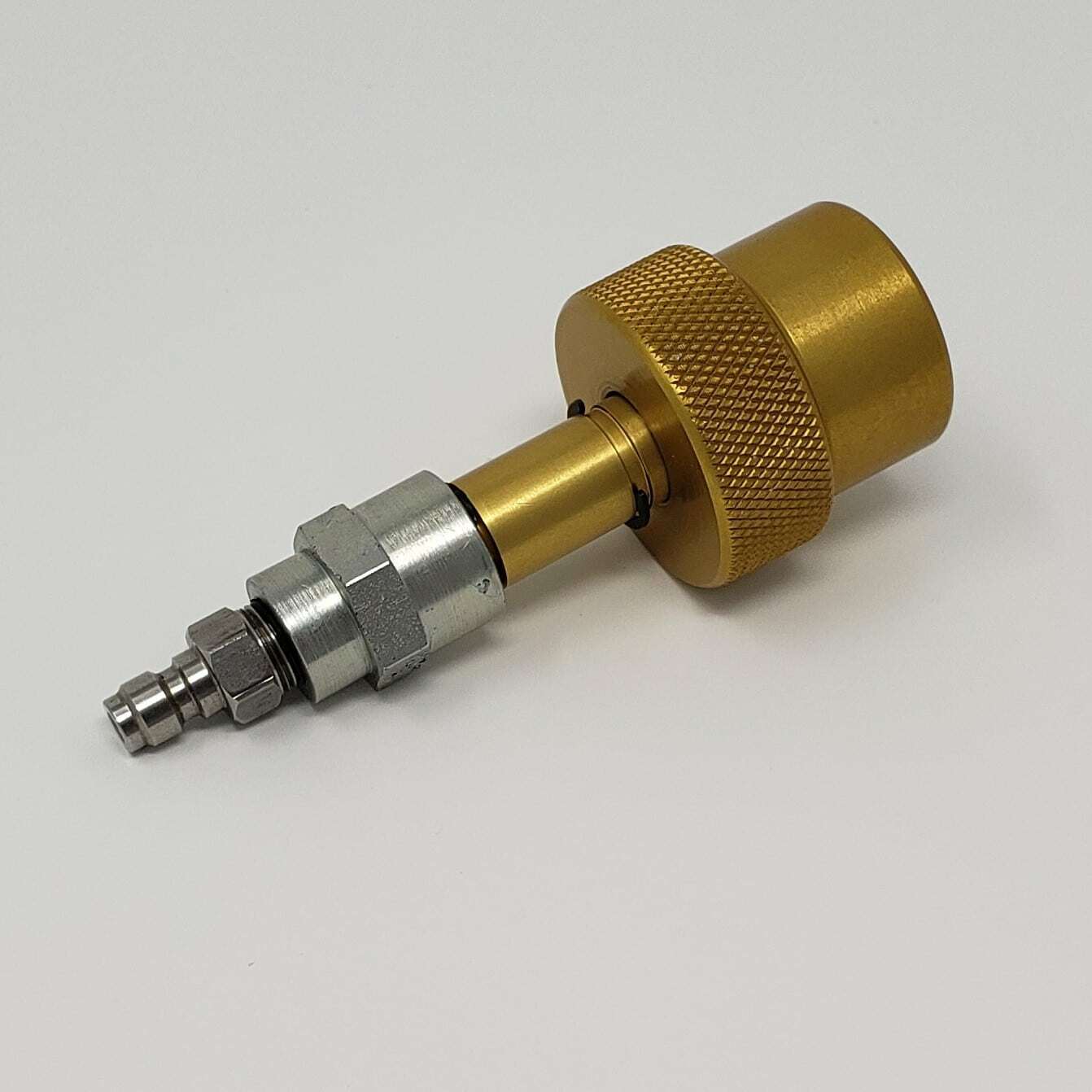

I found a good deal on a Scott SCBA and I have a question. My Alkin has a female foster on the fill line. I found what I think is the adapter I would need to fill an SCBA tank, but I wanted to post a photo here and confirm that this is the correct adapter I would need. Thanks.

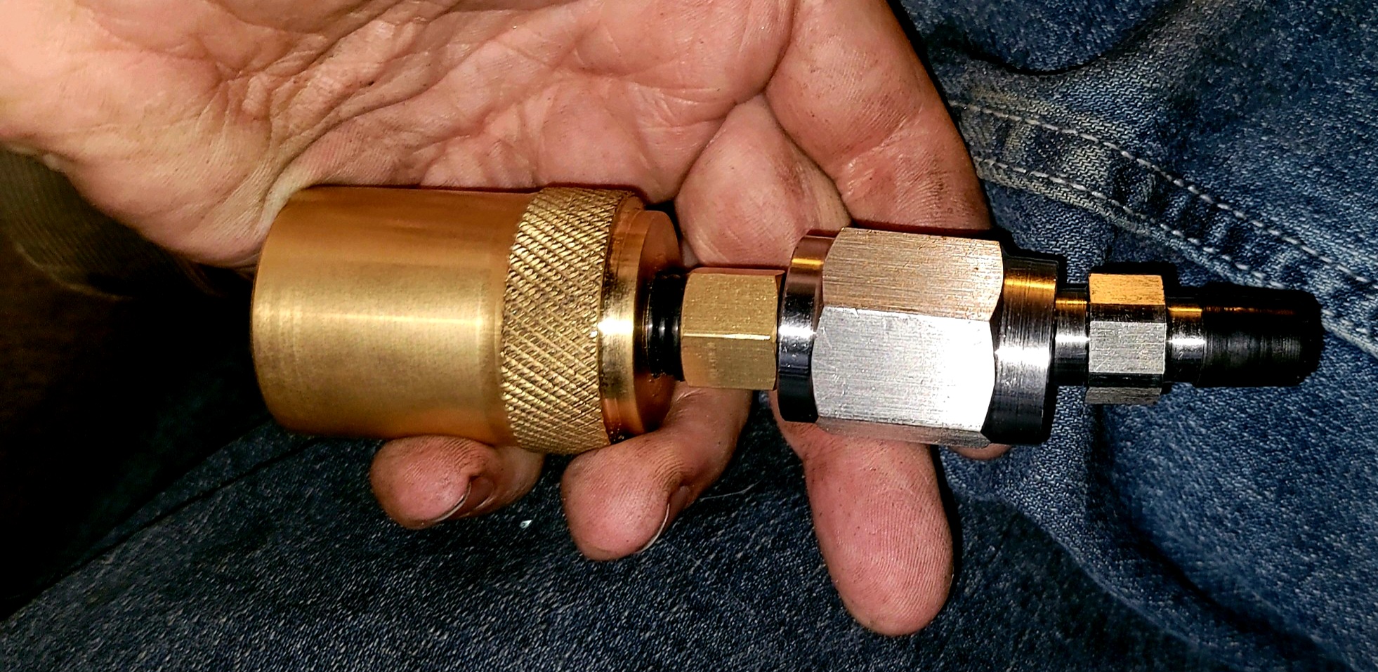

I broke down and ended up making my own adapter. 😊 Couldn't find anything to connect my Din 300 to SCBA. Actually, I did... I'm just to cheap to pay someone for something that is clearly over priced just because it says SCBA on it. Like buying something for a boat... 😁
C360 Brass, Hex C360, Hex Stainless, Black Delrin. Took about 45 mins to make as I was designing it as I went down that rabbit hole. 😂

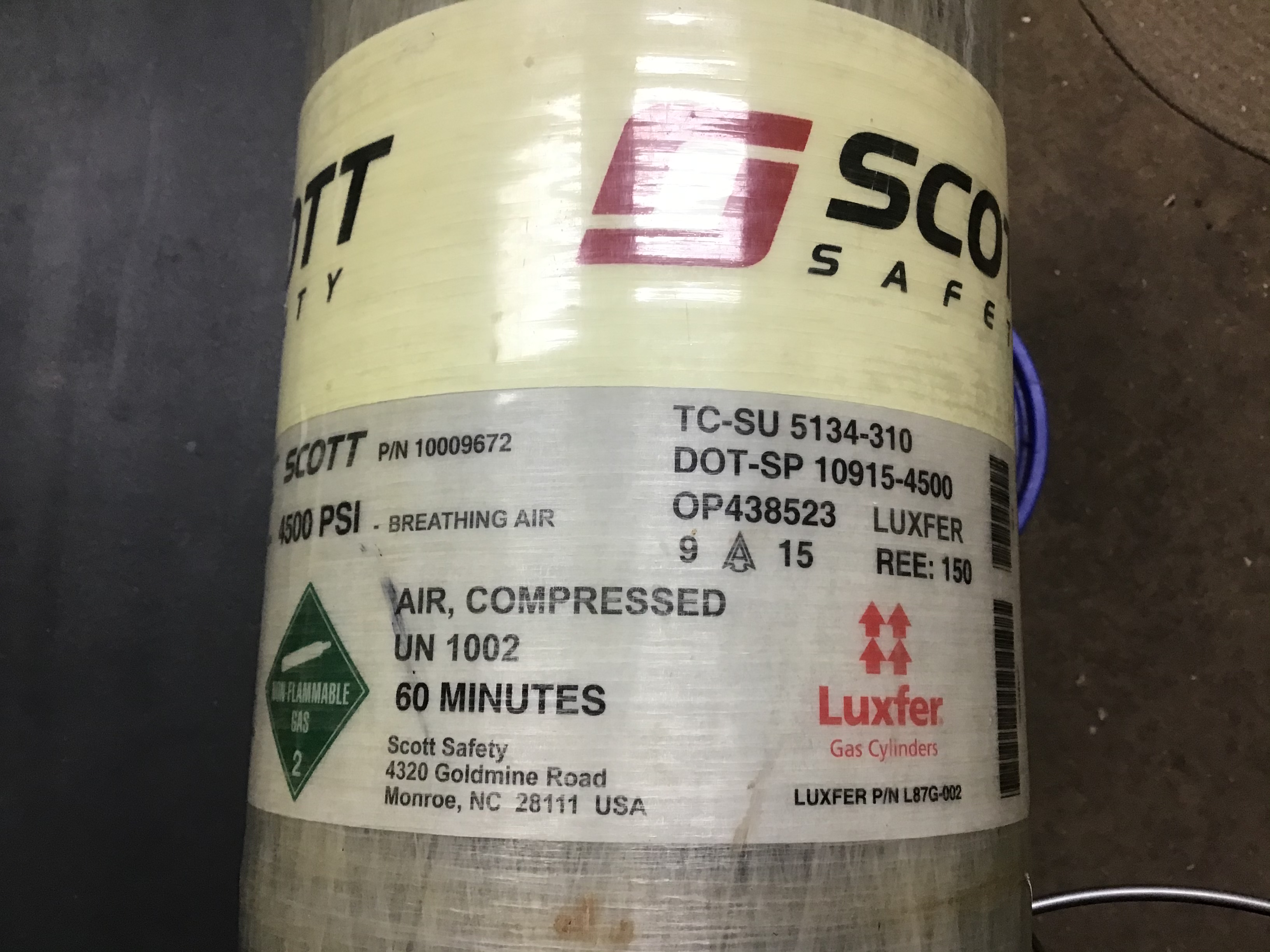

As for 60 minute tanks, I picked up 2 off of facebook marketplace — DOM 9/2015 Paid $280 to my door for the pair. I thought I did pretty well for tanks with 7 legal years left on them. They actually never been hydro tested other than when new. They even have glow in the dark labels...

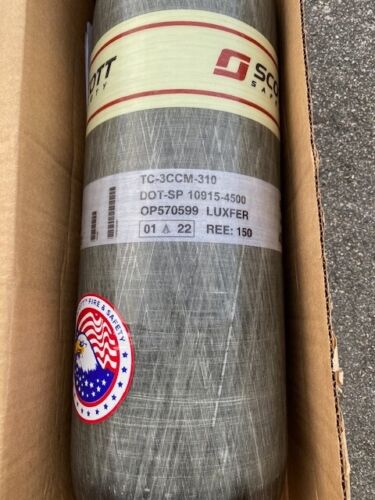

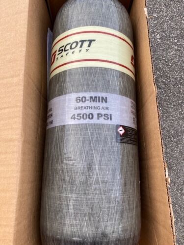

Well, I'm excited to say that my ebay gamble on a "new in box" 1/22 60min Scott tank was legit. Just replaced the valve with one of Joe's and all in I'm still under what I would have paid for a new 98cf tank from Joe, Omega, etc.. So I guess leprechauns do exist if you dig deep enough on Ebay.
Filling her up now.
Edit: As a side note, the Alkin filled this 60 min tank from 0 to 310 bar ~26 minutes.

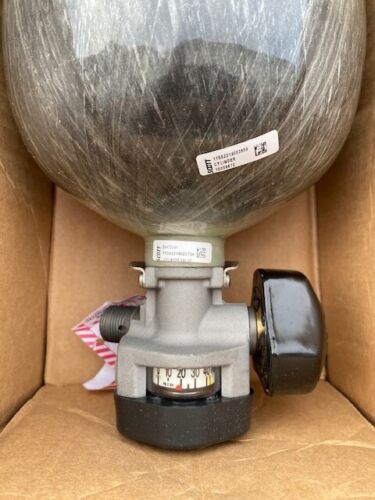

Curious why you felt the need to change the valve?
Those scott valves are extremely controllable and, in my opinion, very nice.
My alkin has the female foster fill line. By the time I priced (decent) adapters to fill the tank and then my rifles, I just went ahead and bought a valve. I really like the slow flow, dual gauge valves that Joe has. Just easier for me.
