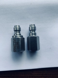

I have found that these connections vary slightly from manufacturers . If you look at and measure the male components clearly there are minor but significant differences. I’ve been buying and using connections from Best Fittings UK. A little more expensive but where possible I’ve switched out the male components. I’ve also carefully reshaped them to allow the female extended quick disconnects to slide into place easily. The male connection on my FX is tight compared to the daystate products
Here is an example. You wouldn’t think there is enough of a difference but the best fitting goes easily into the female and the one on the right just binds up
