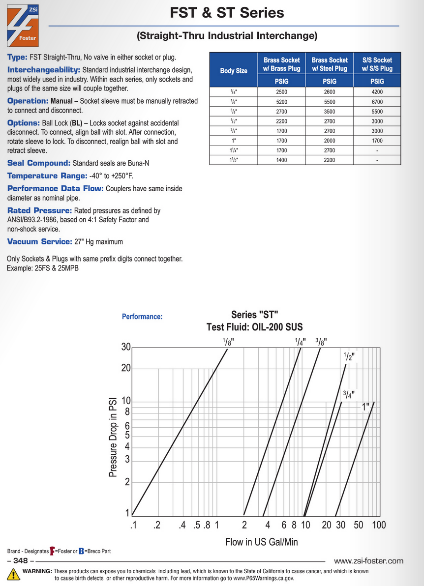

When people refer to the "foster" fitting is the true specification the ZSi- Foster FST fittings?
https://www.zsi-foster.com/fst.html

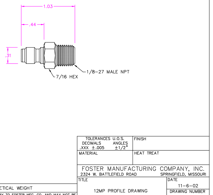

This 12MP looks very close to what is used.(at least on the QD side)
https://www.zsi-foster.com/mm5/graphics/profile/FOSTER-12MP-PROFILE.pdf

BTW look at the pressure rating of a 1/8" Size Mated with a brass Socket. Lets be glad its 4:1 safety factor.
