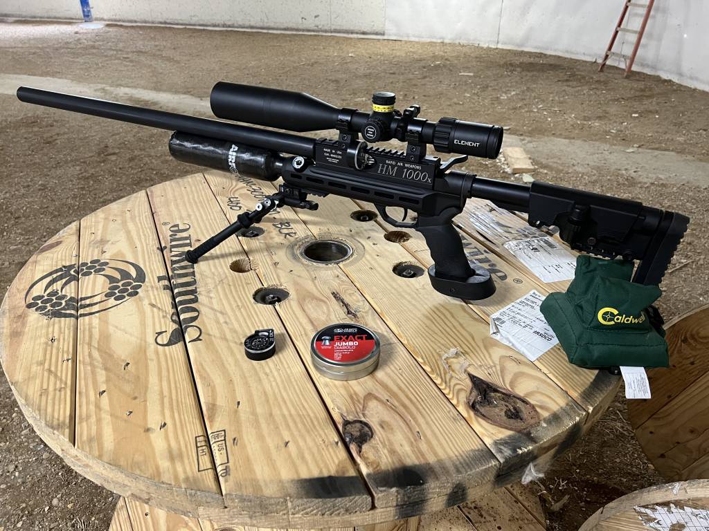

 AZ full barrel shroud with intergrated suppression. It’s roughly 8” longer than the barrel. Shooting 18gr jsb’s at 900fps…it’s sounds broken. Quietest gun I’ve ever shot.
It also makes the barrel a lot more solid. As it’s a one piece alum tube with cuttout for barrel.

Who makes that aluminum shroud / moderator set up? Where was that picture taken? It looks like you are in some sort of indoor arena?
Allan zasadyn does the shroud.
This in an empty barn on our private property, we have used it as a hockey rink :)
Corny, Alan does make the most quiet suppression for RAW's! I would send mine to him but it might take months to get back and I'd definitely go into withdrawals not being able to shoot it! LOL! Although mine is very quiet, hence why I haven't sent mine to Alan. I envy your ability to shoot so far at your farm! My home range is only 20yds...LOL! But I do get to stretch her legs out at a friends place, he also has access 24/7 to a private range and we hit permissions for ground squirrels and starlings...luv these RAW's!
