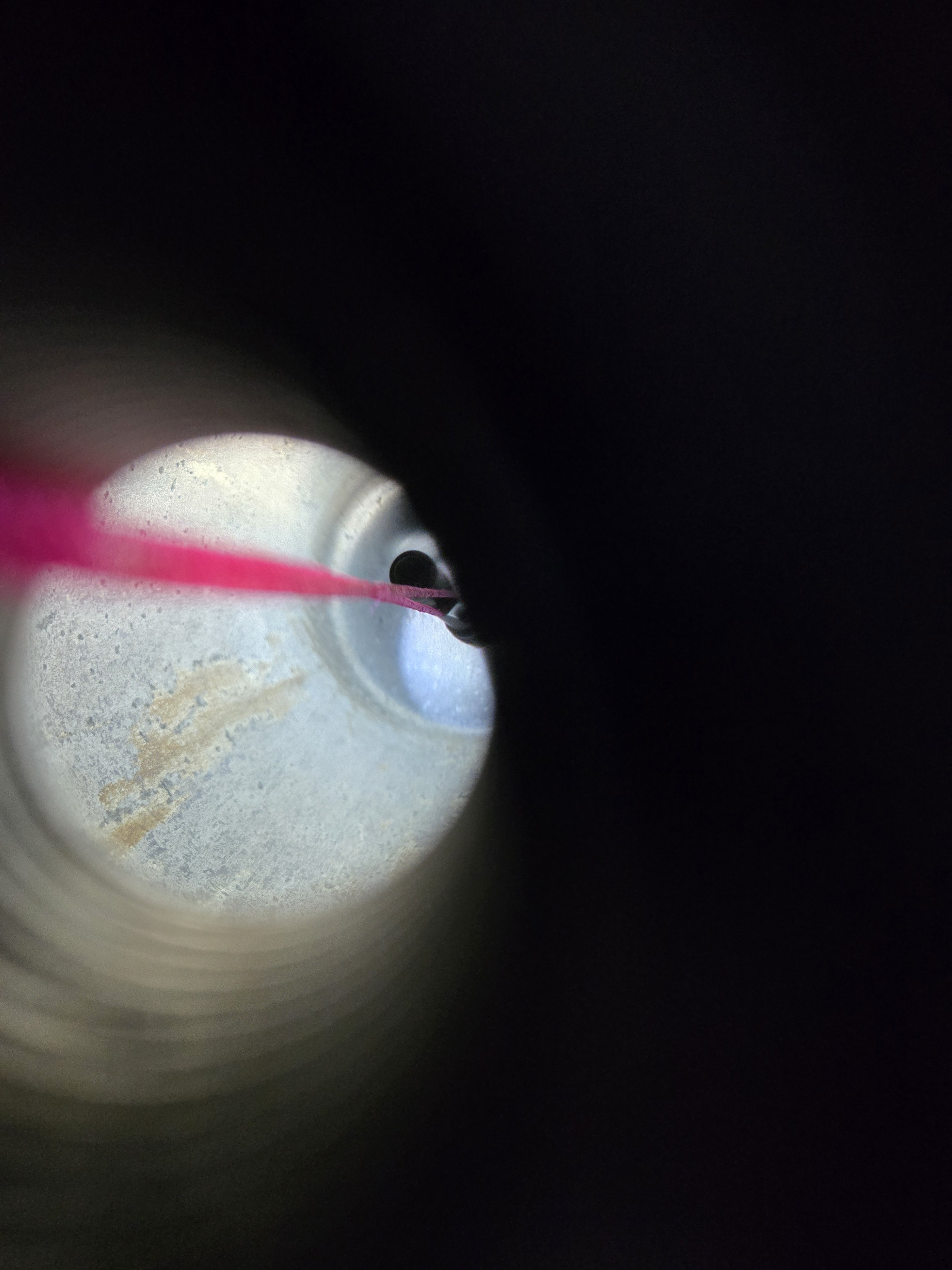

For you "I fill my own tanks" PSA
I don't want to come across as too preachy here , but it needs to be mentioned again and again ...............................control the moisture output to your tank or airgun..............
Compressing air extracts any and all moisture from it.............WATER............... Unfortunately , water and highly compressed air = BAD MOJO for the aluminum liner in your tank and
airgun . I have purchased and sold a bunch of tanks and always remove the valve and take a peek inside. If it looks sparkling new and shiny , we're full steam ahead . Should there
be any oxidation (rust) or signs of contaminates...........a no - go . So far the only issues I have found are moisture contamination in a couple of tanks.............they will not be sold...
The liner is the vessel that contains the compressed air , the carbon fiber wrap is what keeps the liner from becoming an overstretched balloon and rupturing . This is why you never
read about exploding carbon fiber tanks , only on occasion an aluminum tank.......a couple of years ago. So my lesson is to control the moisture and keep your tank and airgun happy
and functioning the way that you expect . Lesson over . Here's one tank that is now a paperweight..........

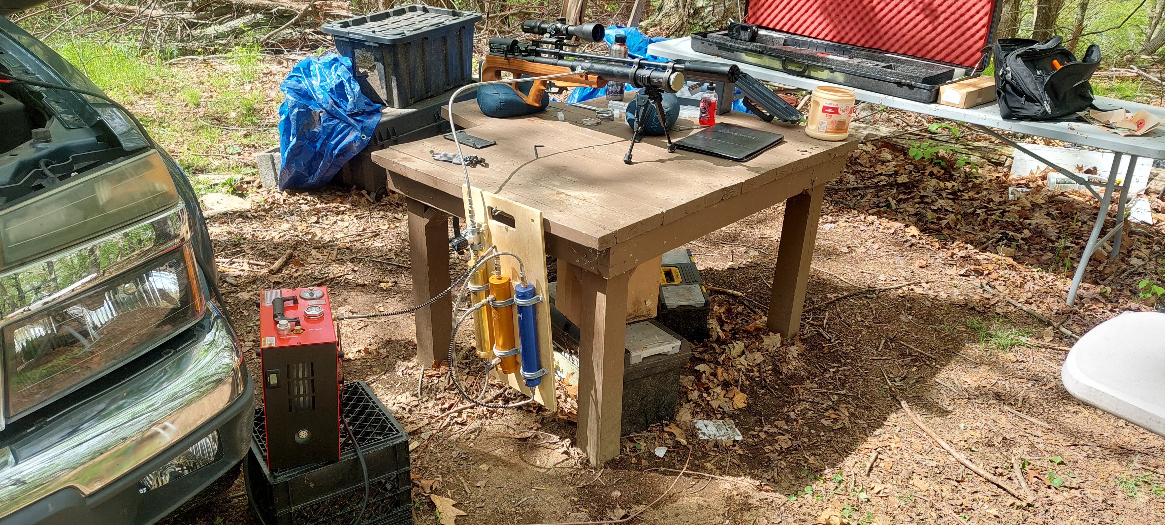

Was shooting on my range this morning after it rained overnight, obviously lots of moisture still in the air, but no worries. Checked silica beads after coming in and barely any change in 1st 1/2 inch after shooting 100 rounds.

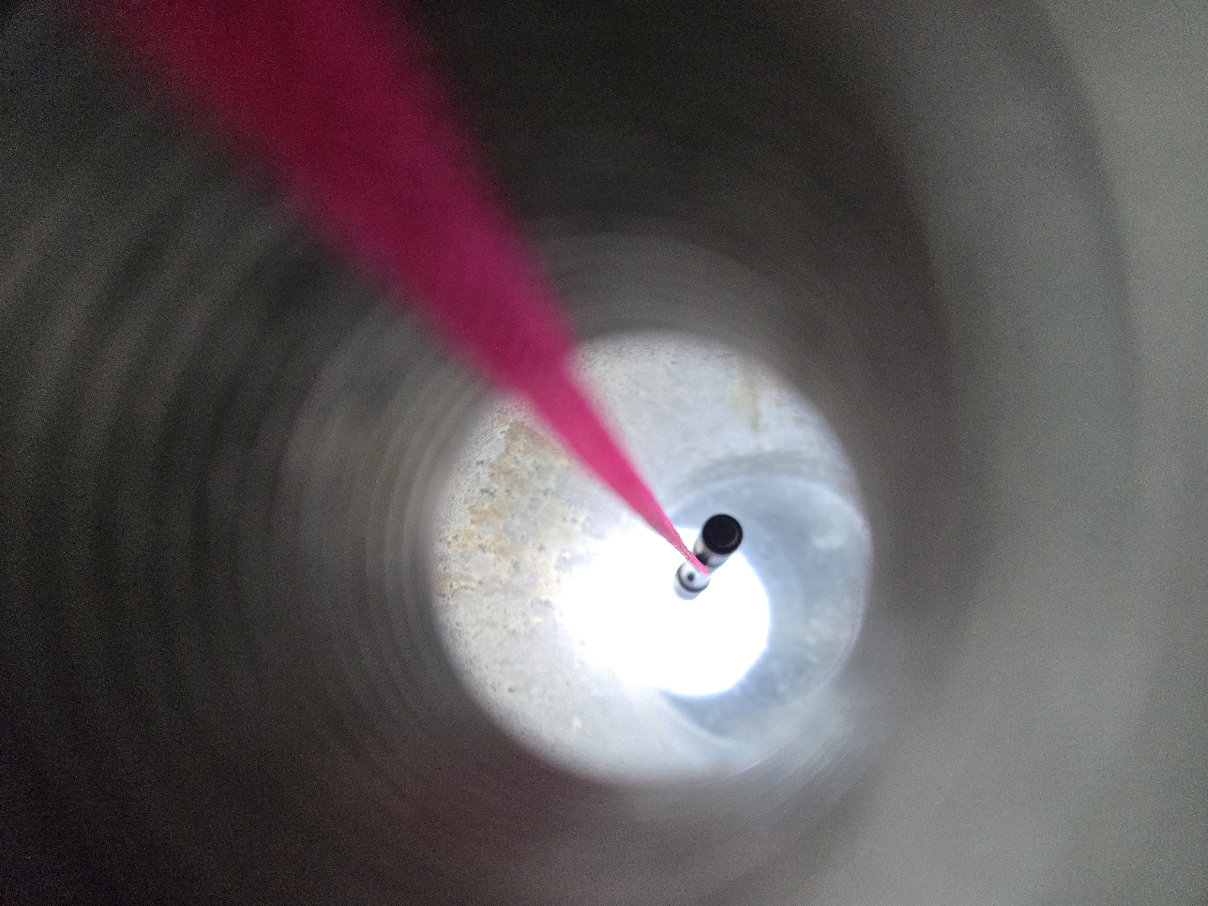

Changing valve / valve / fill station on my 9L tank i did stick a bore scope down inside it, and saw what i would assume a bottle should look like on the inside, but this 9L bottle also only seen 1 year of use until now.
So bottles filled by dive shop.
Bottle filled by Viking airgunner.
And now bottles filled by myself, have no moisture.

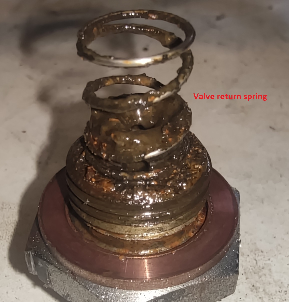

Mind you looking at the valve on the #4 stage of my compressor clearly indicate that something pass by there, this something also find its way to the vapour trap on my compressor, but the drain on the filter just have air coming out when i "drain " it during fills.
Stage #4 return valve spring after 20 hours of use.

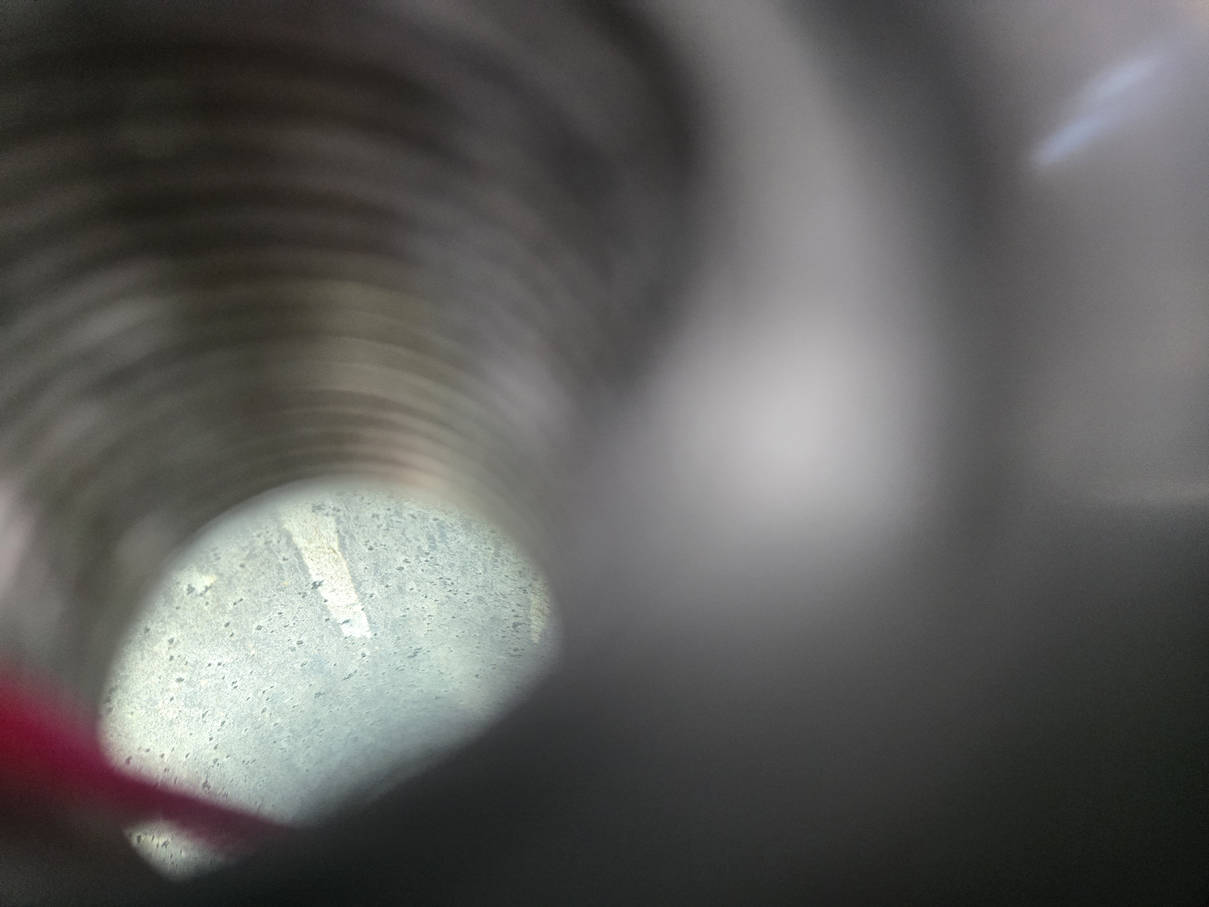

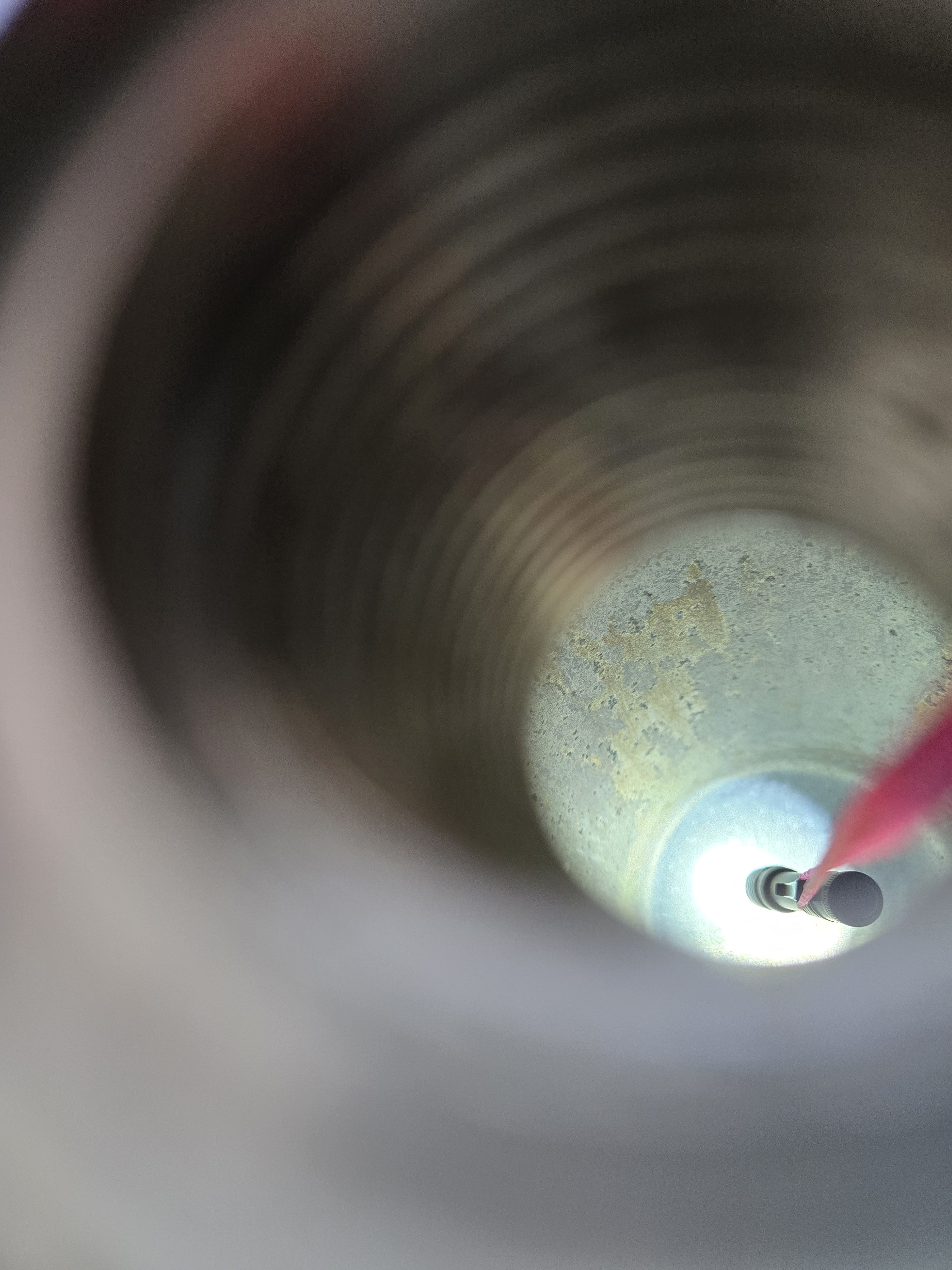

View attachment 560202View attachment 560203View attachment 560204View attachment 560205
Like your lighting solution .
I don't totally understand why or how water in high pressure vessels damages them but the pressure enhances the normal oxidation of aluminum which makes the oxide layer and also hydrogen gas. So the oxide layer is not protective enough at high pressure and the oxidation continues.

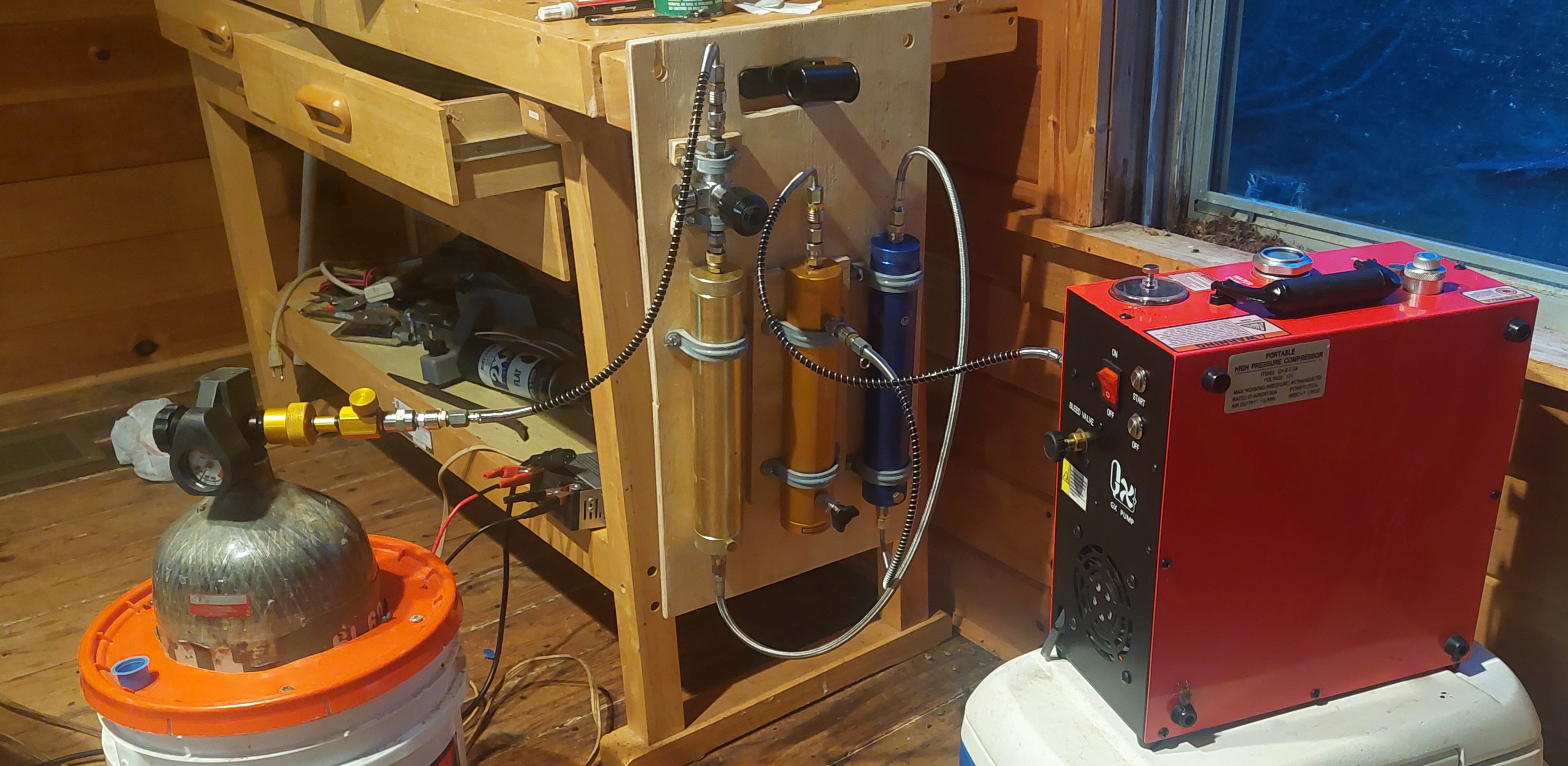

This keeps my CF tanks very dry. I have the cotton filter that came with pump, and extra desiccant filter connected to a .5l cheap 4500 psi Al bottle, and I use it as a catch can. That valve makes it easy to fill my catch can and tanks, and I always leave it at 4500 psi. Also helps with keeping air filling tanks cool, and I only loose about 100 psi after hours after filling. ✌️
