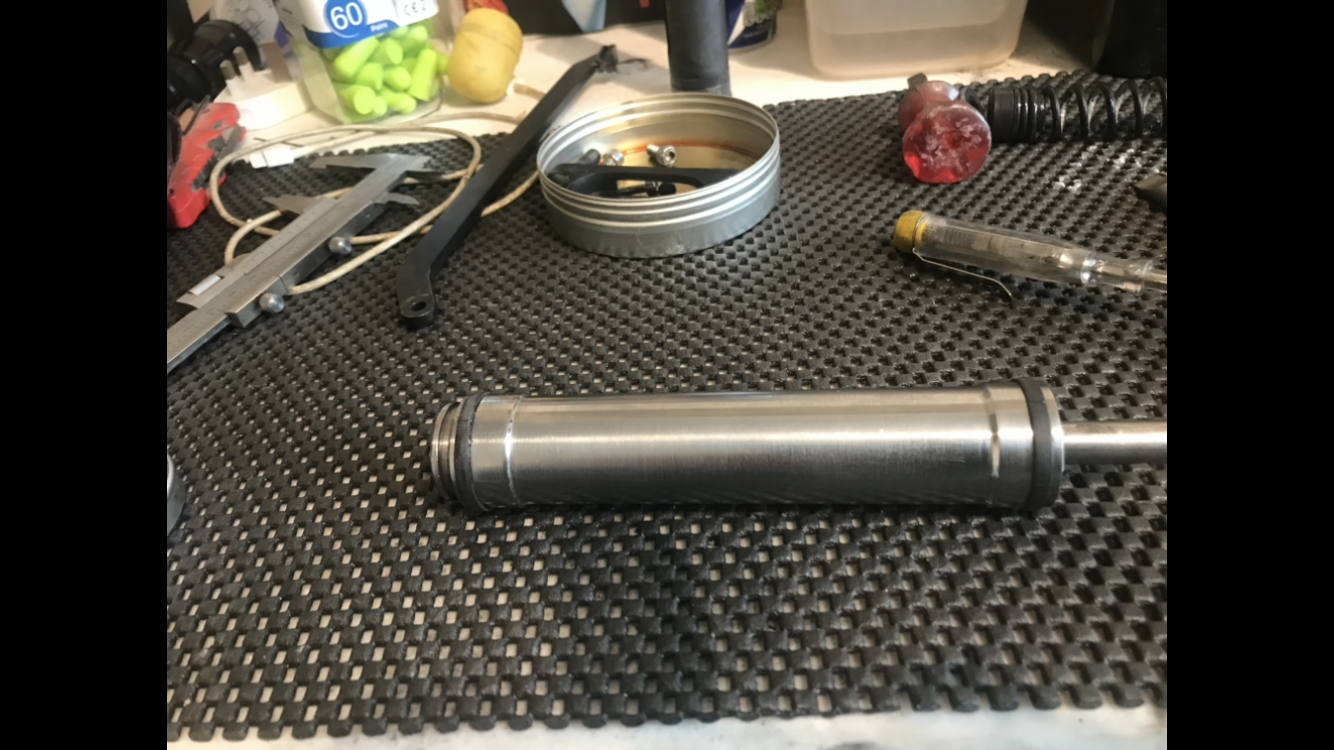

HW/Weihrauch for you DIY tuners
Can take a while if your adding buttons to the piston opening up transfer port etc
Hw 99/50 buttons

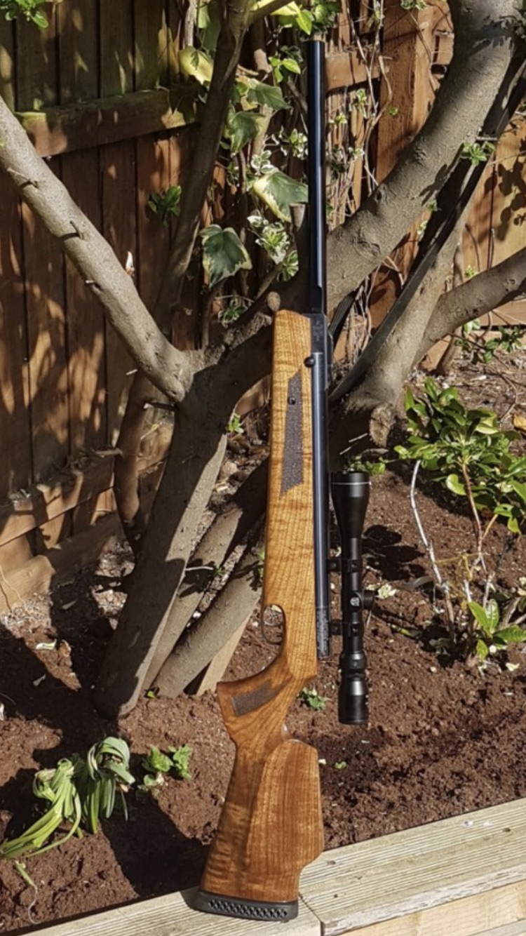

Hw 80 reduced to 225g /7.9 ounces
Yes mate
Adding the delrin buttons/bearings removes the metal to metal contact. My 99 like most had the galling problem from the poor design of the cocking arm . With this modified I decided to do the piston , you can see the witness marks on the pistons where they pick up on the cylinder. Hw pistons are slightly flared on the rear skirt to act like a bearing, you remove this so the pistons are straight then add the synthetic bearing so they run on that . It’s makes the cocking much smoother, keeps everything central, and you only need a fraction of lube . I use ws2 powder mixed with stp/ petrol additive as a lube a tiny amount behind the seal and same for bearings. On the 99 there was a small gain fps I recall 6 but a huge gain in smoothness and shot cycle .
Opening up the transfer port was done on the 80 because the piston is so light 3.4mm was the final size tuned for jsb pellets . That’s a very nice rifle to shoot .👍
Yes mate

It’s 12fpe buddy I’m from England we have to modify to balance things out . The 80 can do 20+ better around 16 you could add the same type of piston bearing but wouldn’t need to lighten the piston , and I’d use a steel or phosphor bronze rear guide fixed into the trigger block .

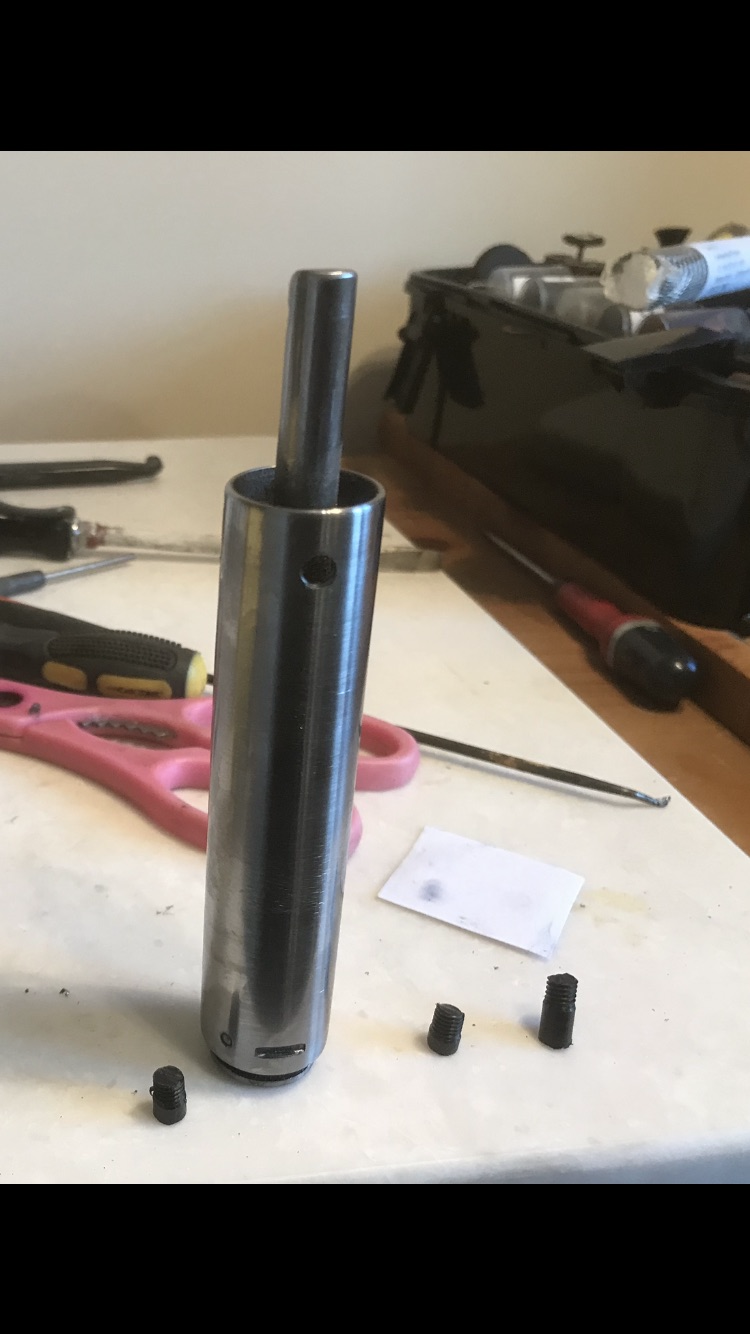

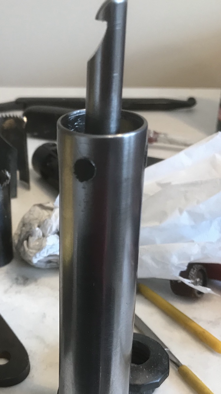

Yes I’ve seen Jim’s buttons on his web page . If you ever get an old piston try the drill and tap method its pretty easy 👍
What's the drill and tap method?
Sizes are in metric mate

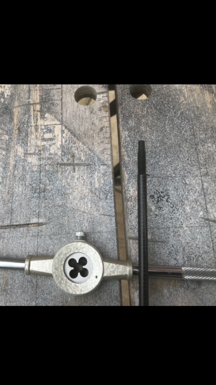

I used 6mm delrin rod . Run a m5 die down the rod to create a thread .

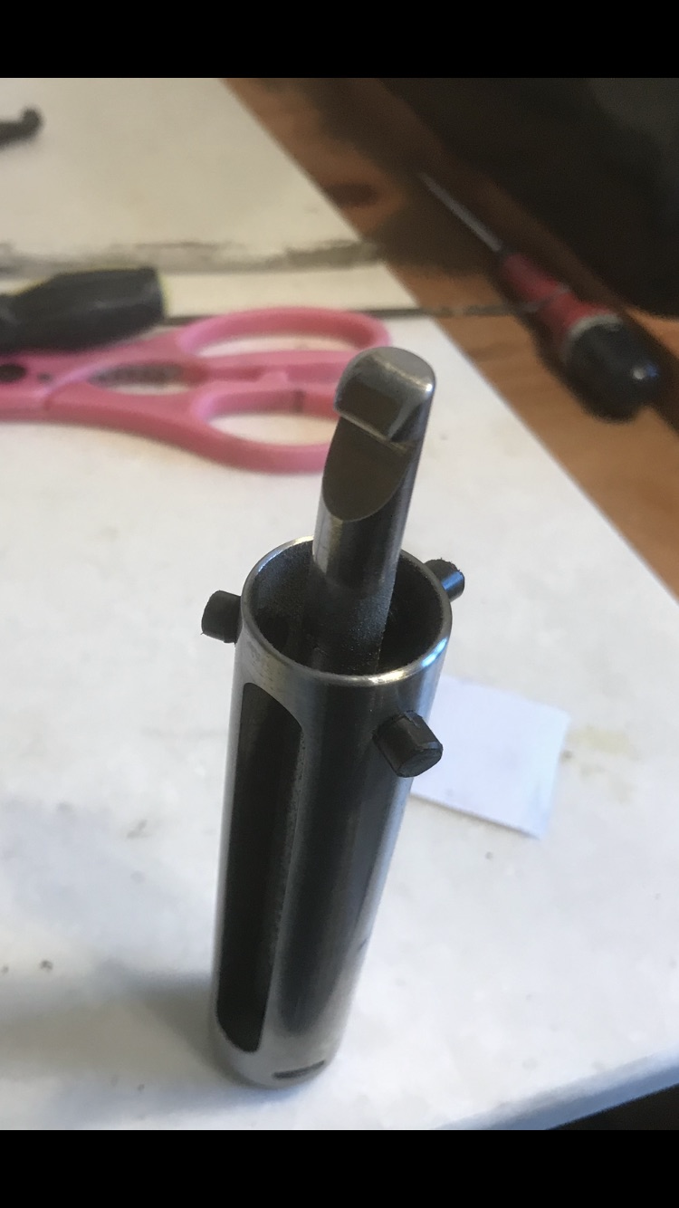

Drill 5mm holes in the skirt of piston and thread with a m6 tap . Locktite the threads and screw in .
Remove the protruding threads from inside of piston until flush.
The turn down the buttons until you have a nice sliding fit to the cylinder 👍
