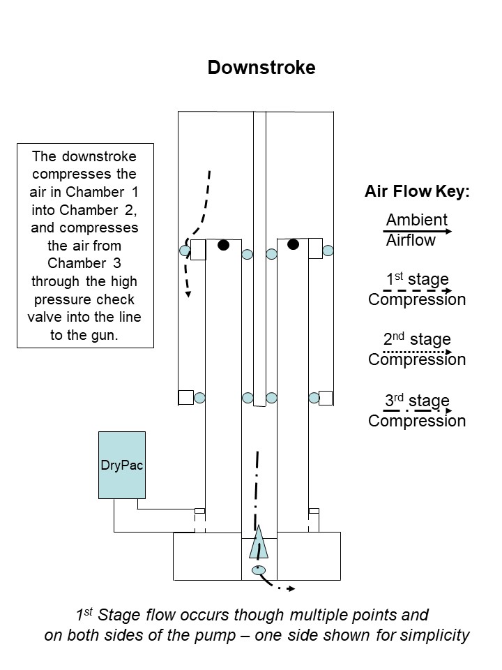

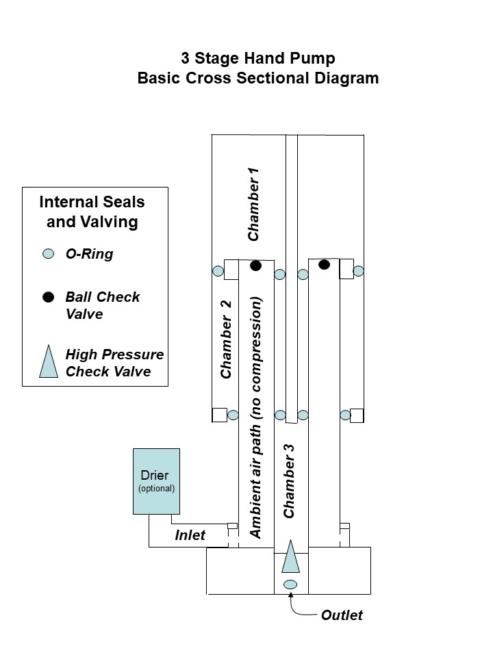

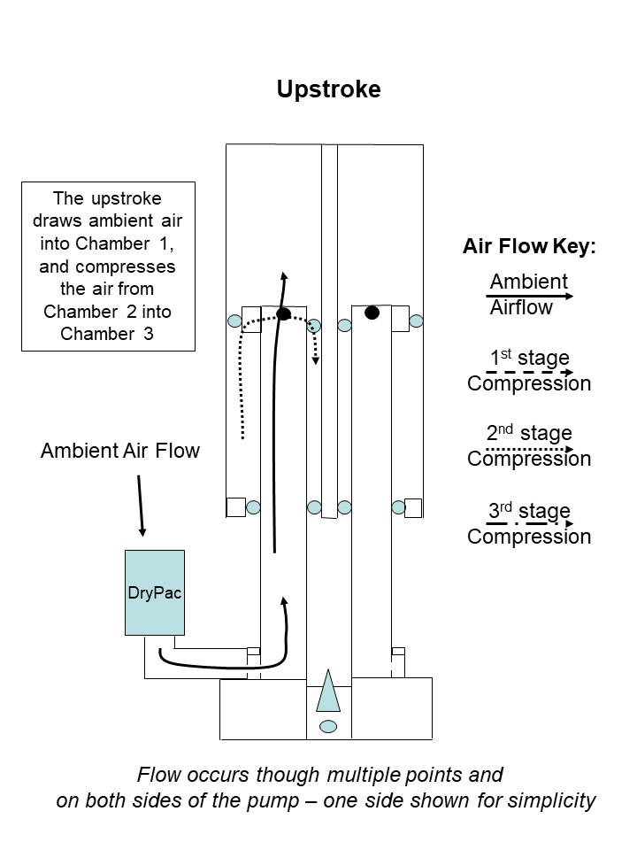

I'd be happy to do so . . . :)
I put a detailed explanation of a how a three stage hand pump works up back on the old Yellow, but sadly it is gone. So I had to dig out my old illustrations. Here is a short explanation of how it works - I figured it all out as I had to trouble shot my Hill Mk2 years ago and made some crude (not to scale) illustrations to show what is happening in the pump as it works.
Remember that these are three stage pumps, so four things have to happen - an intake, and three separate stages of compression - from just two actions of the pump (upstroke and downstroke). Logic says that two should happen on each stroke . . . and that is made possible because these pumps consist of nested tubes for the different stages.
Bottom line, the upstroke delivers the intake and the 2nd stage compression, and the downstroke delivers the first and third stage of compression. The downstroke is much more difficult (on purpose) as it is performing two stages of compression, including the harder third stage. Also, it is the nested nature of the cylinders that result in the long cool down periods required for these pumps as it is hard to get the heat out from way inside them.
I never took apart a four stage handpump, so I don't know how those work in as much detail. While this is for a Hill pump, I'm pretty sure most three stage pumps have the same general construction. Here are the illustrations - the first one shows the layout of the illustration, while the 2nd and 3rd show what happens on the strokes:
There is NO compression on the UP stroke. All of the compression happens on the down stroke. The up stroke is simply for intake of air.
This is true for hand pumps and compressors. If there was compression on the up stroke with a hand pump, it would be damned hard to lift the handle. The same is true for compressors.
What you posted did NOT prove compression on both strokes by any means. Anyone who has used a hand pump for any length of time can attest to that.

Sadly, I figured that would be your position. But what I posted is how it works.
Feel free to take one apart and show what you determine to be how the air moves through the pump.
I don't know how to "prove" it to you, and I don't really care to . . . Peace.
This could help.
That really seems like a goofy pump design to me. Assuming their animation is correct, the second stage does nothing and ultimately it just turns into a one stage pump at the end of the stroke anyway. It seems to me that you could just ditch the added weight and complexity and just make it a one stage pump from the start.
