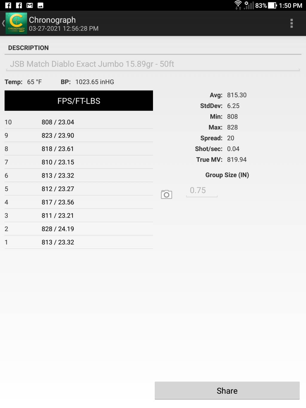

I've been doing a lot of testing in my shop at 50' on various .22 pellets, in my nitro break barrel and two PCPs, the best I've found in terms of energy, and accuracy, is the JSB Exact Jumbo 15.89gr
