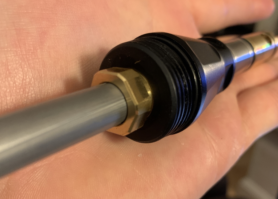

What machining would it require? Inside the breech the hole is exactly the same and the brass and stainless steel part have exactly the same dimensions on the outside -> long story short: from the breech point of view nothing has changed.

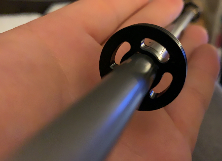

The difference now is that the steel sleeve is removed, the liner is clamped in on the breech end of the barrel and the shroud is supported by the centering pieces on multiple points on the barrel.
